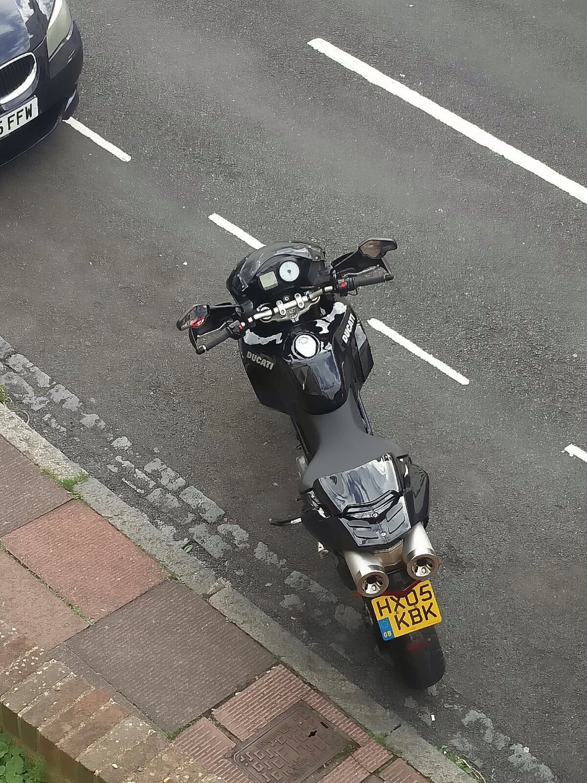

  1. An unusual view of my fuglystrada, I think it looks great from this perspective. 1000ds from above.JPG
