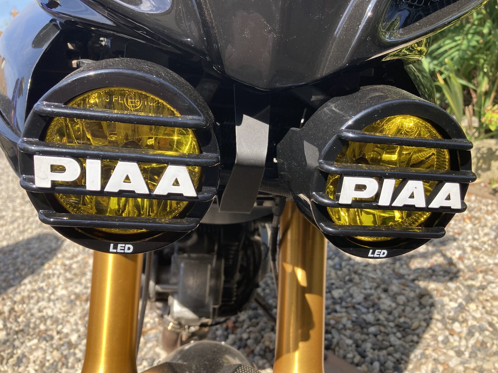

    Anyway….a trip to Spain and I brought back a Dragon MTS fairing as excess hand luggage and a set of PIAA LED spot lights where the front grill normally goes under the chin….and the transformation is starting in earnest.

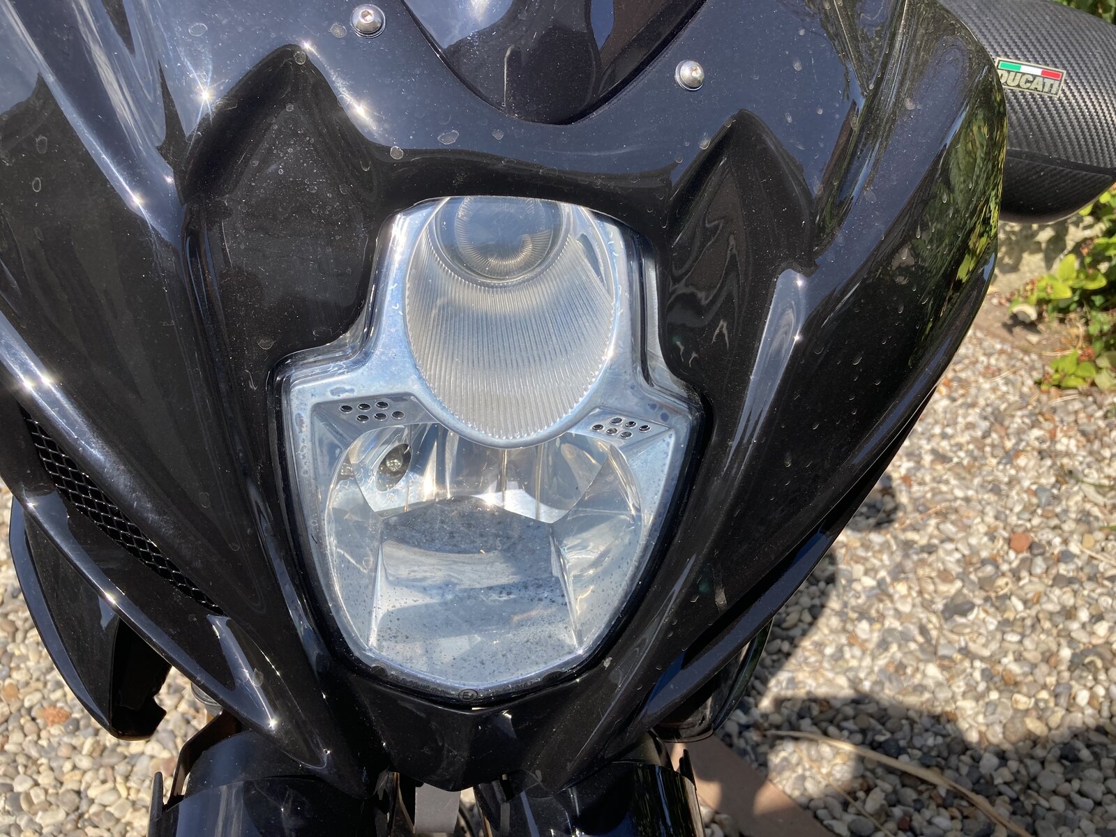

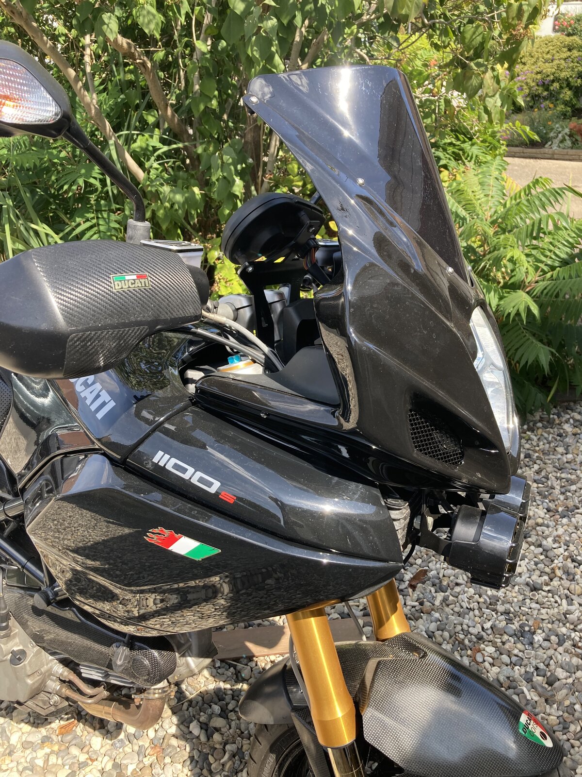

  2. Hello…..here are some images…….this is the side view of the Dragon MTS fairing.
    Not a simple bolt on…..but not Rocket science either…..a lot of fettling.
    It basically replaces the complete top section of the OEM fairing ….as in the headlight section and the quirky moving screen. I chose to loose the MTS chin and wings to allow a more open look to mount those spot lights.

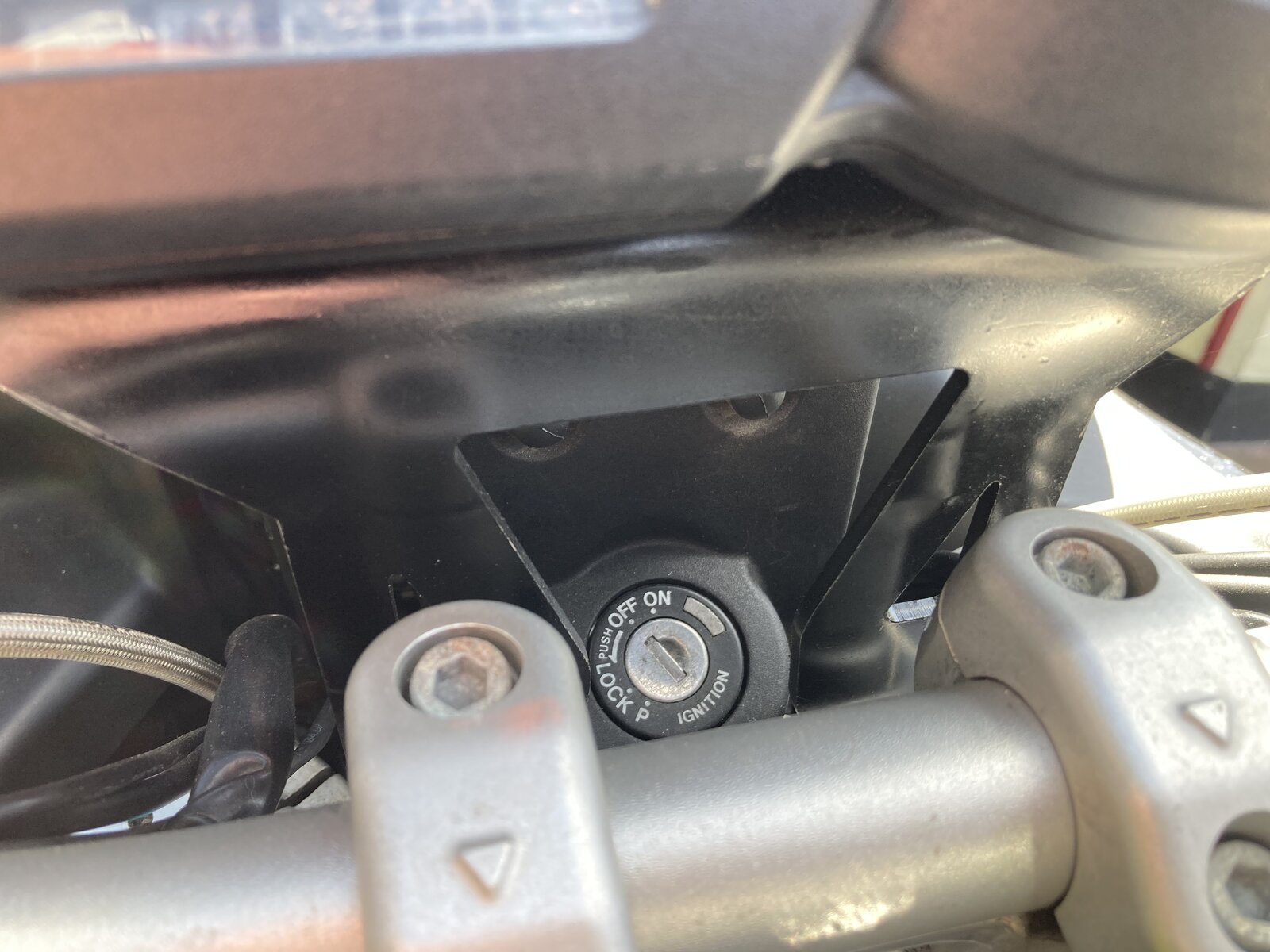

  3. Not sure if this is the correct way to do this image posting ….but…..
    The headlight hole had to generally opened up a bit in all directions….typical GRP moulding
    Yellow Spot lights to match the Ohlins Forks……a bit of a style demon….not!

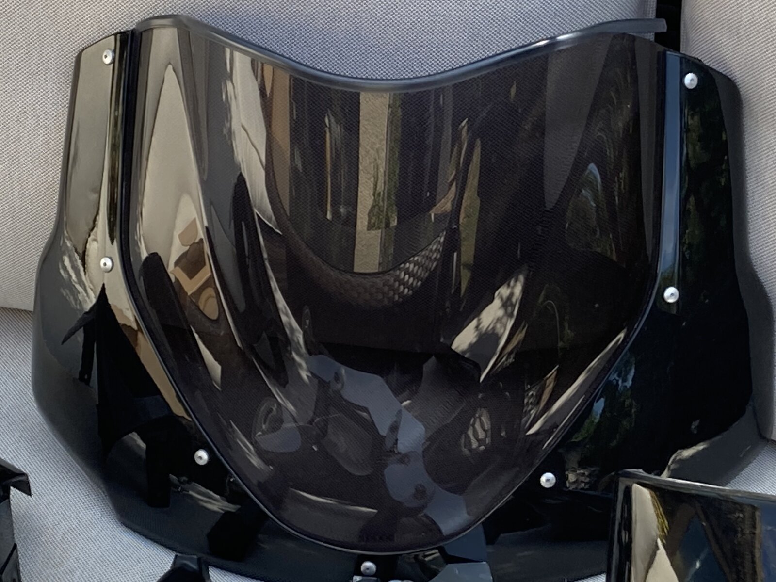

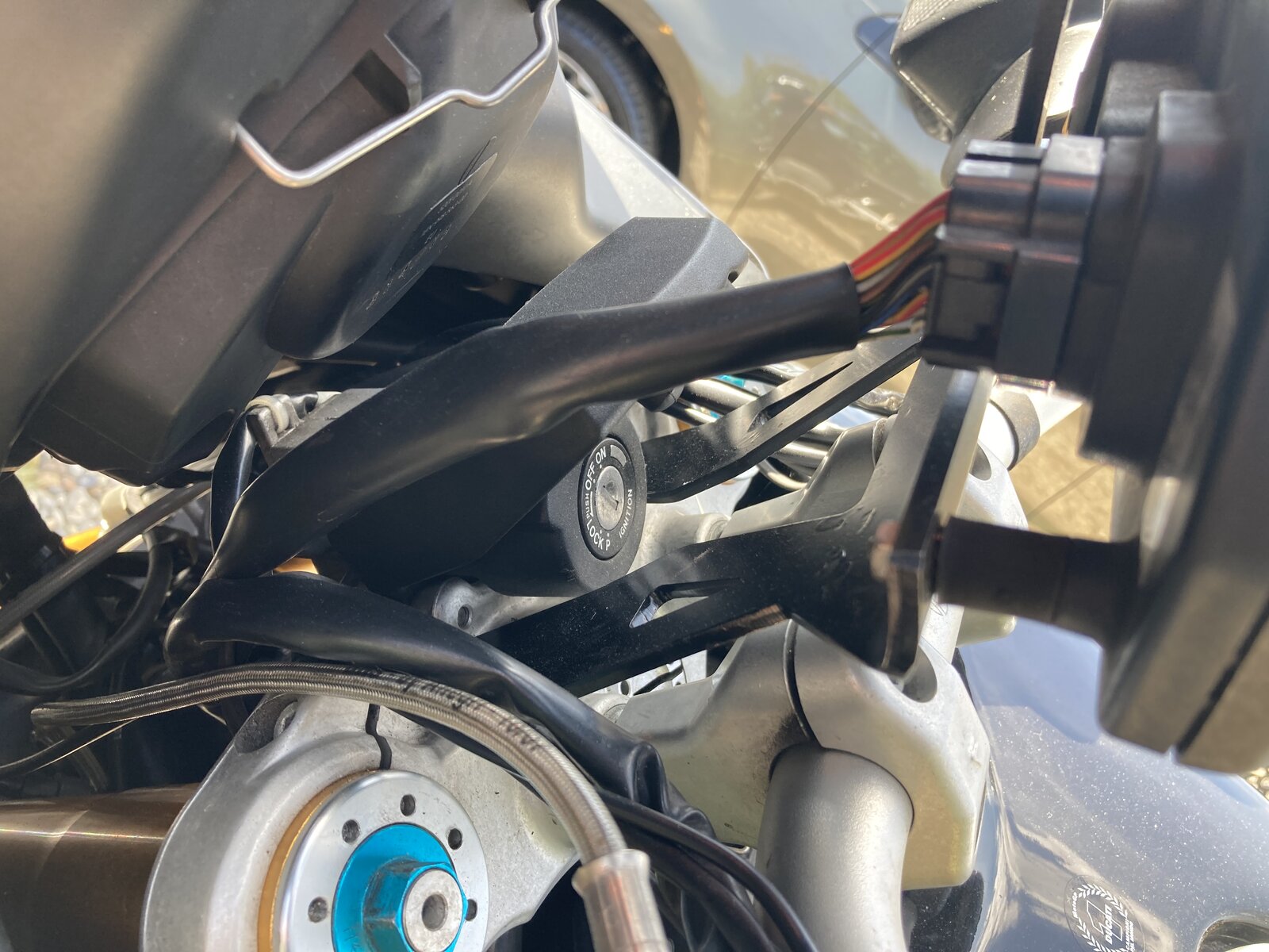

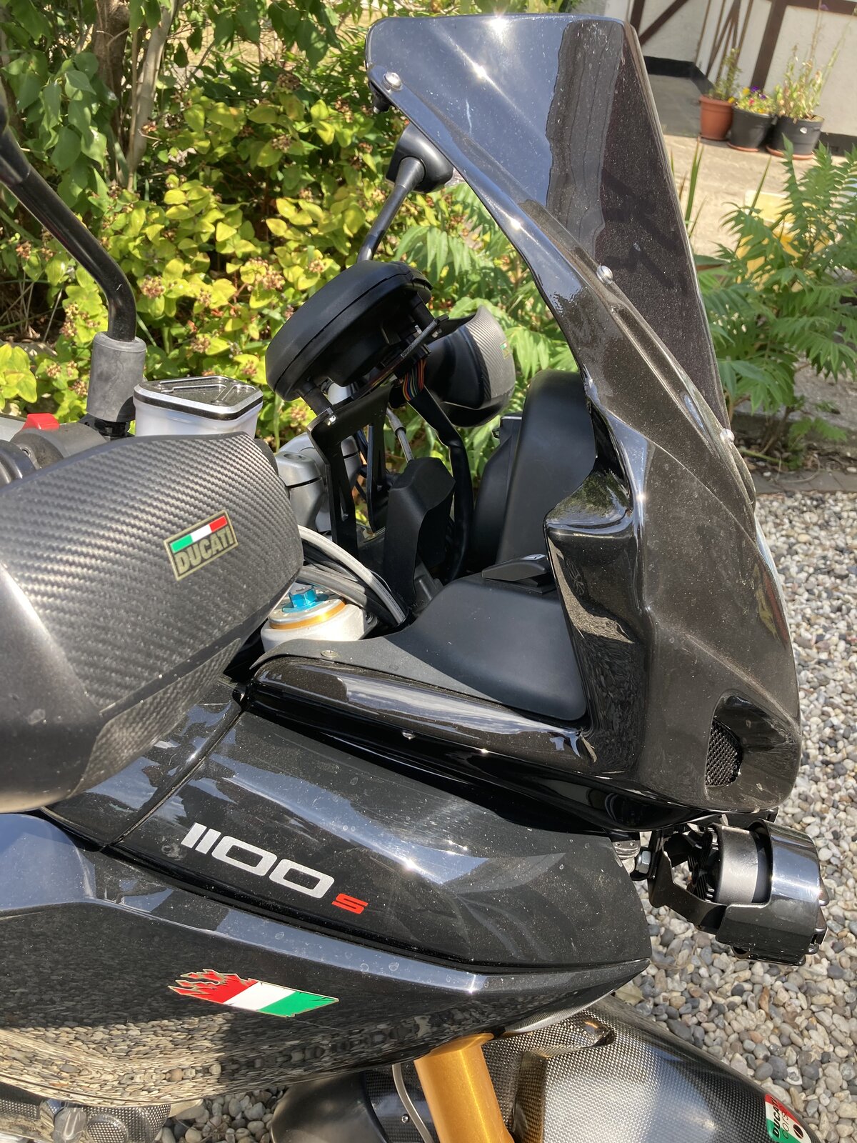

  4. The fairing no longer moves with the handlebars and the screen on the new fairing section is an OEM Suzuki GSX 750 item…..all the work ……as in fine fitting and mounting was done by Alex @ DucatiProteam…..they also arranged the colour match and painting
    The clocks had to have a new bracket to lift the clocks to a better fixed position….but this bracket comes with the kit and there is enough on the loom to allow the new positioning.
    Only other trimming was to the infill panels on the inside of the fairing.

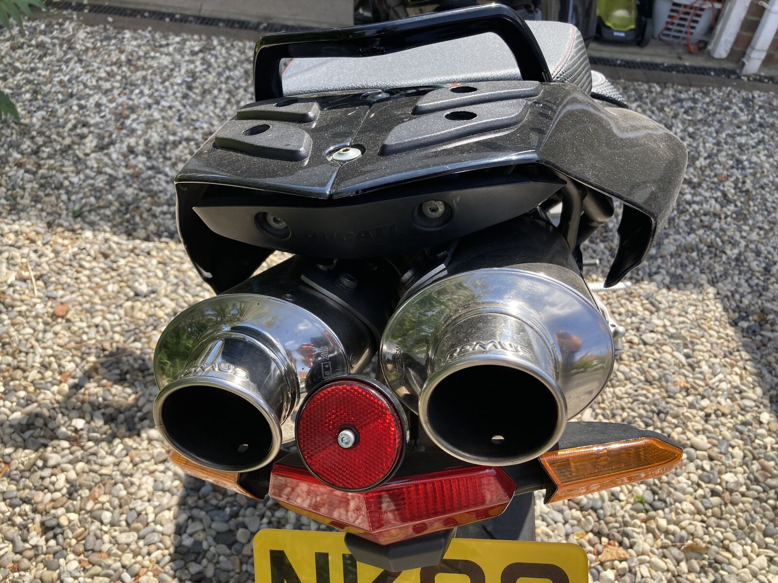

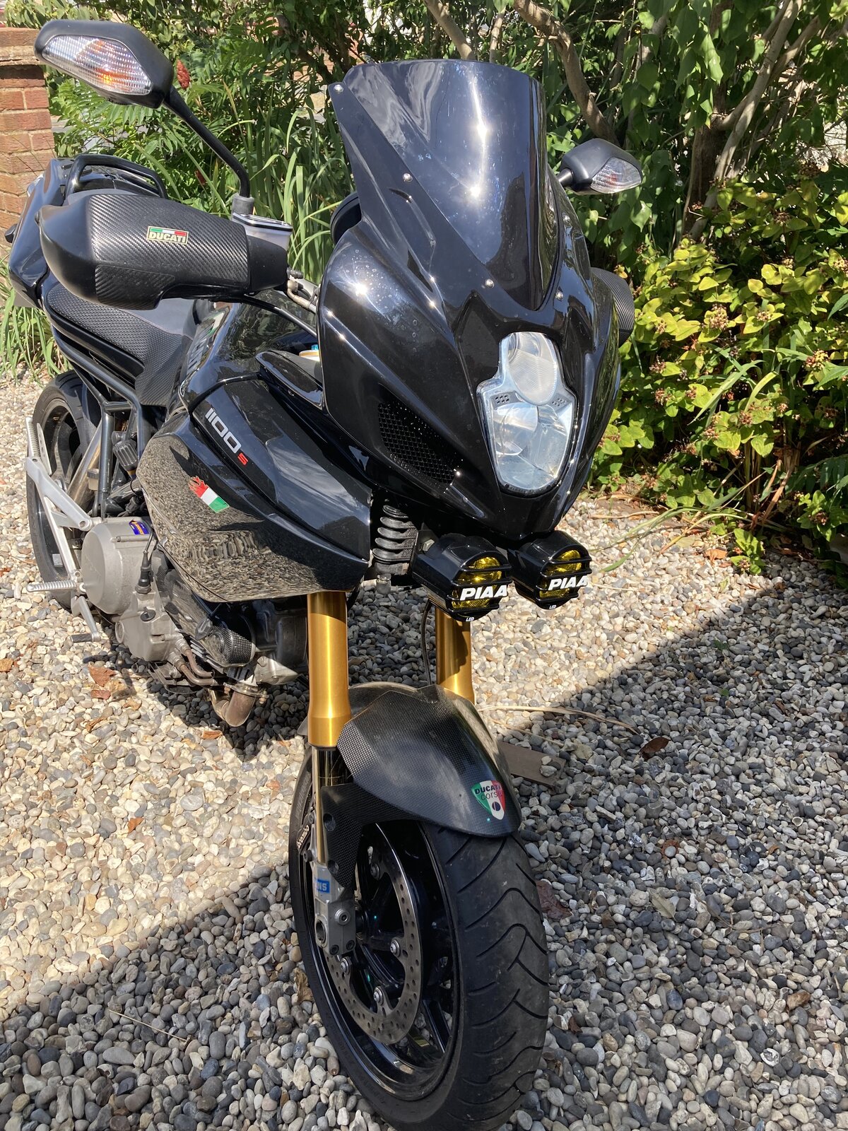

  6. So…..there you go….full ECU remap getting rid of cold start and changing the fueling for the non cat full Remus and Spark exhaust system (no collector box)
    A Dragon ESpania MTS 1000 front fairing with an American Mounting Lighting kit from Piaa and some fine fettling by DucatiProteam…..job done for now

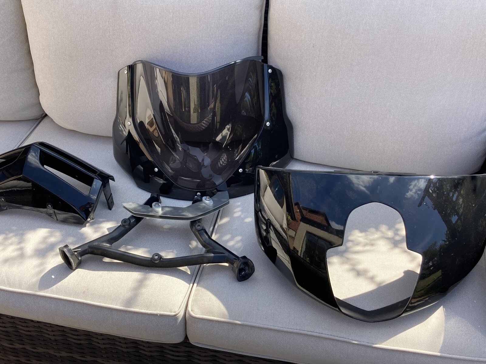

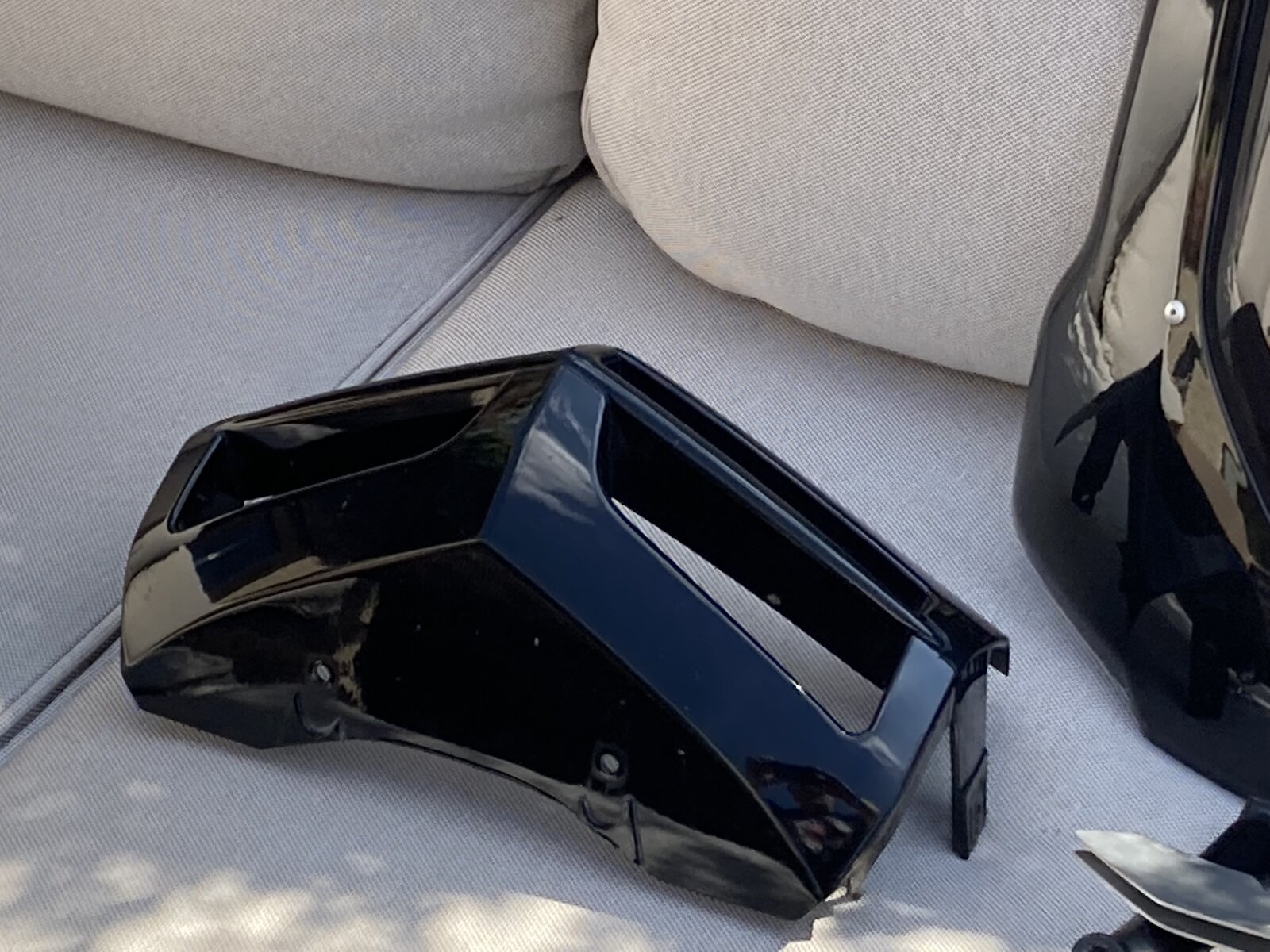

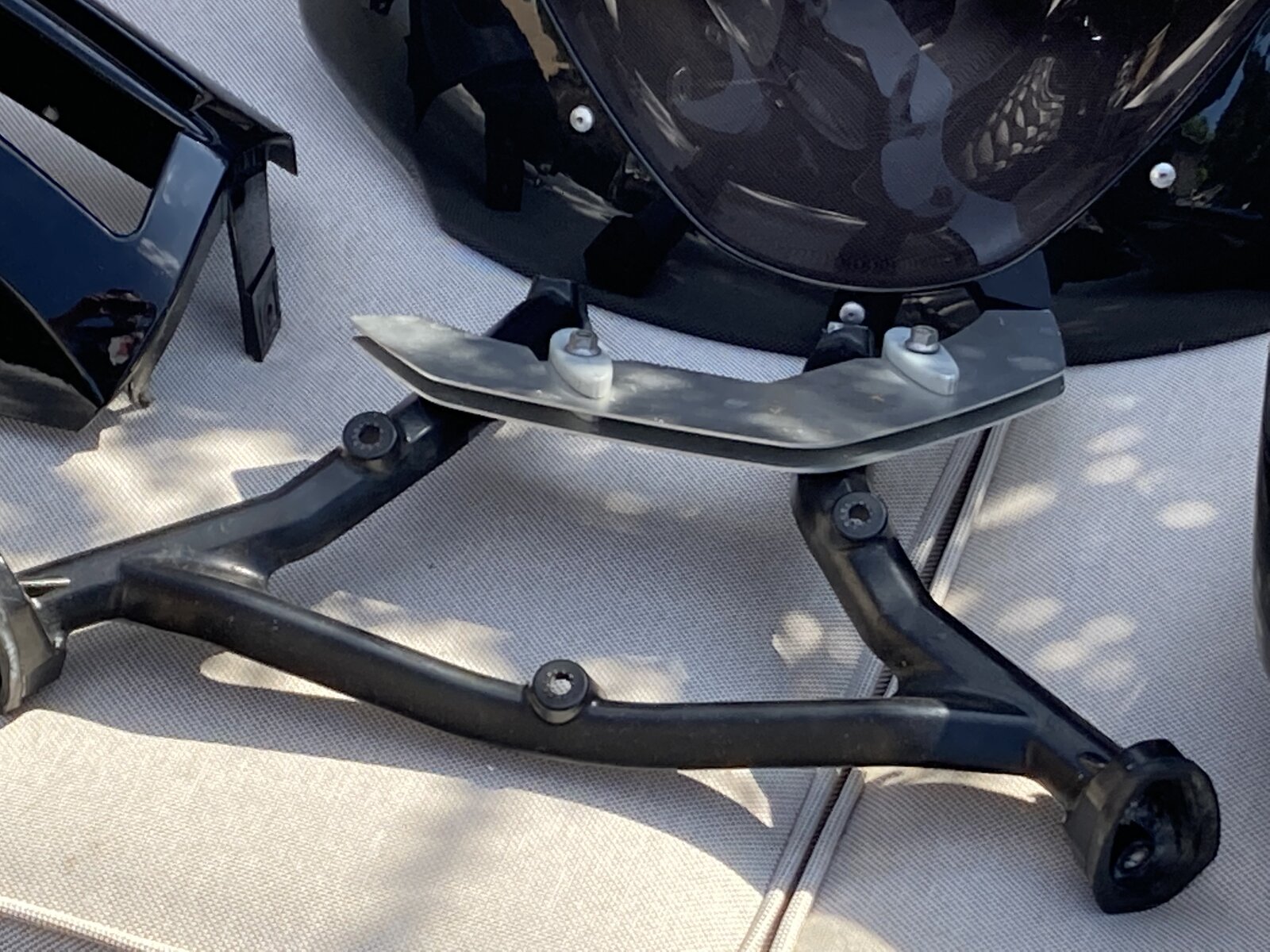

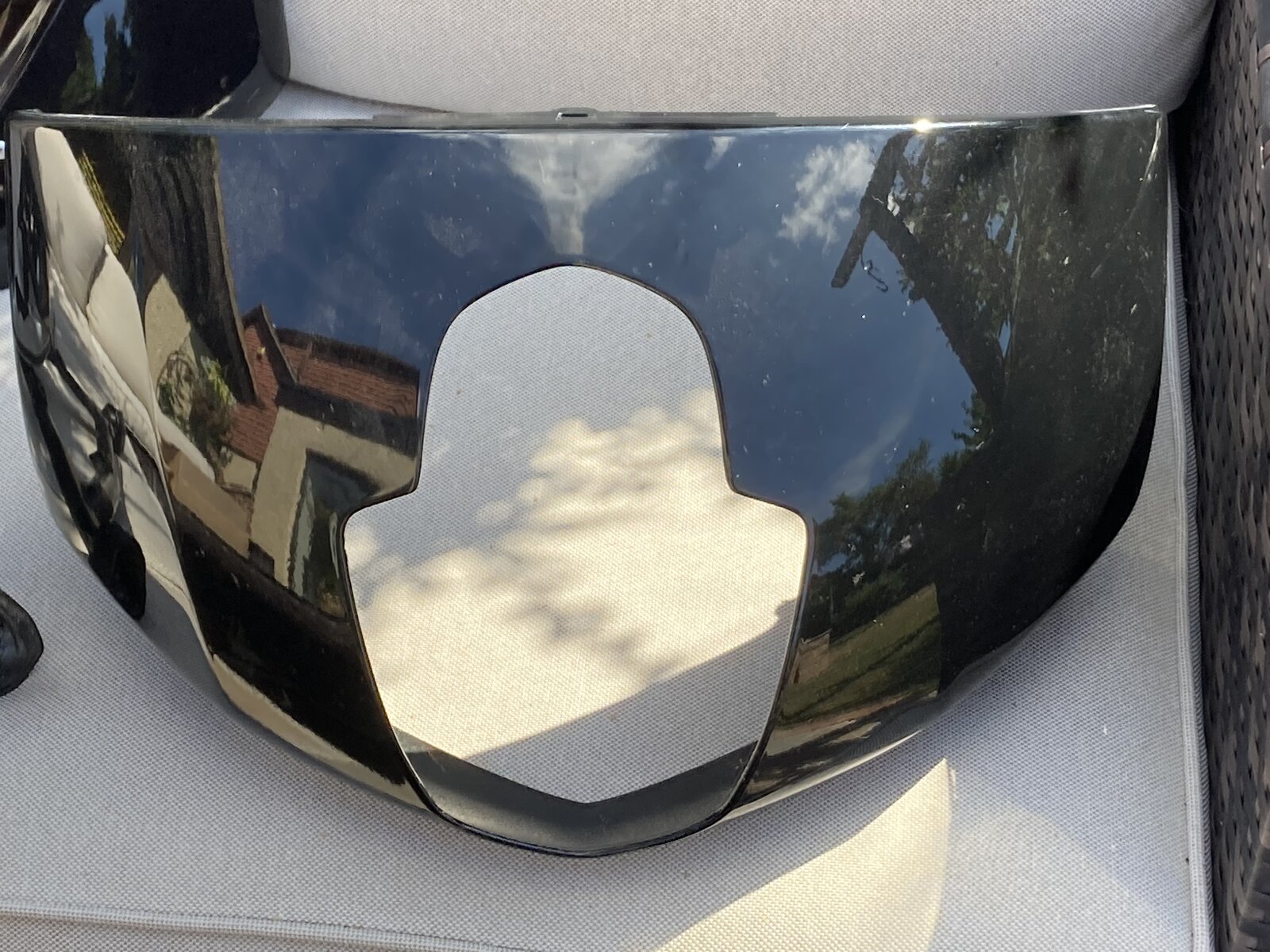

  7. 3E46B025-A565-499A-806C-0E73A1A38677.jpeg 4F763D4C-E388-4C25-9890-7487495AC268.jpeg 8ECDCAED-85C4-4EBE-8C17-09C46B6CD218.jpeg 10EAD582-95D1-4853-ADD3-A74F1B106476.jpeg 661880BB-301C-4040-86B7-41686E2906DE.jpeg 3E46B025-A565-499A-806C-0E73A1A38677.jpeg 4F763D4C-E388-4C25-9890-7487495AC268.jpeg Now….the sales pitch
    Naturally there are bits that are of no use to me….but may be to you.
    Also….I want to recoup any monies I can with out feeling used and abused
    So here are images of what is avaible….they dismantled by Alex @ DucatiProteam….so they were dismantled with sympathy……and the smell of hippy oil
    Thanks
    Gavin944888
    The Scottish Engineer
    #7 Gavin944888 Mk1, Aug 6, 2022
