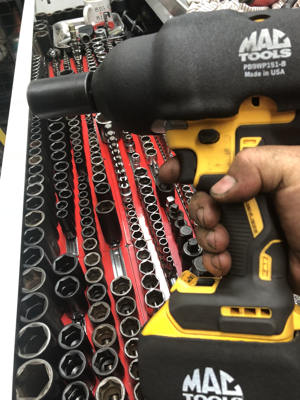

  15. 82663F3E-B89F-4418-84A5-F64FE30D5FC9.jpeg I use the dewalt every day at work. Much better than my old snap on and 1/3 of the price. £257 inc vat delivered
  16. Looks like you’re missing your 10mm :joy:

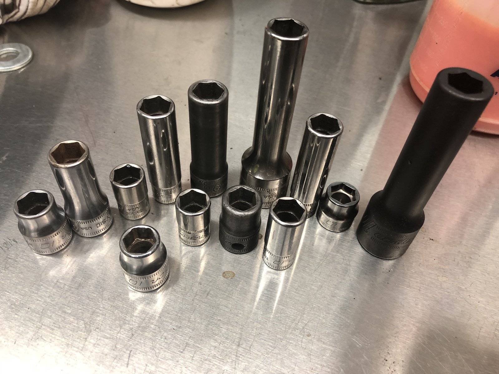

    I darent think how many 10mm sockets I’ve lost over the years.

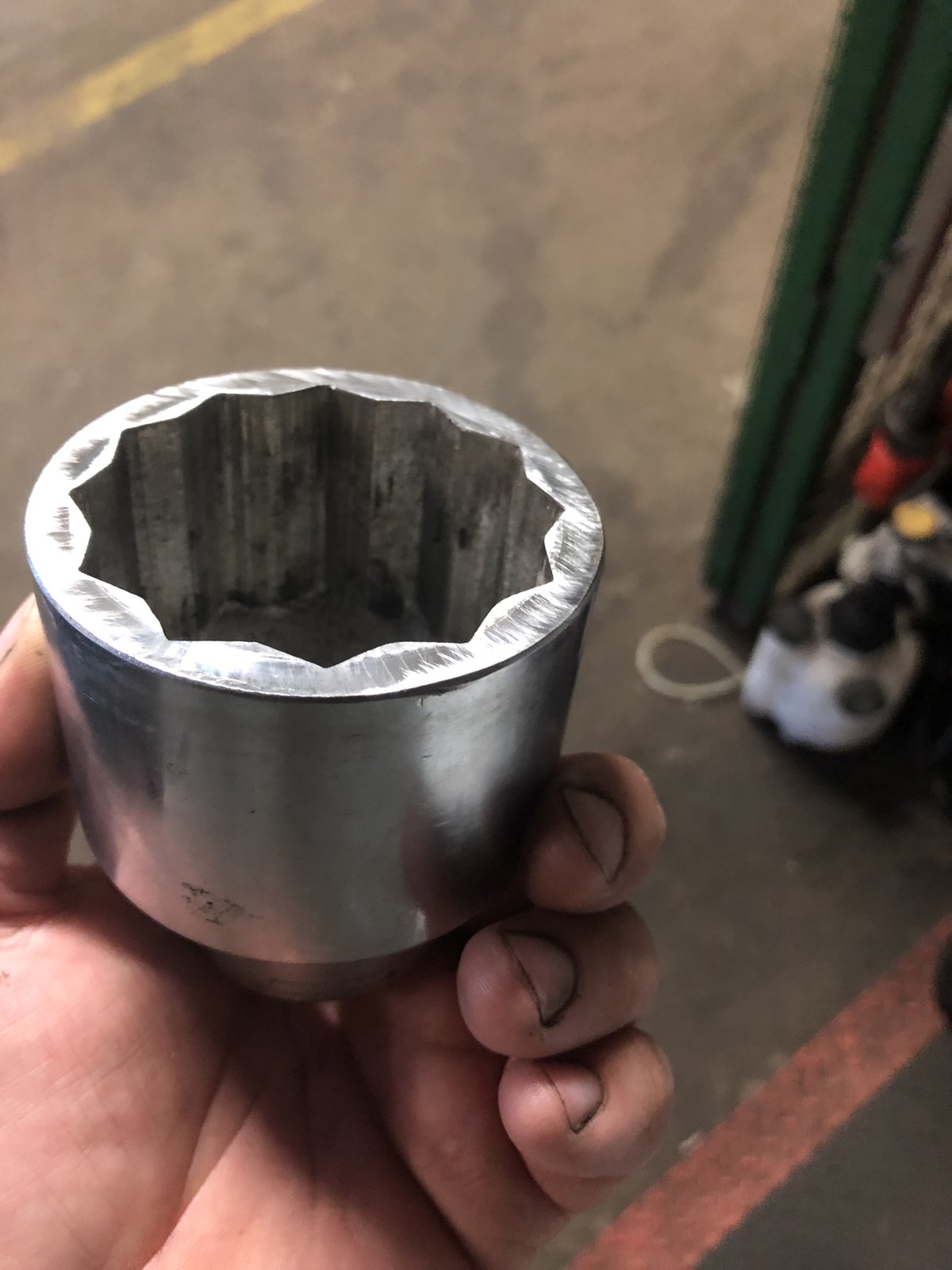

  18. 9D2DCE1E-184E-475A-9A54-5BCCB274E96C.jpeg Machined the chamfer off the inside of my socket this morning so it contacts the flats on the nut better.
