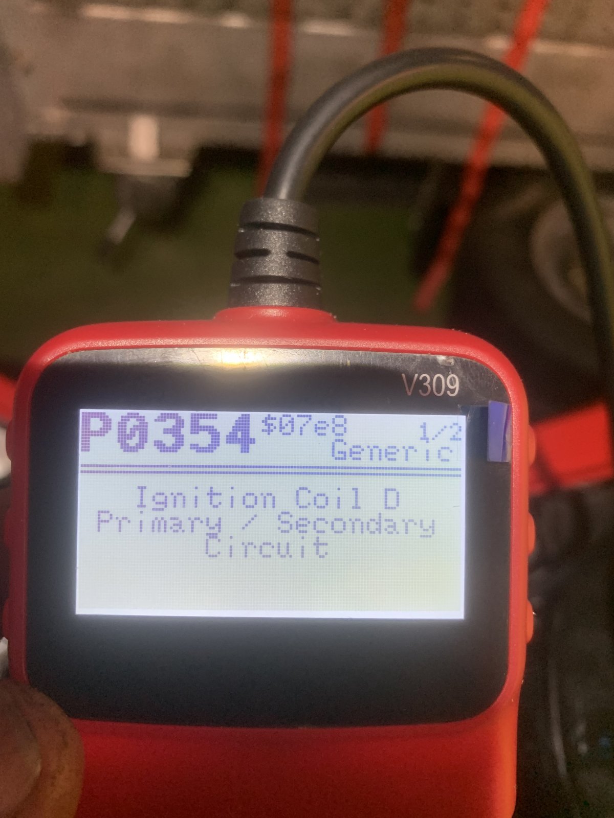

  1. Hi, any technical Bods on here that can help identify the fault code on the reader in the photo attached Please. It’s for a Multistrada 1200 DVT 2015. Any help would be much appreciated. IMG_6265.jpeg

    P0354 Ignition Coil D Primary/Secondary Circuit
    EDIT: Duh... was reading the original post on my phone and couldn't read the rest of the display that says exactly the same as the above :rolleyes:o_O

  8. P0354 Vertical cylinder secondary (not main) spark plug coil error [Open circuit], MIL yes,
    Electrical check. Open circuit of ignition coil. Check connectors. Ignition coil voltage is too low, ignition coil operating voltage is present at the engine control unit. No spark is present at the spark plug. Check and repair the wires or replace the ignition coil. or replace the engine control module. No limp home action.
