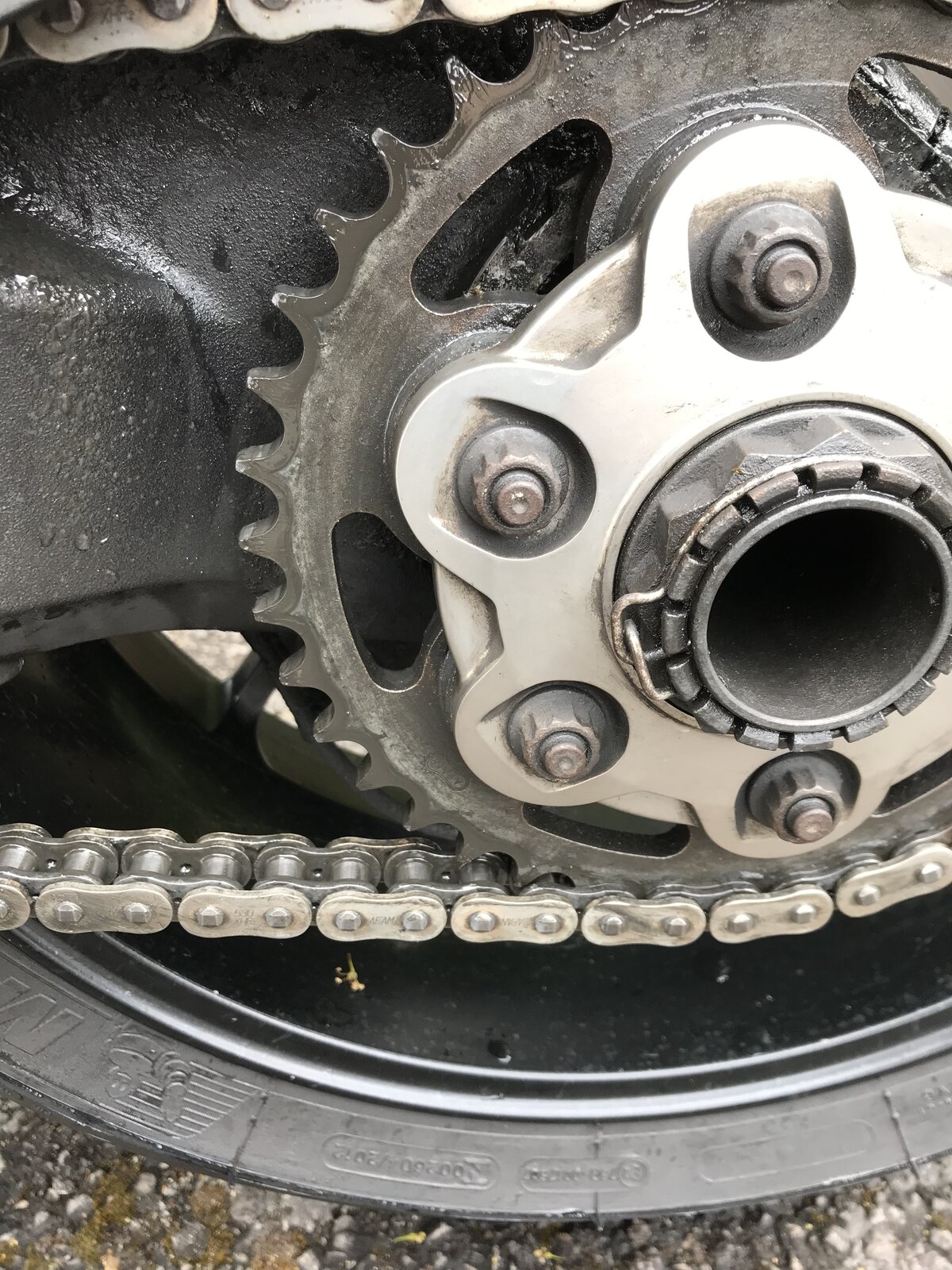

  12. In summer autumn I would say clean chain every 2500 miles, but more often if too much paste forms with the lube and road dirt etc, so 2 or 3 times a year. Otherwise do wipe the chain clean with a rag sprayed with a bit of WD40 and get the paste of the sprockets. You can see the dirt on some photos before cleaning. After a days wet riding.

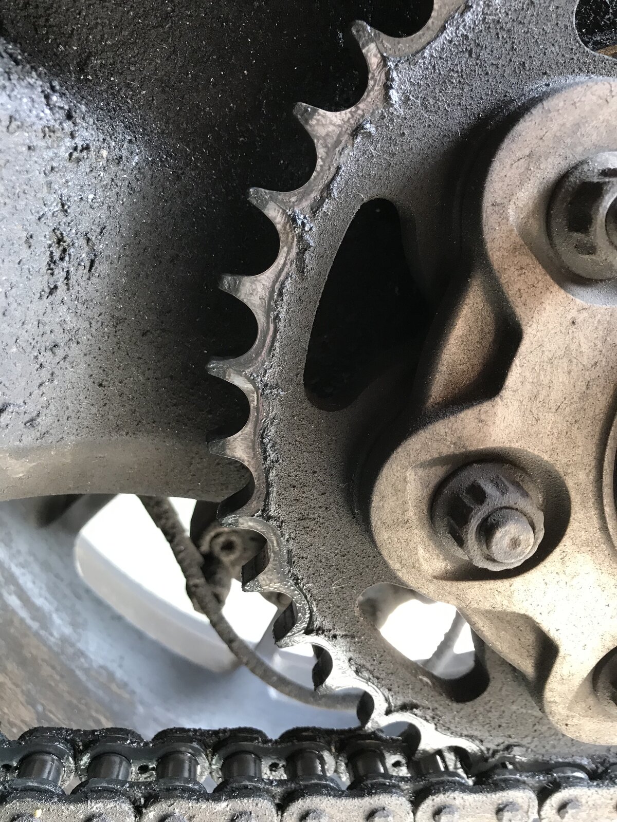

  14. Those sprockets are shot, do t fit a new chain without changing both of them.

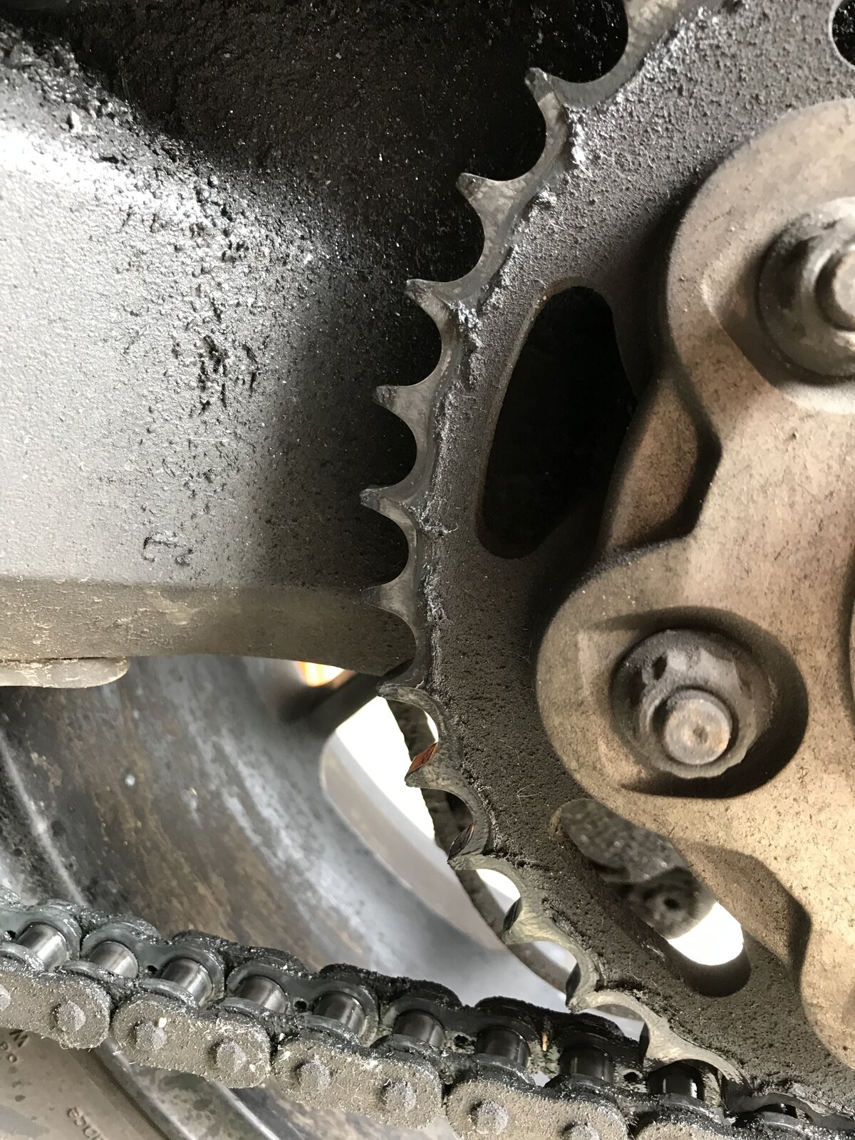

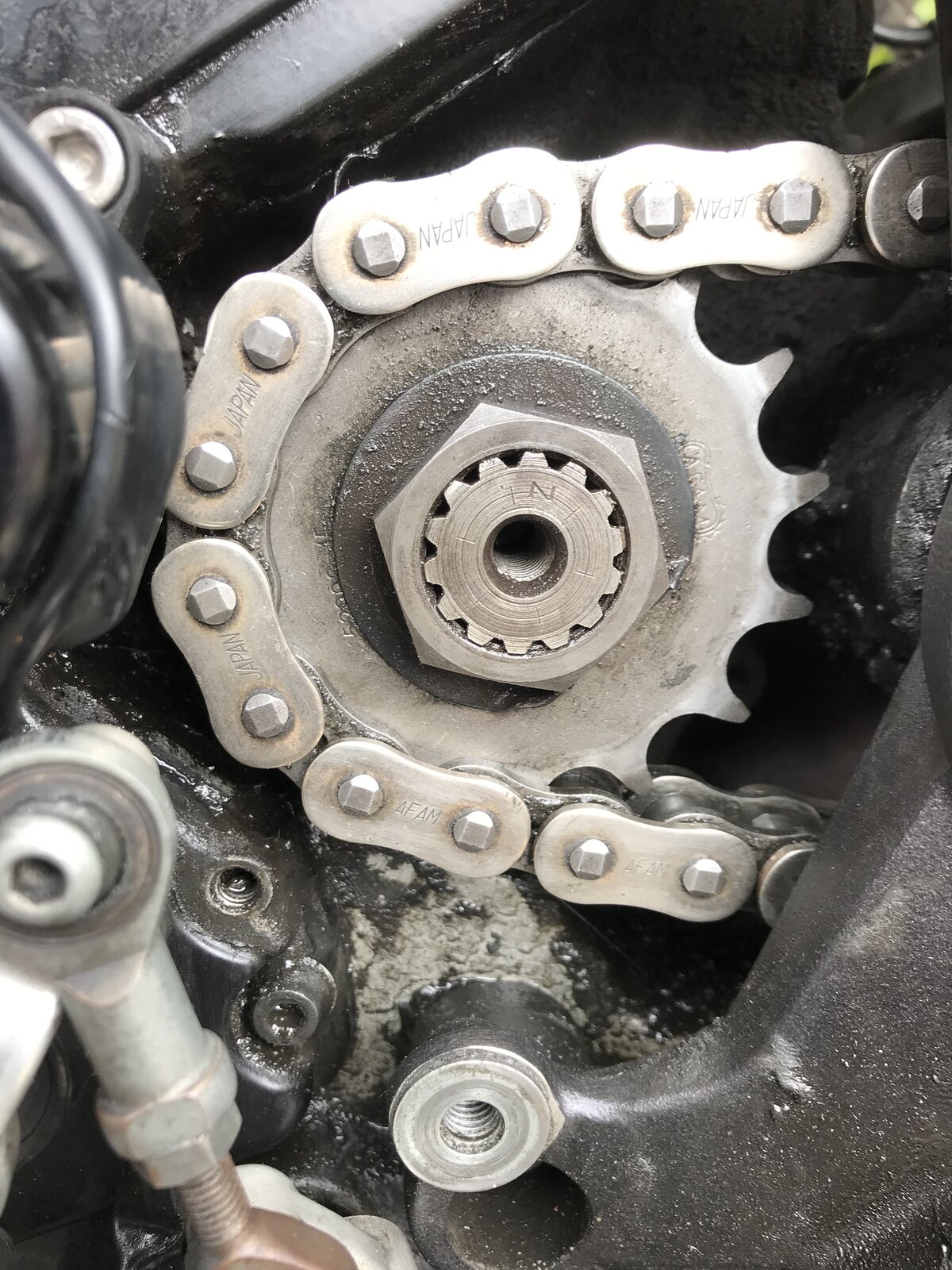

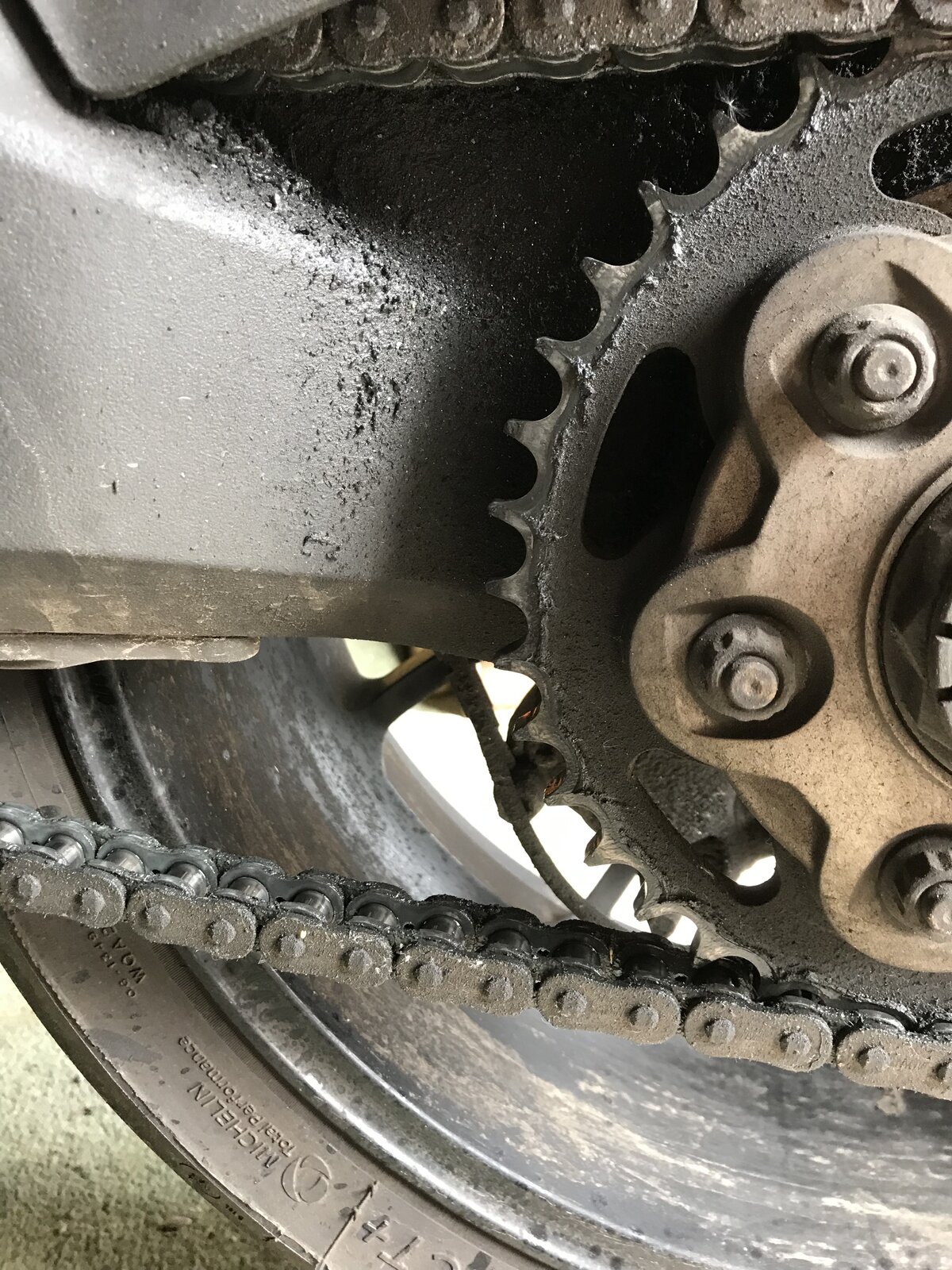

  19. The teeth are starting to show signs of wear (hooking) on the drive face.
    This will wear out a new chain quickly.
    I Have designed and fitted chain drives on equipment far bigger than motorcycle final drives.
    40 years plus in mechanical engineering, probably qualifies me to see that those sprockets are worn.
    Just place a new sprocket along side and you will see the wear clearly, especially the front one.
