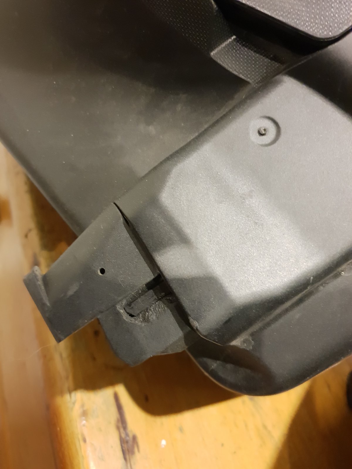

  1. Part of my pannier fixing mechanism has broken. Does anyone know if spare parts are available?[​IMG]

  6. It's the locking part of the pannier that engages with the pocket in the frame.

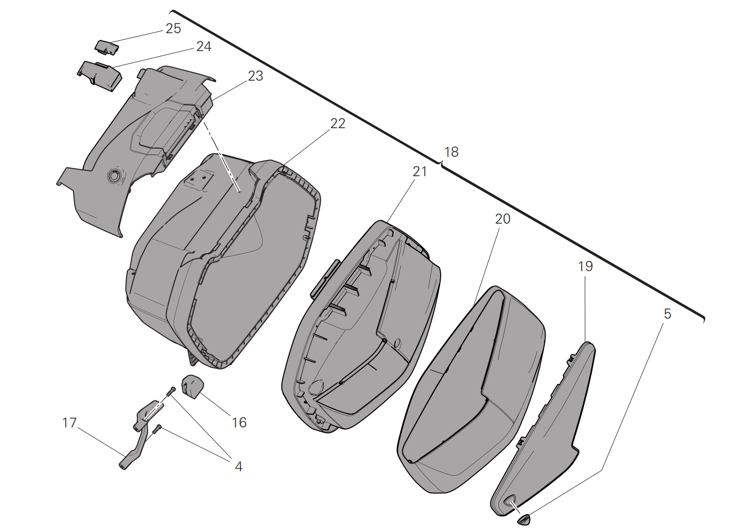

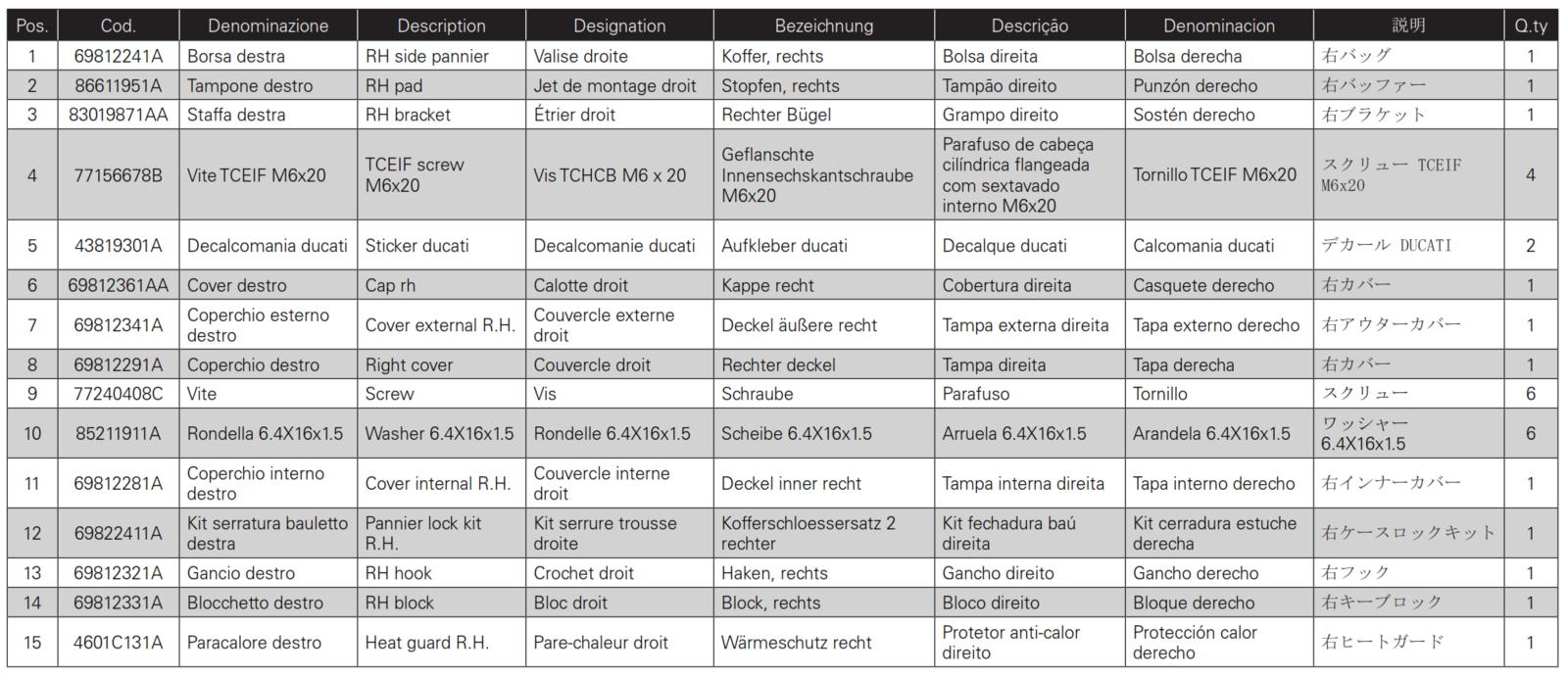

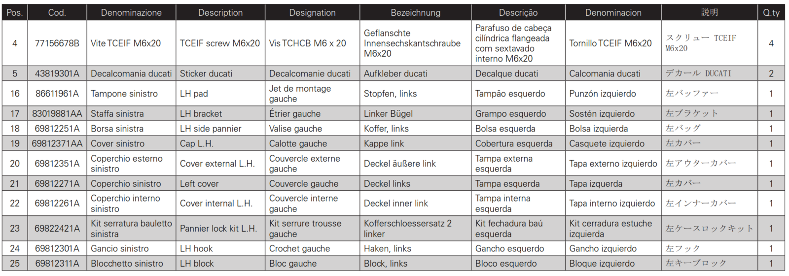

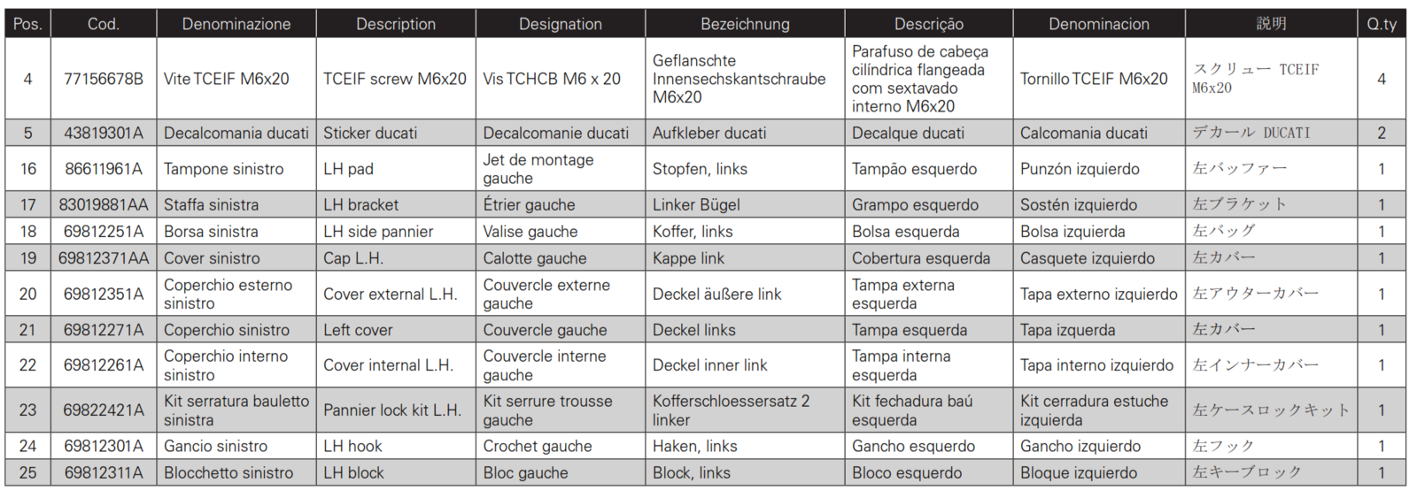

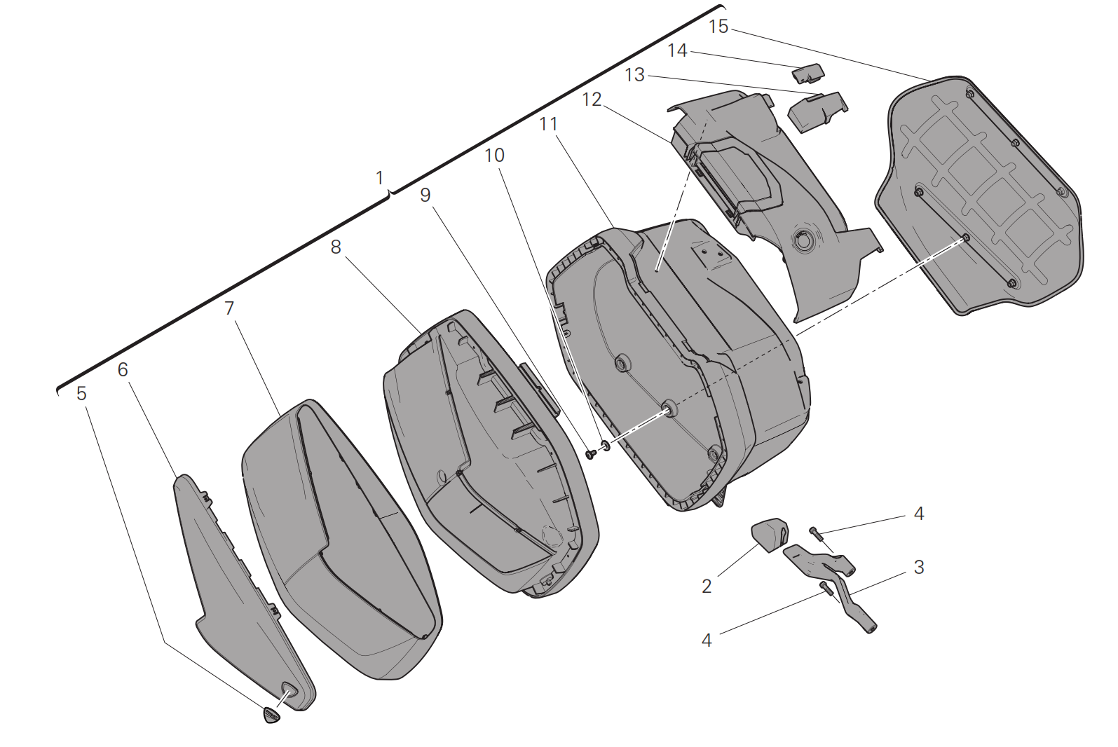

  7. Had to replace both of mine, they’re not the parts that were replaced on the recall. Be gentle when changing them the plastic arm that they’re attached to are a bit fragile, if you break them you have too buy part 23 in the diagram.
    The bit you need is about £8 part 23 is about £150
  8. Thank you,
    Thanks for taking the time , it's item 14.
