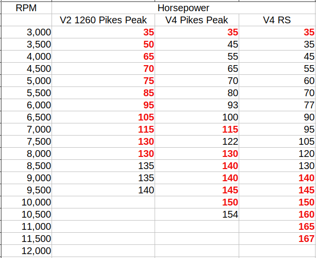

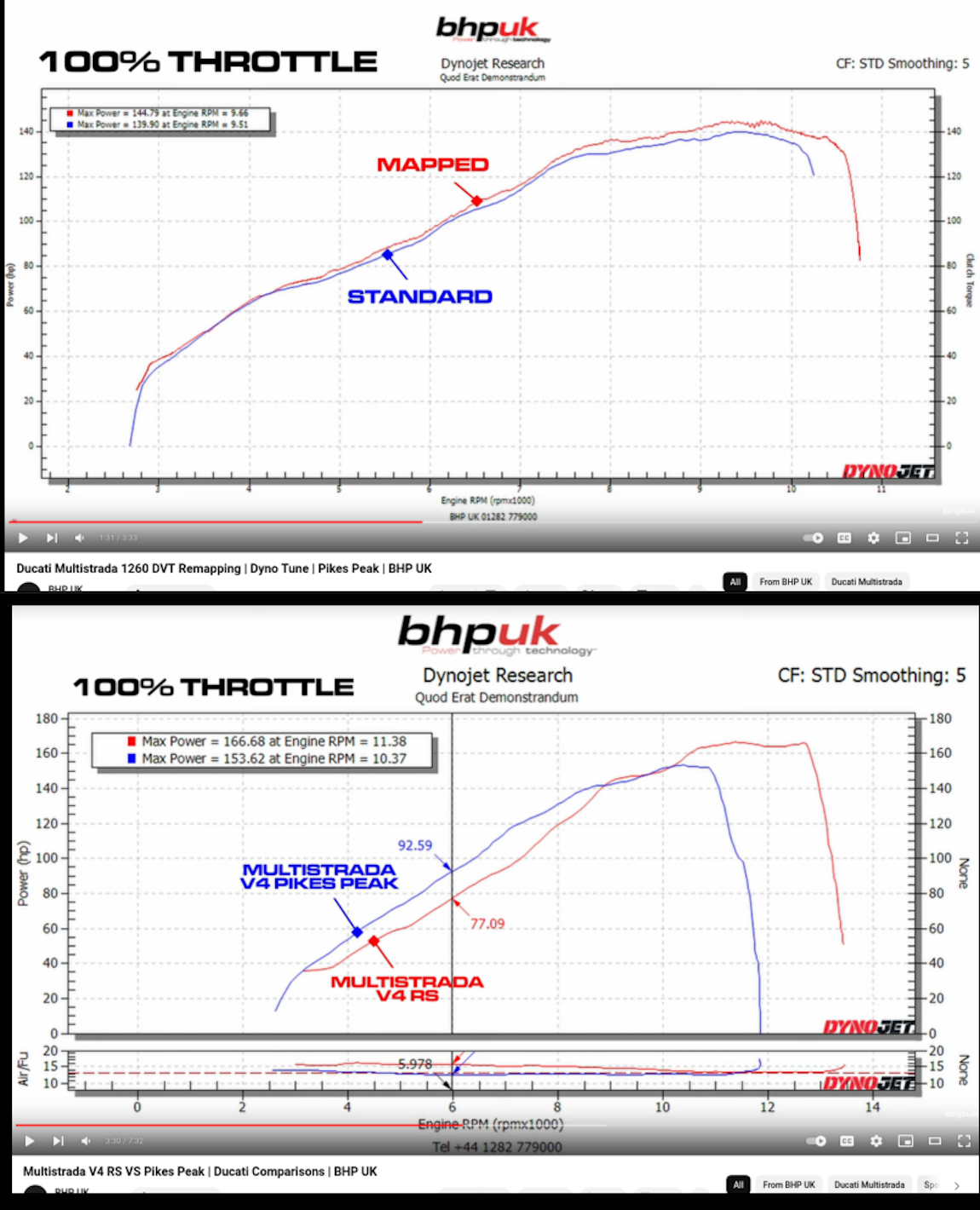

  1. Finally out of the UK, a same Dyno willy-waving comparison contest between the MTS1260 Pikes Peak, MTSV4 Pikes Peak and the MTSV4 RS.
    What's more important: girth or length?
    Who decides?
    Unfortunately, no thrust torque stamina figures.

  2. Picture quality is not very good so I can't make out actual figures but the RS and PP looks to be about what everyone expects
    • Disagree Disagree x 1
  3. Zoom in on the pictures. PP looks to be low 150s, RS about 165.
    Part throttle graphs would have been interesting.
  4. That is interesting.
    What that’s telling me is the PP develops more power until the tacho goes past 10250rpm. That’s quite an eye opener and has probably made my mind up on keeping my PP for a bit longer.
  5. The PP developing more power (and torque) than the RS below 10K is exactly as expected

  13. Yes. All three bikes are stock.
    What's also interesting is that the V2 1260 Pikes Peak makes more power than both V4's under 8,000 rpm.
    #13 DarR, Oct 3, 2024
  14. Wouldn’t that only be the case if the RS produced more power much lower in the rev range? It has to get to 9000rpm before it matches and betters the PP. That’s a long way up the Rev counter and a lot of gearing change to make up.
  15. So you're saying I should buy one?
  16. On the 1260 I tried individually 2 up at the back and 1 down at the front and both together. The latter option was too much and made the bike frantic. I stuck with 1 down at the front.
    I fully expected to be carrying out a similar mod on the V4, but the gearing feels perfect to me.
    You'd suspect the gearing on the RS makes the bike feel as fast or faster than the PP, when in reality, you're spending more time further up the rev range. Which, given the spec of the bike, is exactly where you're supposed to be.
  17. Dyno runs normally done in fourth gear, so 1k revs more in that gear for the same power.
