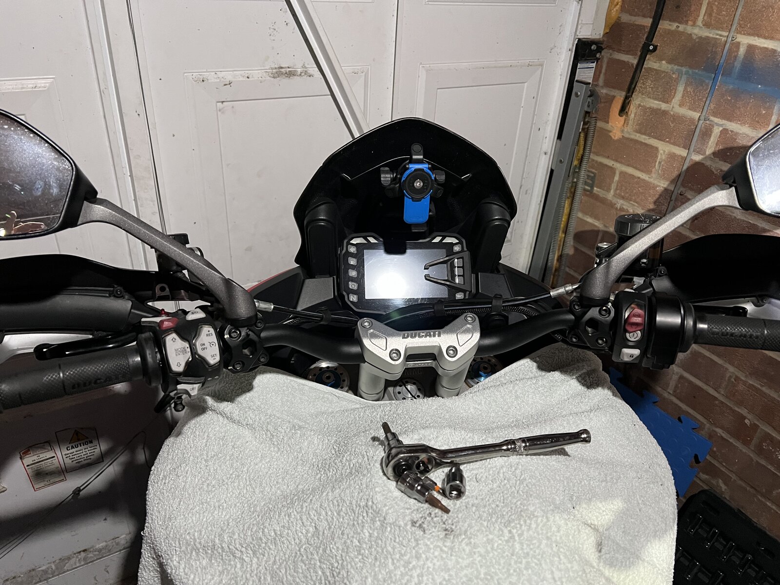

  10. Well they’re on , will give them a try in the morning .
  11. Does anyone know the standard bolt size for the clamp without the risers please
  12. M10x1.25x70
  13. Thank you
