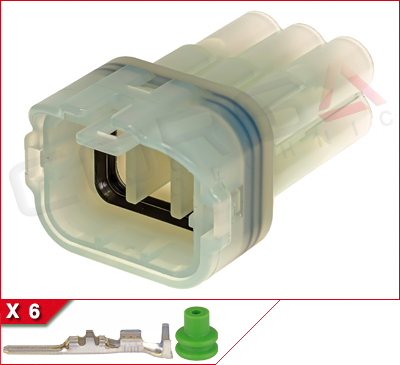

  1. Here’s a write up on the 2013 Ducati Multistrada HFCU female connector (the HFCU side of the connection.) This connector/connection is listed for the Streetfighter model also, but I can’t say for sure that is the case. I needed the connector strictly for the interior water seal, which is easily removable and replaceable, but not available separately. For those in the US, I found the customer service of Corsa Technic a pleasure to work with. I received the part in 2 days and recommend the company for automotive and motorcycle electrical needs..
    With help from the folks here, I found the Sumitomo part number for the HFCU female connector. I found the connector itself for sale on Amazon, but purchased the part from a company in Wisconsin, USA, by the name of “Corsa Technic”, as the price difference was significant. I only needed the interior seal, not the pins and seals. Corsa Technic kept them and discounted the $3.29 connector to approximately $2.50.
    HFCU Female sealed Sumitomo connector info:
    Mfr:OEM Sumitomo
    Series: MT Sealed Series
    OEM P/N: 6189-6171
    Mating Part: Wiring harness side: Sumitomo P/N: 6180-6181

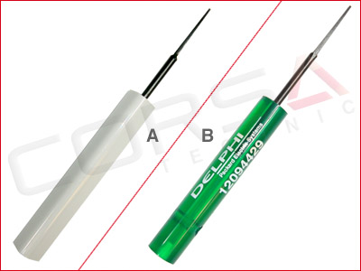

    If you need to remove pins on the female side of the connector, for whatever reason, the removal tool is: Aptiv 12094429 . At Corsa Technic the cost of the generic tool is about $7. I saw the Aptiv version online for as much as $28, so be aware.
    Tool specs:
    Tapers down to a .035" blade for release of many terminals, including Delphi/Aptiv:
    • GT 150
    • GT 280
    • 150 Metri-Pack
    • 280 Metri-Pack
    • 280 Tangless & 280 Bus Bar
    • 630 Pull-To-Seat
    • 800 Metri-Pack Female
    2 Versions available:
    A - Generic, with same pick design as Delphi version
    B - Aptiv version, P/N: 12094429. Same as pictured, but says APTIV instead of Delphi.
