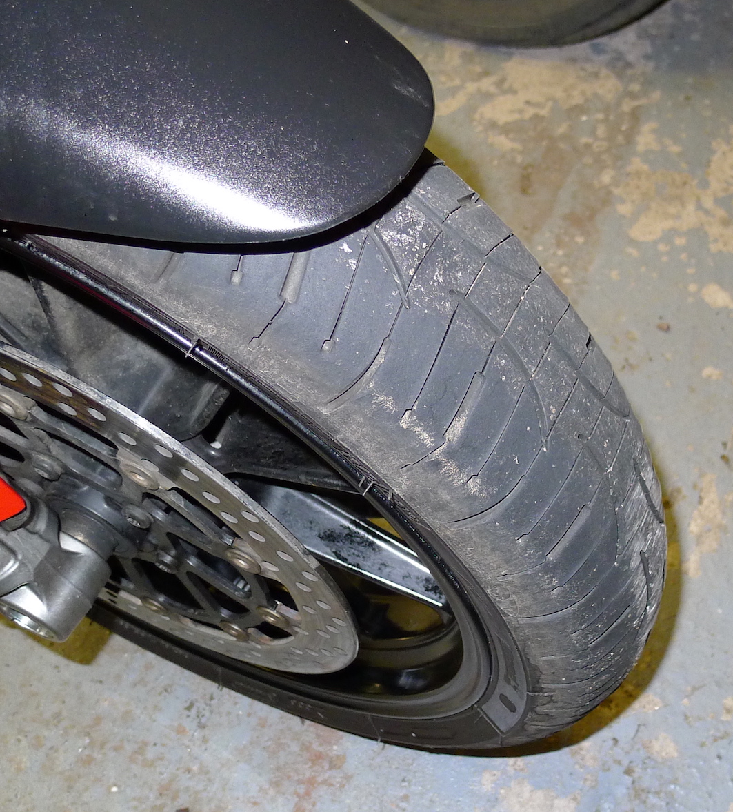

    Does that look like a screwed front tyre ? It has 5300 miles on it.

  8. Until I switched to PR3/4 on the Multi, I'd been on various flavours of Diablo for 15 years - whilst I still love the progressive and linear turn-in of the Pirellis, I find that they're slow to warm up in cold conditions, ultimate wet confidence is lower than the Michelins and Highland roads wear then out in 1100 miles.
  9. it would pass a test. but for a pleasurable ride. its screwed. i know the feeling your talking about. normally noticeable at the beginning of the season if i dont replace the front at the end of the previous. you probably just got used to it over the season
  10. Loads left in that yet.
  11. It is something I became aware of at the end of the last season.
    What aspect of that tyre makes you say it is screwed ?
  12. That's what I thought, but it is cupped / feathered / scalloped or whatever you want to call it with wear on the leading edge of the blocks.
  13. take a measurements across the width of the tyre and your riding slower at this time of year which magnifies the effect.
    my old fugly does after the tyres about two thirds worn. really drags the bars round on what should be tight fastish bends.
  14. that was on power pure tyres after about 2-3000mls.
    horrible feeling.
  15. My front is worse than that, cupped and feathered edges of the tread blocks on the sides. I am determined to get some more use out of the rear tyre though then put a pair of Metzelers on... I have heard that dyno tuning can be rough on the rear tyre so I will wait until CJS have had their way with it, if they answer the Email.

  16. I think I will get the early season over then put on a pair of Pirelli Angel GTs for the summer.
  17. One last question. In what way does the load rating physically affect the construction of the tyre. Angel GTs are available in 58 and 75 load ratings, 58 is more than sufficient loading wise but what are the trade offs ?

  19. at a guess ones heavier for some reason or another which will effect flickabilty but would you notice?
  20. Mine went the same, just where the dot like thing is ttowards the edge of the tread
