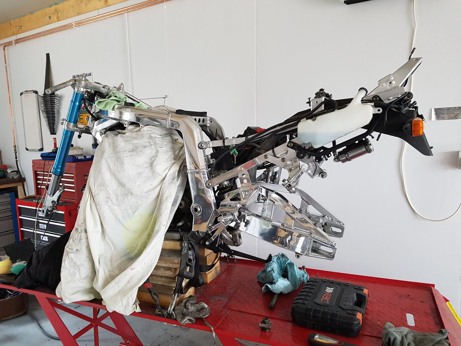

  6. I bought a 1994 gsxr 750. Stripped it. Ran it to check engine stood 19years in a garage. 6800 miles. Ran fine after carb rebuild. Polished frame . Bought all paint for new scheme. That was a year ago. Still strapped on stand. So many projects.
  7. 20170821_154920.jpg pic of the project. I'm surprised after a year it's still shiny. Keep posting those pics looks really good .
