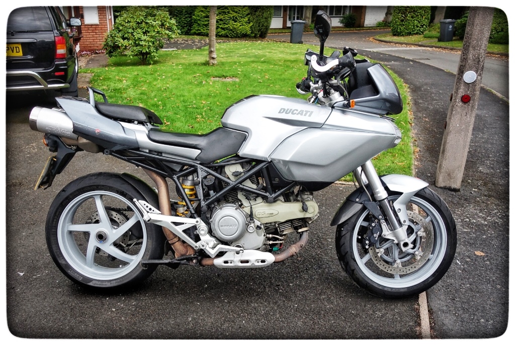

  3. Been out and had a good run of around 50 miles today, took a few pictures... The bike runs REALLY well, nice and smooth pick up, and revs to the red line cleanly, I am pleased with the result. I would say its down on power over the injected bike, but not much, and its enough for me!
    A couple of things I need to change... the mirrors are crap in that position, and also the throttle is too slow, I need a faster action, and will be on the lookout for one next week.

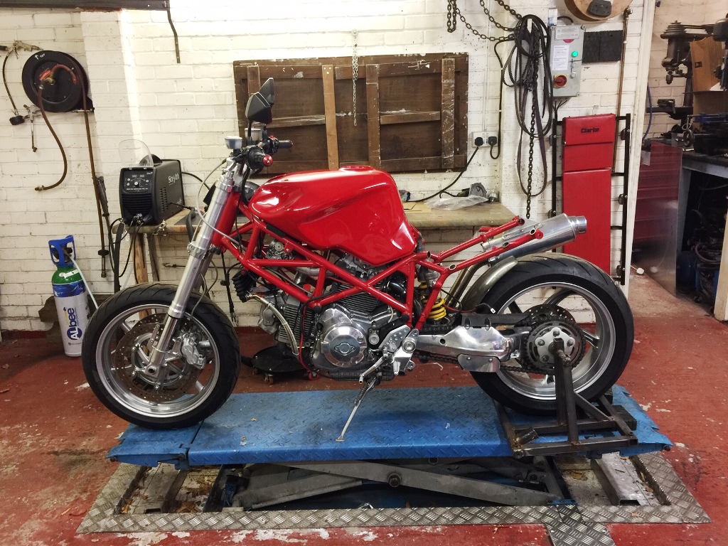

    Not long before the new build starts...
