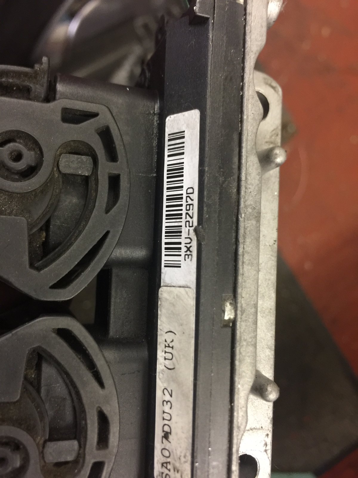

  3. 78125598-5CF7-4CCB-B8FD-67A316DFDEE9.jpeg 78125598-5CF7-4CCB-B8FD-67A316DFDEE9.jpeg Thanks for the reply Nelly. This is all new to me, and a steep learning curve. Doing a bit of reading it looks like i need some software and some cables? If this is the case can you give me a link to where to get the softwware from and the cables on Ebay?
    Its a 2003 bike and the ECU looks like this.

  5. You need JPdiag downloadable from here and you will need this kit of cables. That should allow you to do a TPS reset among other things.
