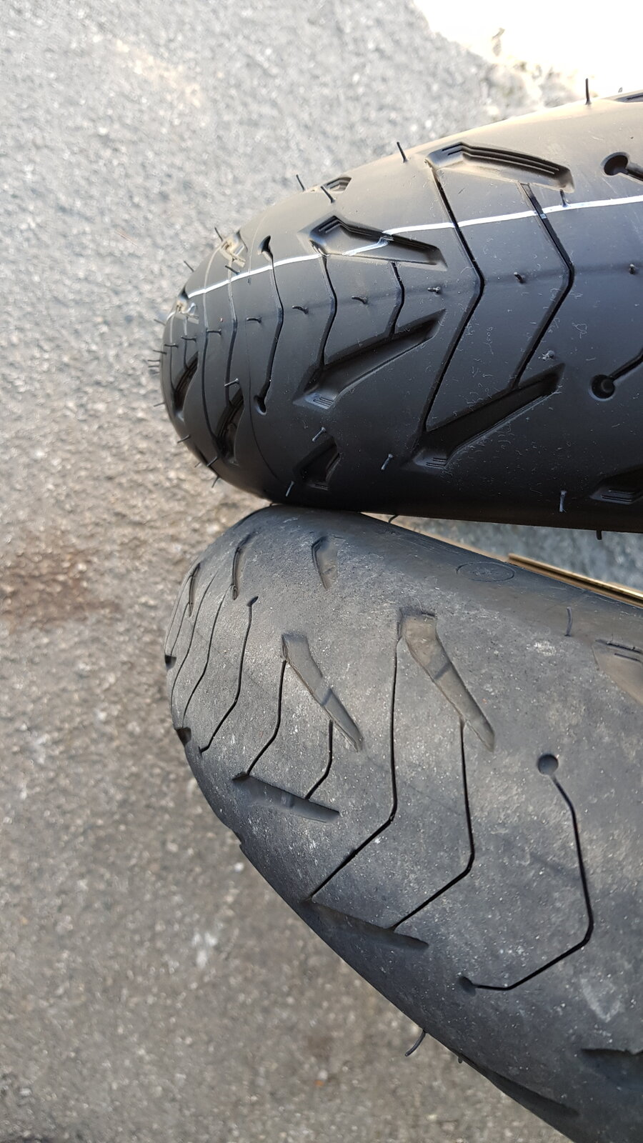

  1. I had road 5's on for 5500 miles. Bike started to do its silly dance so had the rear changed for same. It had plenty of tread left but was squared off. Rode bike & it was not much better. The front even though tons of tread left, had gone weird as in the centre was flattened off & the sides looked very mis shaped. Anyway new front & all's good again. As said by someone above & my daughter from bike tyres Leeds, Michelin said these road 5's were going to be high mileage tyres. Not so it seems. Speaking to my daughter the other night & she was saying the 01's are getting brilliant reviews for good grip.
  2. Picture to show front road 5 at 5500 miles at side of a new one.
  3. Mine wears like that too. Big improvement over the 4's, which scalloped.
  4. Wow, never seen a squared off front Road 5 like that, rear yes but not the front. Have you been doing a lot of stoppies?
    IME Road 5's don't last any longer than the PR4's but when near end of life they still grip really well (normally!) when with the PR4's as they got EOL they would let go or would tramline badly.
  5. I usually slow using gears always getting told off by mates behind with 4 pots & not much engine braking. Anyway all good now. May look at something else when these are done. The original scorpion 2 front was not badly worn when I went to road 5s
