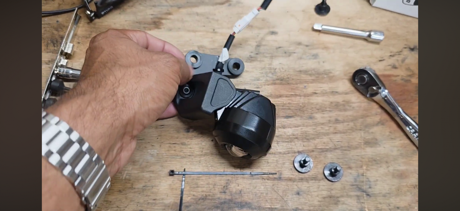

  1. Hi guys. Just got second hand original Ducati aux lights / fog lights, but the bolts to mount them to the bike were missing.
    I’ve made do with cap head stainless bolts and stainless penny washers but would prefer to use the original low profile domed black bolts, like the side panel or screen bolts - but with a shoulder.
    Any idea where to find them or of a similar bolt on the bike I can buy from the Ducati parts shop online?
    They look like these fairing bolts but shouldered

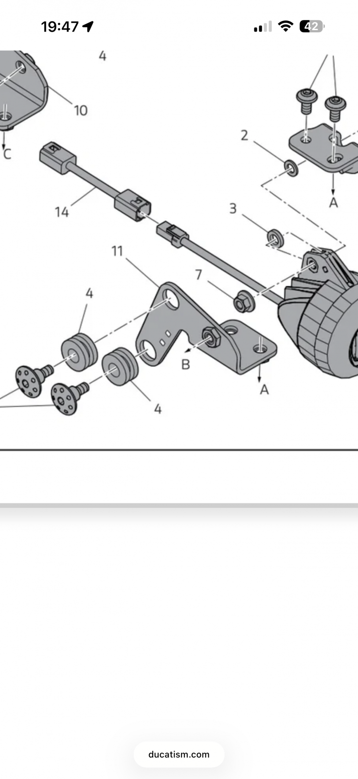

    See bottom left, assembly instructions
    You can see them just about here
  2. I found them after a brainwave - on the Grand Tour version’s parts diagrams!
    Part number 97612281AA.
    At £11 each I will use original fairing bolts without the shoulder, or stainless Allen head domed bolts, with a metal insert in the bush.
