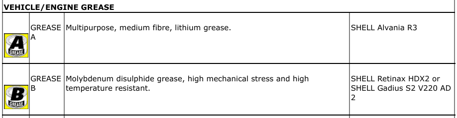

  7. For future reference - charts from 2022-23 Ducati MTS V4 PP SM:
    Hope this helps.
