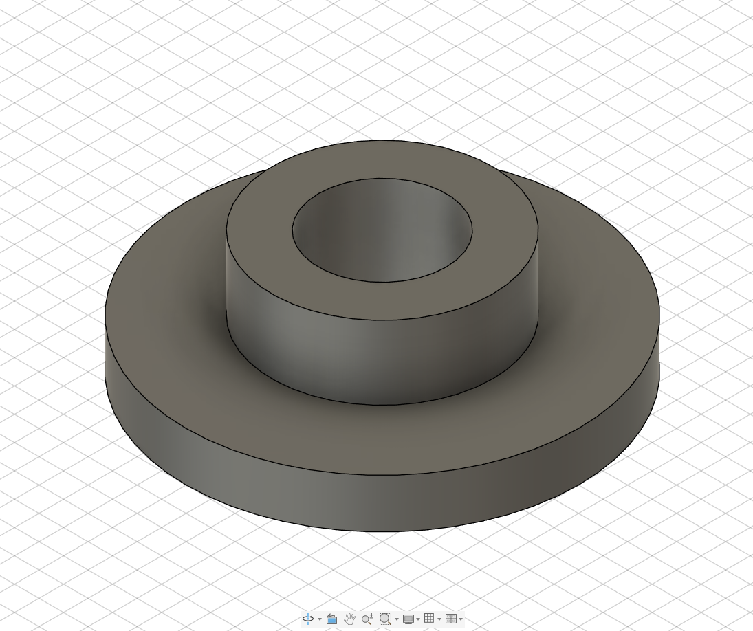

    I came up with an idea of using a M5x16 grub screw, M5 half nut and a plastic Top hat spacer
    quick measure up of the slot in the bodywork, and thickness with the trusty verniers, fired up Fusion 360, and came up with this

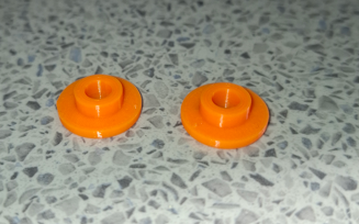

    Using Prusia slicer, and 3D printer, out came these

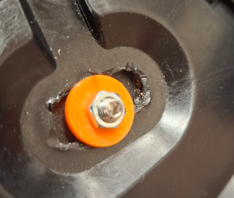

    screw grub screwed into nut insert and place top hat over the grub screw
    then secure with half nut
    use an Allen (Hex) key to hold grubscrew while using 8mm spanner to nip up the half nut.
    No torque applied to the nut insert
    repeated process for another spinning nut insert

    I'm happy to post out top hats to anyone requiring some ( A beer token or two should cover the cost)
