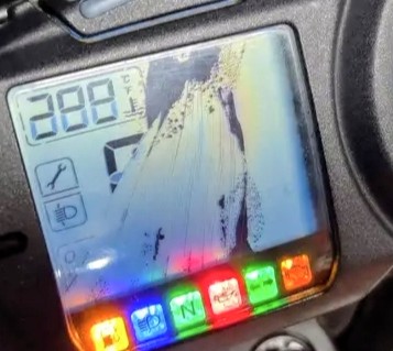

  1. 2006 1100cc
    Hi any ideas replace or repair in uk would like the milage to be as.it is now just passed mot
    Mike Screenshot_20260212_173942_Facebook~2.jpg Screenshot_20260212_173942_Facebook~2.jpg

  2. Scorpio Electronics used to repair these clocks, they've done plenty, worth contacting but, this was a few years ago, UK based.

  3. I think factory price, when it was available would be double that, maybe treble Jez..
  4. Thank.you will try to contact them
  5. Thank.you

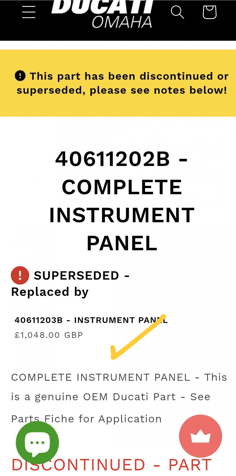

  12. Hi had a email reply can be repaired OK only thing is find a good one for parts
    Ducsti part no for s new one is costly
  13. Did they give you an approximate quote? - also which spare parts would they need? - one of the first things to go is the LCD so very unlikely to find a "parts" one with this intact. :thinkingface:I would strongly consider the EBay item if it were me.
  14. Yes ebay it is I think.is a case off buying one with.a good screen and sending.both.off to.them no.price given
  15. i meant the new one - haven't seen any "parts only" possibly ever on UK EBay, and as explained, you need a good LCD which is unlikely to turn up. Also repair will not have the longevity that a new one has, provided it is just that.
  16. They are nor available and have been updated cost is around ,£1048 plus postage
