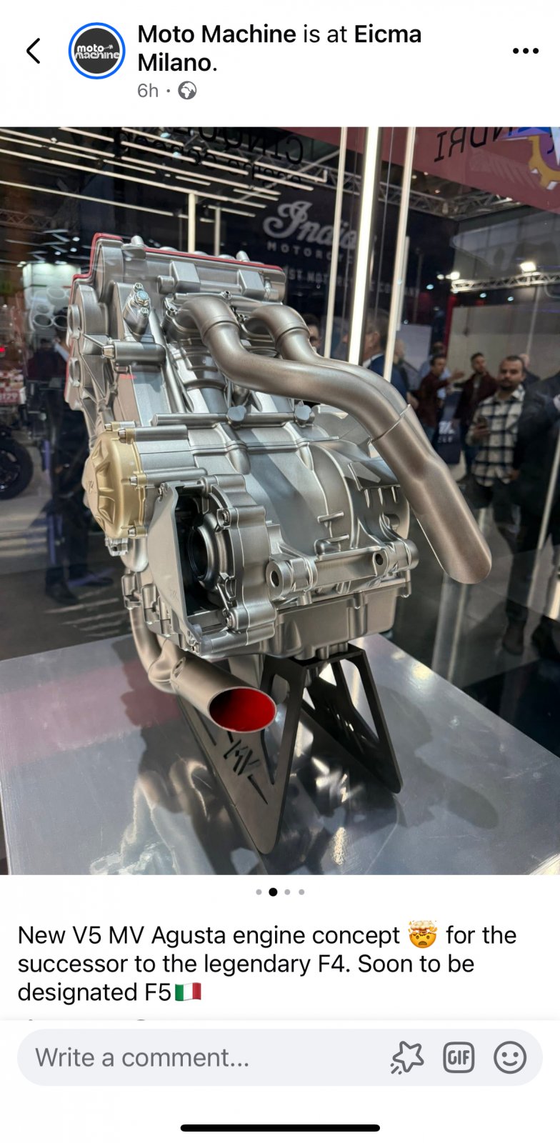

  1. Now this potentially out does the Honda V3R.
  2. Another concept engine??
  3. Where’s the V bit then?
  4. Yep that looks like an inclined parallel twin.
  5. Narrow-angle vee. Like a Volkswagen VR car engine, or a Horex VR6.
    Edit: Apparently not. It is said to have two crankshafts as the Ariel Square Four had. So not a vee.
    #5 Pete1950, Nov 6, 2025
  6. I see what you mean, makes sense.
  7. Interesting concept, the intakes go down through the head, not sure how they are done on the VR6 VW engine but don’t think it’s like that.
    it’s an idea with merit! A way to get 5 cylinders in with the width of a 3 cylinder and a bit, but because of how they are doing it, it looks like they are doing it with just one cam chain and then gear driven across the cams from there, quite interesting idea.
  8. Lets wait for further news?
  9. So five exhaust ports going into two exhaust pipes?
  10. No, 3 at the front going into 1 and 2 at the back also going into 1
  11. It's not a V5, it's a square 5. It has 2 crank shafts.
  12. Yes, so we are now told. Not seen detailed explanations, dimensions, etc.
  13. They probably haven't got any details. It's clearly just a mock up. No sensors, wires, no output shaft. Most likely a publicity stunt.
