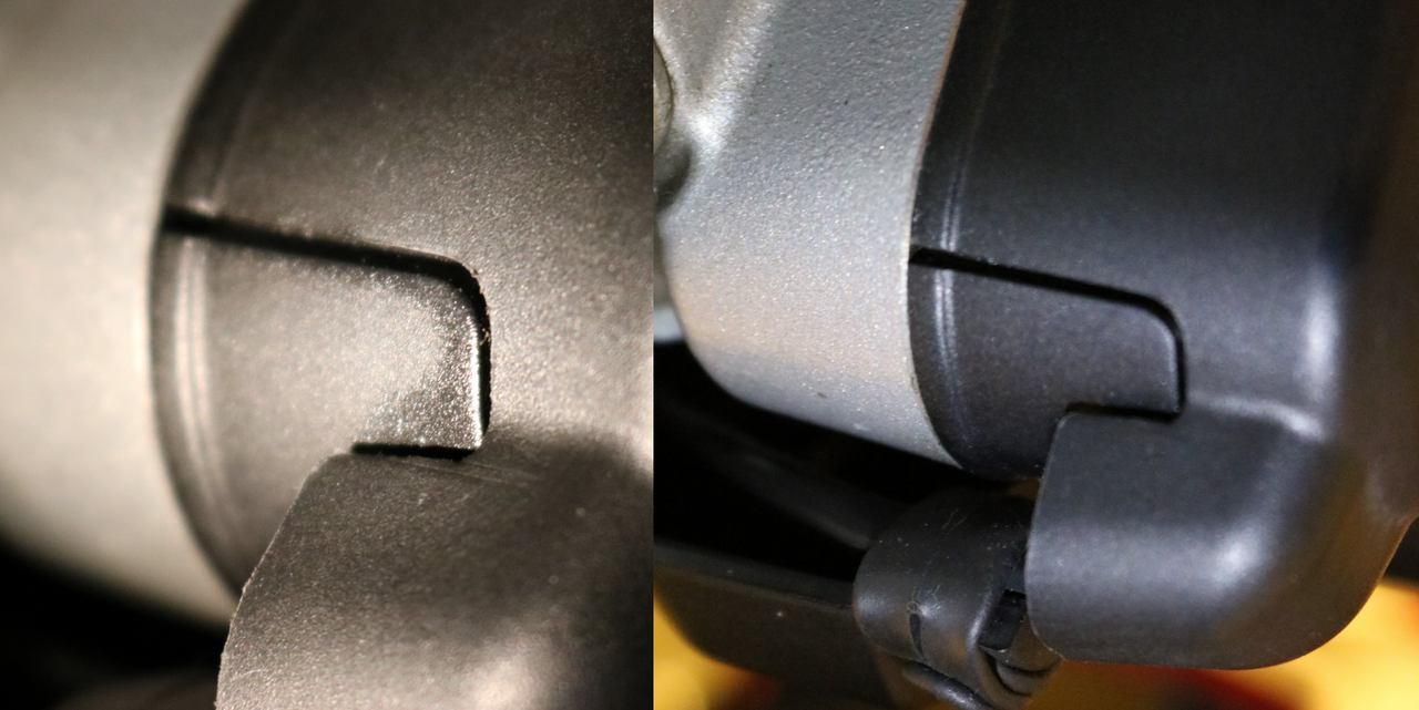

  6. since it was a desmo service they will have had the rocker covers off. These are fitted with grey gasket sealer on both sides of the rubber gasket now, and I would suggest this is where yours is leaking from.
    I would be surprised if the rubber gaskets actually needed changing if they put them back on with sealer, maybe they didnt bother.
    The alternative would be the green O rings under the retaining bolts, but that would give a leak in a different place imo.

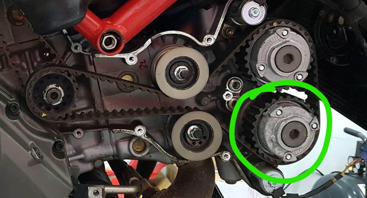

  7. well if I did pay attention, lol, he was not talking about the seal that failed between the main engine case and the camcover, but about a seal + rubber ring part that acts as a seal behind the part I marked in green, a part that drives the belts
    It seems to be something that closes the internals of the engine from the outside world.
    Luckely the oil leak was limited to a certain section of the engine so that it never reached the belts themselves....

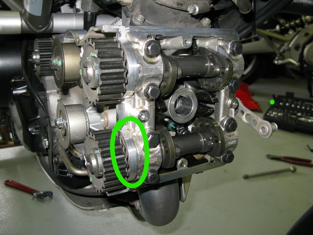

    (last 2 pics are not from a DVT engine, I think)
  8. Correct, as far as I understood, that O ring wasnt in stock and had to be replaced...
    And around that o-ring sealing had to be applied? Not sure.
    But the oil didnt reach the belt area at all.
    Dunno if that all made sense :)
