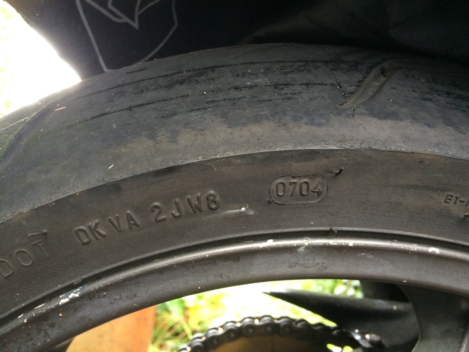

  4. 7CB88B0B-A92A-46C0-BA61-CC1F73246C7C.jpeg Just thought i’d Check the tyre date
    Does this mean they’re from 2004?
  5. Yes, late Feb 04. Probably past their best though depends on storage. I for one would be changing those.
  6. That's what I thought! They'll be getting changed, then.

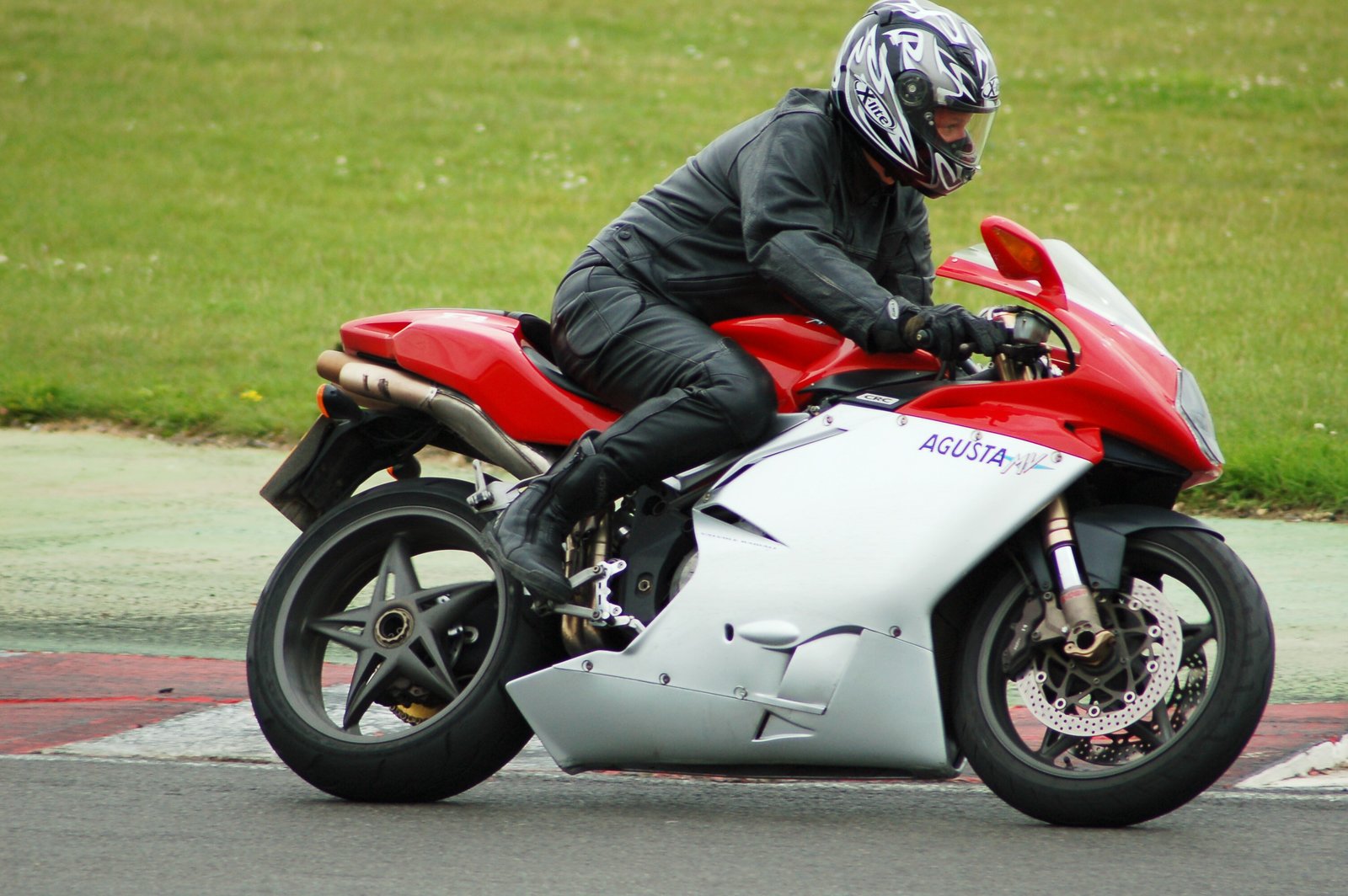

  7. Congratulations on the MV aquisition .................. enjoyed the 750 I owned a while back and echo previous comments. A wonderful piece of motorcycle history/art and loved to go everywhere at speed. Did a 700 + mile round trip to Norfolk and a Snetterton track day in between, seemed to go pretty quick down the (old) Snetterton straight with over 150 on the clock which was probably nearer 140 in real money, plenty fast enough for me. Driving to and from the track I spent most of the trip thinking about speed limits and my licence as the MV just wanted to go faster everywhere.
    Make sure the fan is working and stop if it doesn't cut in when it should - the fuse goes and then your engine will pop if you ignore temp gauge. snetterton 154.jpg Happily I stopped and changed the fuse in time...............
    If you want to try some footrest plates I have a nice set in my spares cupboard (£30 + postage ?)- they provided a little more leg room on the standard seating position and bolted straight on. I may have sourced them from the aformentioned performance shop that shall never be mentioned anymore but they did arrive and worked fine ! Can't imagine I will ever use them. See happy days picture - sorry no bins on track at Snetterton ....though other opinions are available.

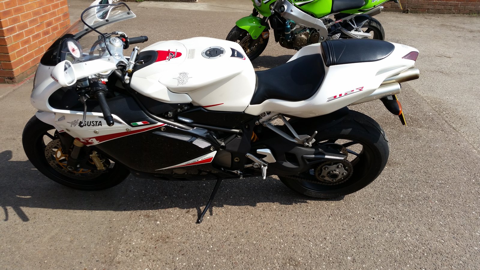

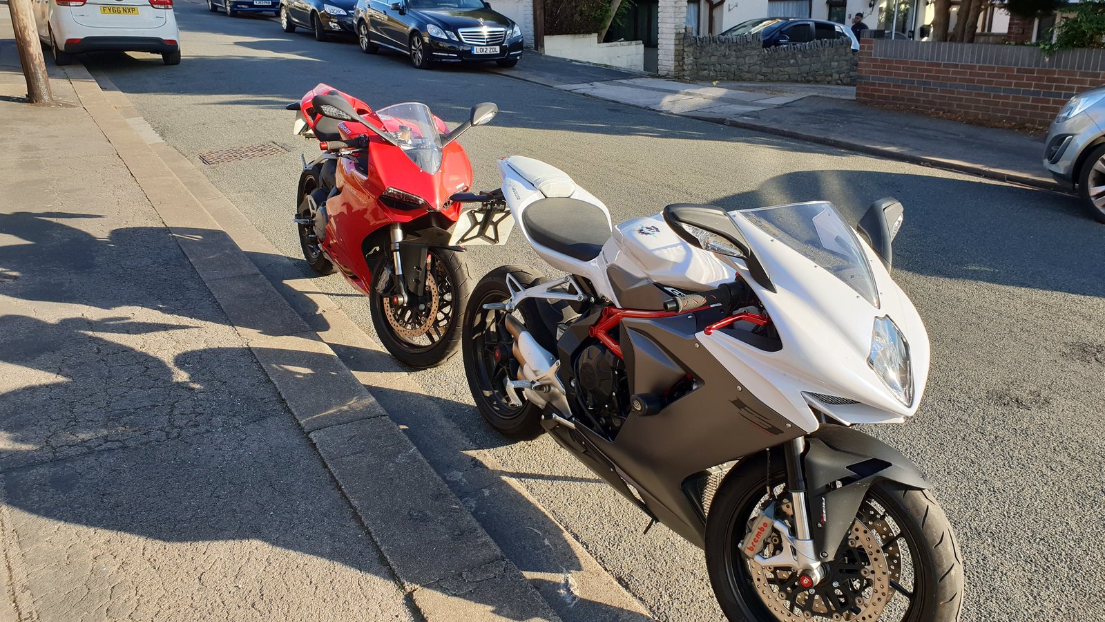

    These are mine, sadly the R312 was hit in June rather hard and I am a bit broken. I haven't got it back yet but it isn't well apparently. The RR312 I've never used, it's been in a corner with a sheet over it since the day it was delivered, started up once, then the battery was removed and bike put away.
    The R312 is quite something, you can just tell it's cam'd and lightened as soon as it's ridden, the cacophony of sound changing as each step of rpm comes along, even on a balanced throttle, the slightest input just transmits an urgent signal to the engine, that in fourth gear that can bring the front up as the bike comes on the cam higher up, still becoming more urgent. A bike that needs 100 miles just to make friends with, and then you're away.
    My RR was eventually registered just to keep it away from new rules, so it has a 66 plate lying around somewhere, wasn't worth fitting it. Someone else can after they've parted with at least £25k whenever that will be ;O)
