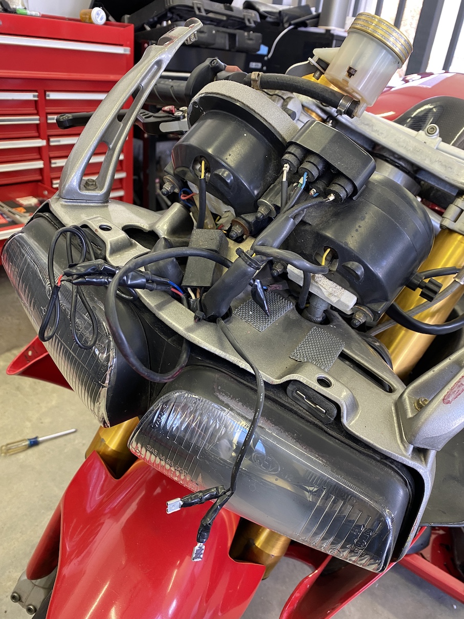

  2. I'm in the process of getting rid of the old, dubious fork-mounted turn signals and are trying to reinstall the OEM ones.
    Does anyone know where the factory wiring for the indicators is located? I tried tracing what the previous owner did but no luck yet.
  3. Congratulations beautiful bike... I follow your work with interest!
  4. A bit more progress today. I removed the aftermarket turn signals and, to my pleasant surprise, the original bullet connectors were still in place. So the OEM indicators went back in easily:

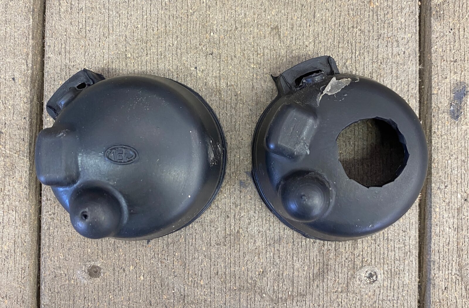

    I went to replace this headlight wiring boot but it turns out the boots are different on each side of the headlight -- and I bought the wrong one. :rolleyes: Here is the old one:

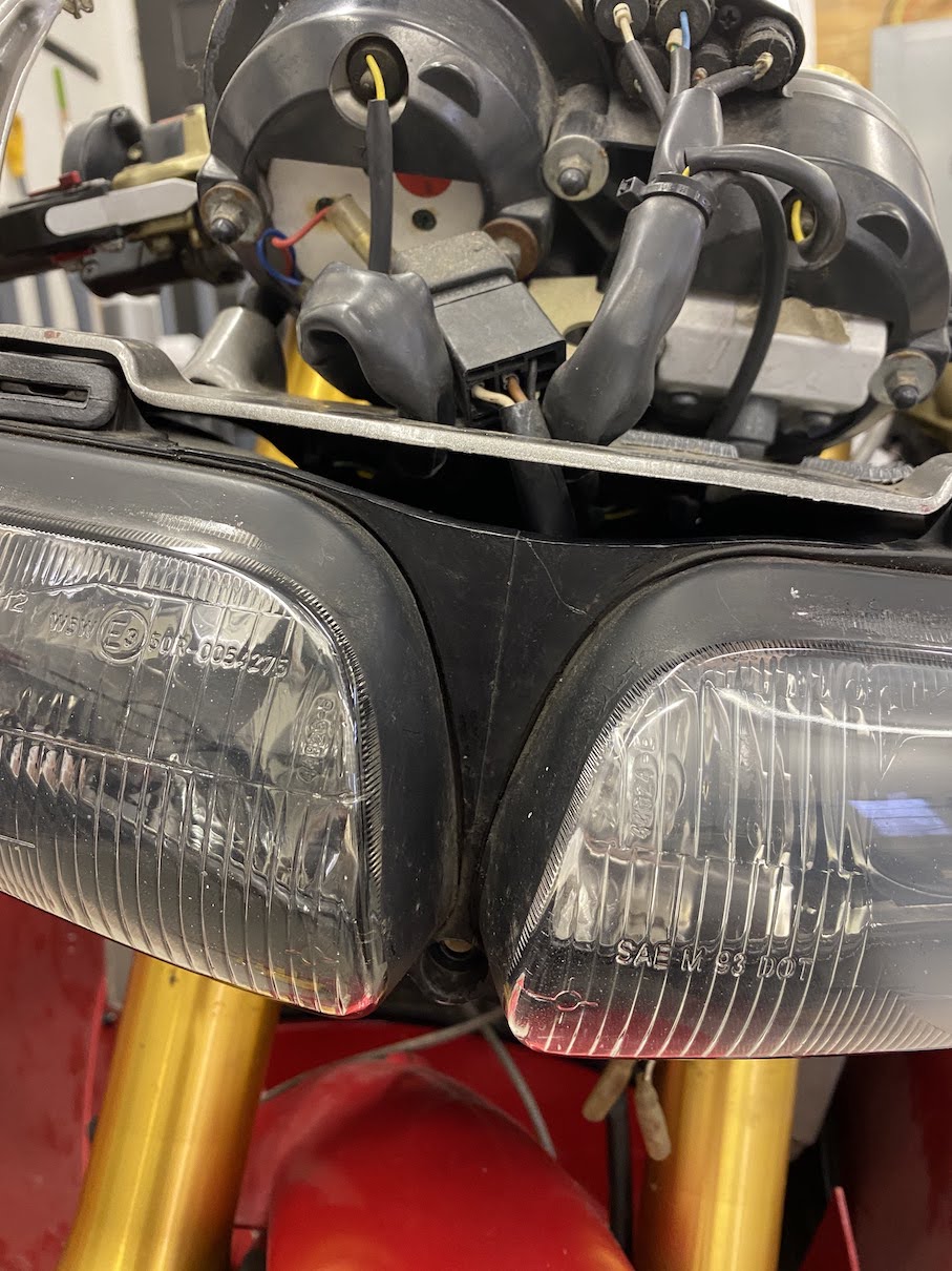

    The other frustrating thing was that, when removing the headlight to get access the bucket, I managed to snap the plastic surround for the headlight. You can see the hairline crack here vertically between the two lamps:
    It's covered up by the front fairing, but I will probably try and epoxy it back together. I thought the plastic housing was a replaceable part, but looking at the parts fiche the headlight and housing is one big (expensive) unit.

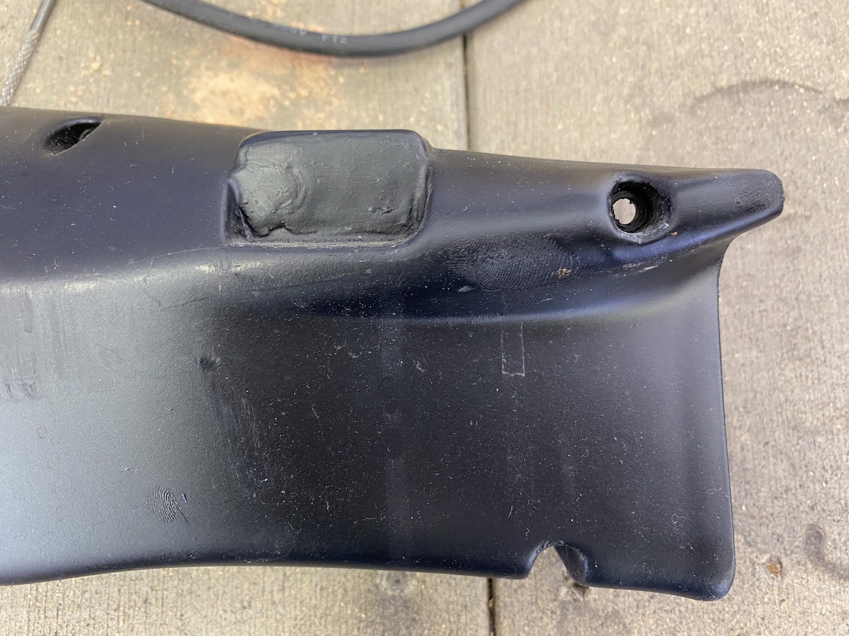

  5. I also managed to salvage these: it looks like they had been filled with wood putty (!). I drilled the putty out with a Dremel, then cleaned the threads with a M6x1.0 thread chaser.
    Before:
    After:

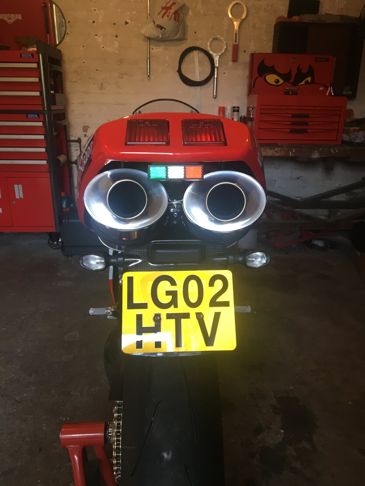

    Rear turn signals attached and working. The license plate bracket is new OEM and turn signals are new OEM; license plate light came with the bike but doesn't work. The bulb doesn't look blown, and it's getting ~10.5V across the two terminals, but it doesn't come on. Weird. Also note the correct fastener and nut holding the two cans together: it's the little things :)
    I do have one question, though. Is this brake light housing factory? The reason I ask is that you can see it has a small license plate bracket on it, visible both in the picture above and a close-up below:
    I don't remember my 748SP having that little bracket, but that was ~15 years ago now (!)
  7. That’s for the rear reflector. The number plate holder fixes underneath the undertray using the three holes
  8. Got it, thanks! It's, um, quite ugly. And I have no real desire to put a reflector there...
  9. There are worse things. :)

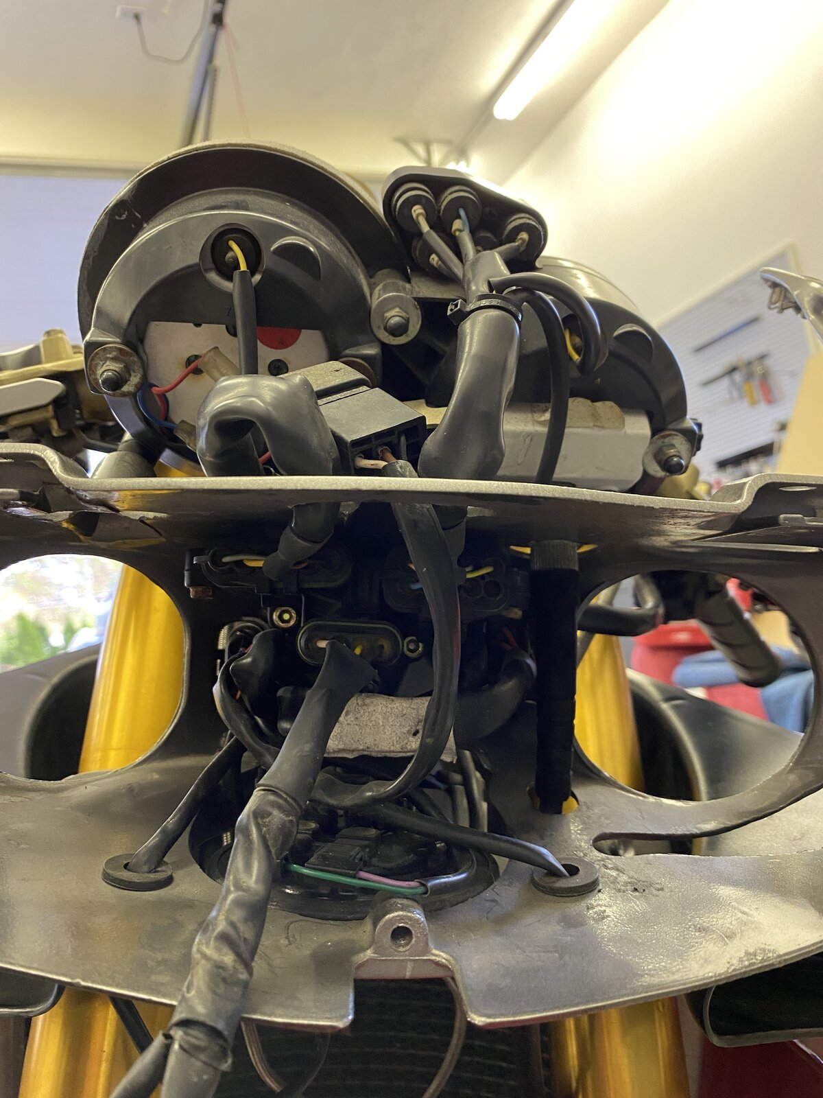

  16. To get the gauge cluster out, there’s a nut right inside the headlight bucket. You have to approach it from inside and below. It may be hidden by the wiring.
