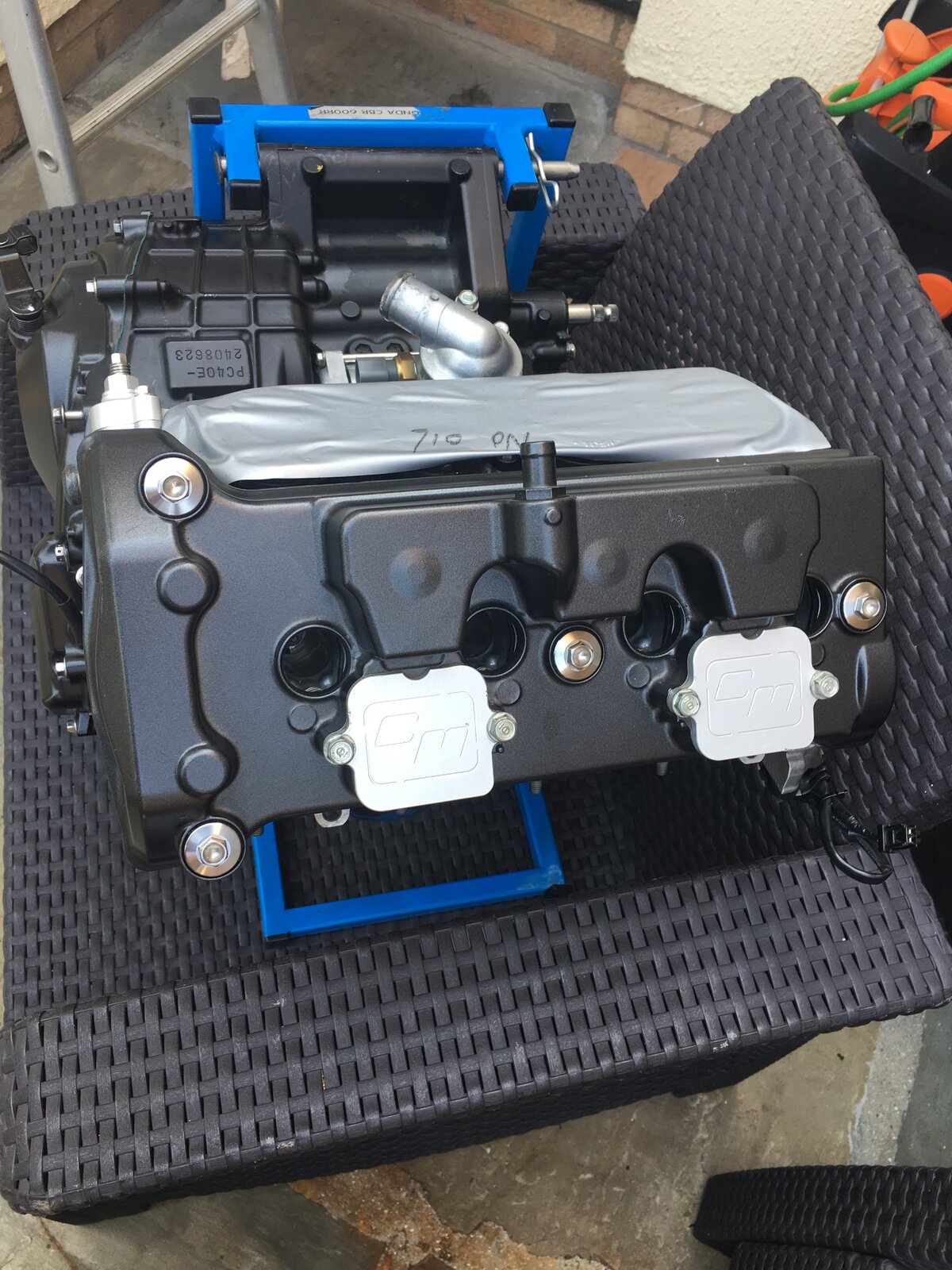

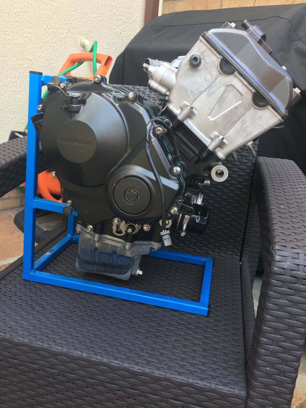

    In stepped a friend of mine who had a new full World Super Sport Spec Chris Mehew engine for my bike with all the bells and whistles. Worked head, lots of HRC and PTR/Tenkate factory gucci bits, cams, STM Slipper etc etc. And to be honest rebuilding my motor with the sheer amount of miles on it (have you ever heard of a 600cc race engine doing over 20k miles! thing should be in a museum its amazing) was going to be an expensive affair.. so man math took hold and I sourced the new engine instead..

    So, what was next... well I had the new motor fitted - happy days... Well not quite. We stuck the bike on the dyno (same dyno as my stock motor) and were shocked to find that it wasn't really making any power at all, in fact it was down on power compared to my stocker :confounded:
    I called upon a friend of mine, who ran a TT team and knows these bikes like the back of his hand and unfortunately this meant that my bike.. that had just been rebuilt ended up like this... again!
    After a LOT of dicking about, it was highlighted that the Hondas really need a fair bit of advance on the timing to get the best out of them.. so YIPPEE more money :mask::sweat: and time for HRC Factory electronics comprising of Looms and ECU, but also World Championship one piece billet velocity stacks and a complete strip down of the bike. We also had to crack the motor just to be sure as it was oddly loosing power on every run we made for some reason :(
    It turned out the timing was also out, we aren't sure whether it jumped or what but it's fine now !

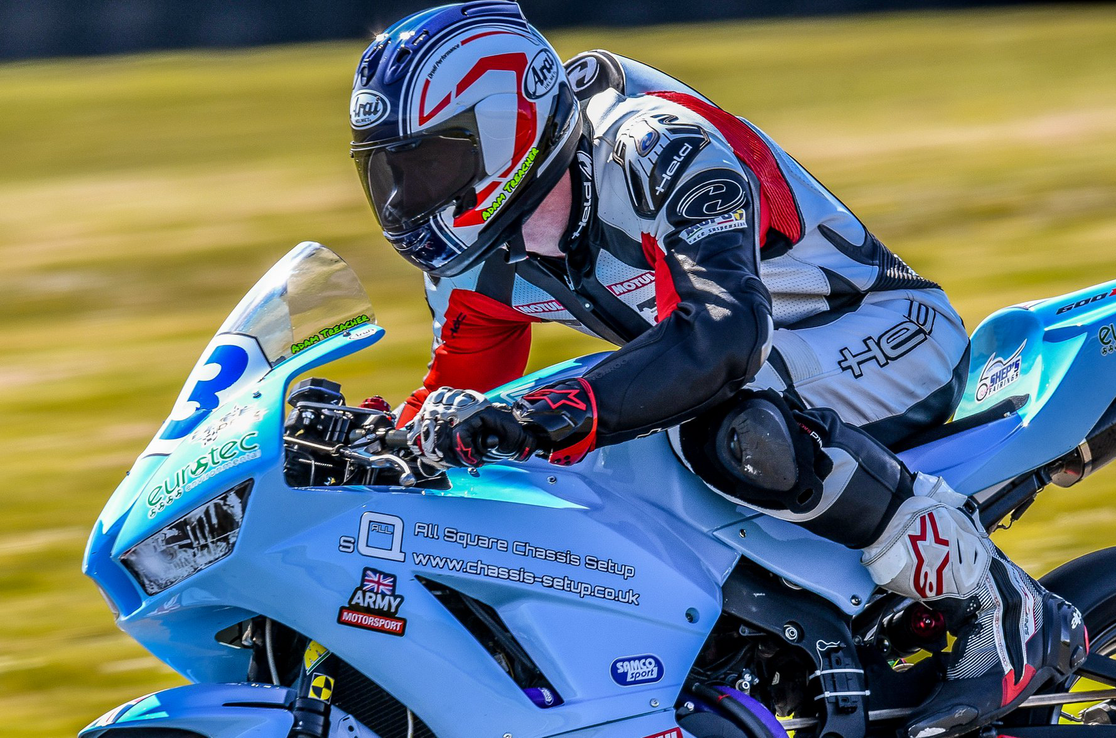

    I initially purchased this bike as a very good but basic track bike... and this is now the spec :sob:
    Full WSS spec Chris Mehew engine
    HRC gearbox & hybrid ceramic bearings.
    STM Slipper Clutch New Style
    PTR manual Cam Chain Tensioner.
    Custom made thermostat housing (thermo removed)
    HRC Kit Loom.
    HRC ‘Ten Kate worked’ ECU.
    HRC tilt switch.
    Oversized rad.
    Custom one piece billet PTR WSS Velocity stacks.
    Ten Kate Racing Products lightweight clutch cable assembly.
    Full titanium Pro bolt engine kit
    Titanium valve cover bolts
    Pro bolt titanium magnetic sump plug.
    Pro bolt titanium oil filler cap.
    Correct HRC spec spark plugs.
    Full arrow race exhaust system - full carbon Indy with removable baffle.
    Healtec Servo eliminator fitted and all removed, pairs system removed and blanked with Mehew blanks.
    Mupo Factory K911 & evo racing suspension front and rear (with remote preload).
    GPR Steering Damper
    Starlane gps4 data logger mounted on Kelfab bracket
    Ten Kate Racing Products front subframe
    Ten Kate Racing Products air intake.
    MWR racing air filter
    Lightech chain adjusters
    Lightech Magnesium rear sets (race and road pattern)
    MSS lock stop savers.
    Healtec gear indicator
    Translogic quick shifter
    Carbon Battery tray.
    Sidestand removed as per acu regs.
    Race fairings with tall TT screen
    Renthal clip ons
    Domino grips.
    TWM Brake Lever Guard
    Domino quick action throttle
    Aliant Lightweight lithium battery
    ACU Rain light (operated from its own switch)
    Gb racing engine protectors
    R&G acu shark fin chain guard
    R&G tank grips
    R&G bobbins
    Eazi Grip evo tank grips.
    Carbon tank protector
    Renthal sprocket(s) and EK Gold chain 520.
    Titanium sprocket nuts.
    Titanium disc bolts front.
    Biketek Quick fill tank cap
    Brembo zo4 pads.
    Motul RBS 660 fluid.
    Run on Motul 300v
    HEL Brake lines
    HRC reservoir
    HRC rear brake reservoir
    Accossato 19 master cylinder
    Wets on wheels
    Full Samco hose kit
