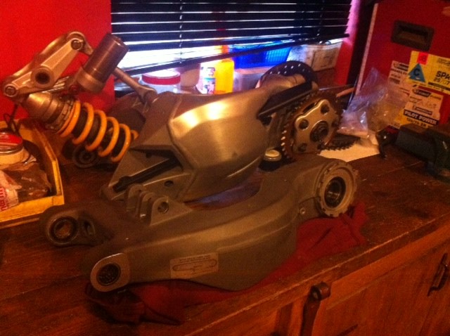

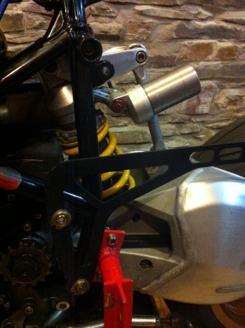

  1. All the bits mocked up for a trial fitting before welding started.

  2. Yeah, I took a screenshot on my phone and lost where the thread was. Will build my own at some point. Did you finish yours?

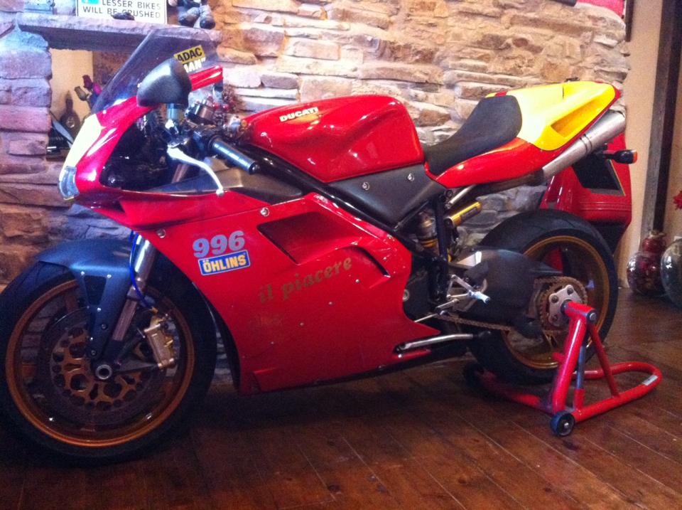

  3. Yes all finished and fitted.
    Steve

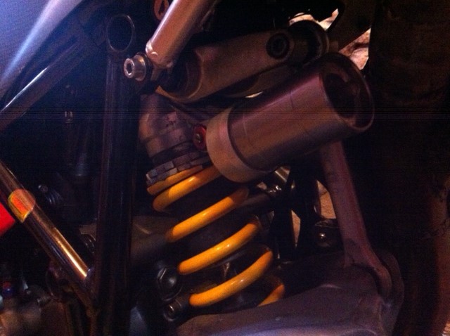

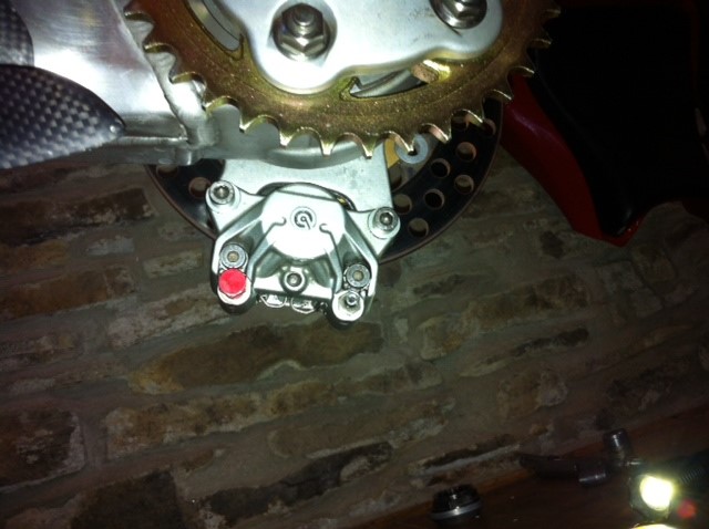

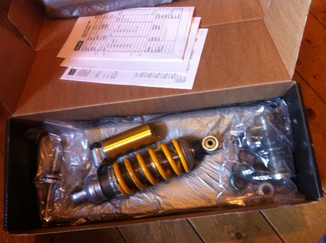

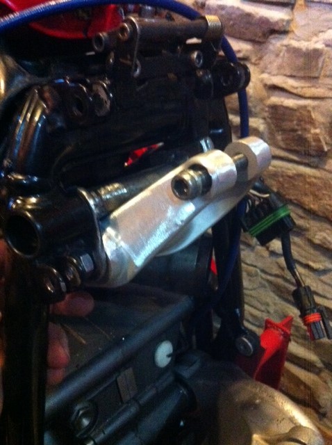

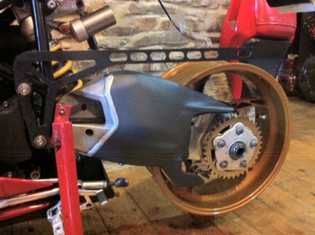

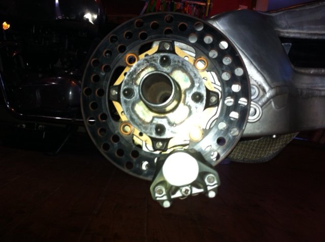

  9. Right small update. Flogged my old Ohlins to a friend for more than I could get a replacement that would fit my conversion.
    Personally I do not think my riding warrants a TTX so bog stock 1098 Ohlins ordered from Italy. Arrived withing 3 days so final assembly could commence. Any modifing of the shock I can get my Ohlins mate to do if need be.
    Everything checked and torqued in place.

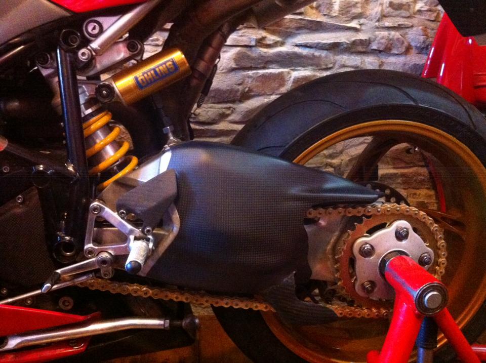

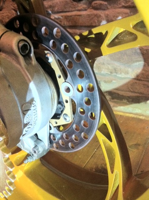

    So now running; 848 arm & hub, 999 rear caliper, 996 caliper hanger, 996 axle, 996 full floating rear disc, 996 sprocket carrier, 748r rear disc, 520 chain conversion, 1098 öhlins, modified suspension rocker, fabricated rocker adaptor, magnesium 5 spoke marchesini.

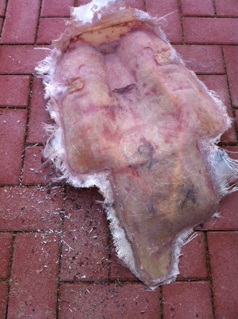

    Next thing to finish is the carbon undertray, so hopefully will get the cloth this weekend from a mate. Then stink the house out.

  13. Really enjoyed reading this whole thread.

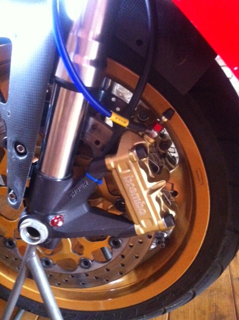

    I’ve got a 748 with a 2013 Multistrada engine in (1198) track bike. 848 front end, S1000RR calipers, 1098 loom & ECU with the map set up for me, cut/shut welded exhaust like yours, 139bhp at the wheel and 87 lb-ft. Really nice balance of power/torque. You have my airbox sympathies btw! I managed to find an Ohlins shock and forks and some light weight Marchesinis with bigger 1199 discs. The thing looks ace and I love it, although I’ve got an 1199 for the track.
    Hope you get the rewards from riding it!!!
