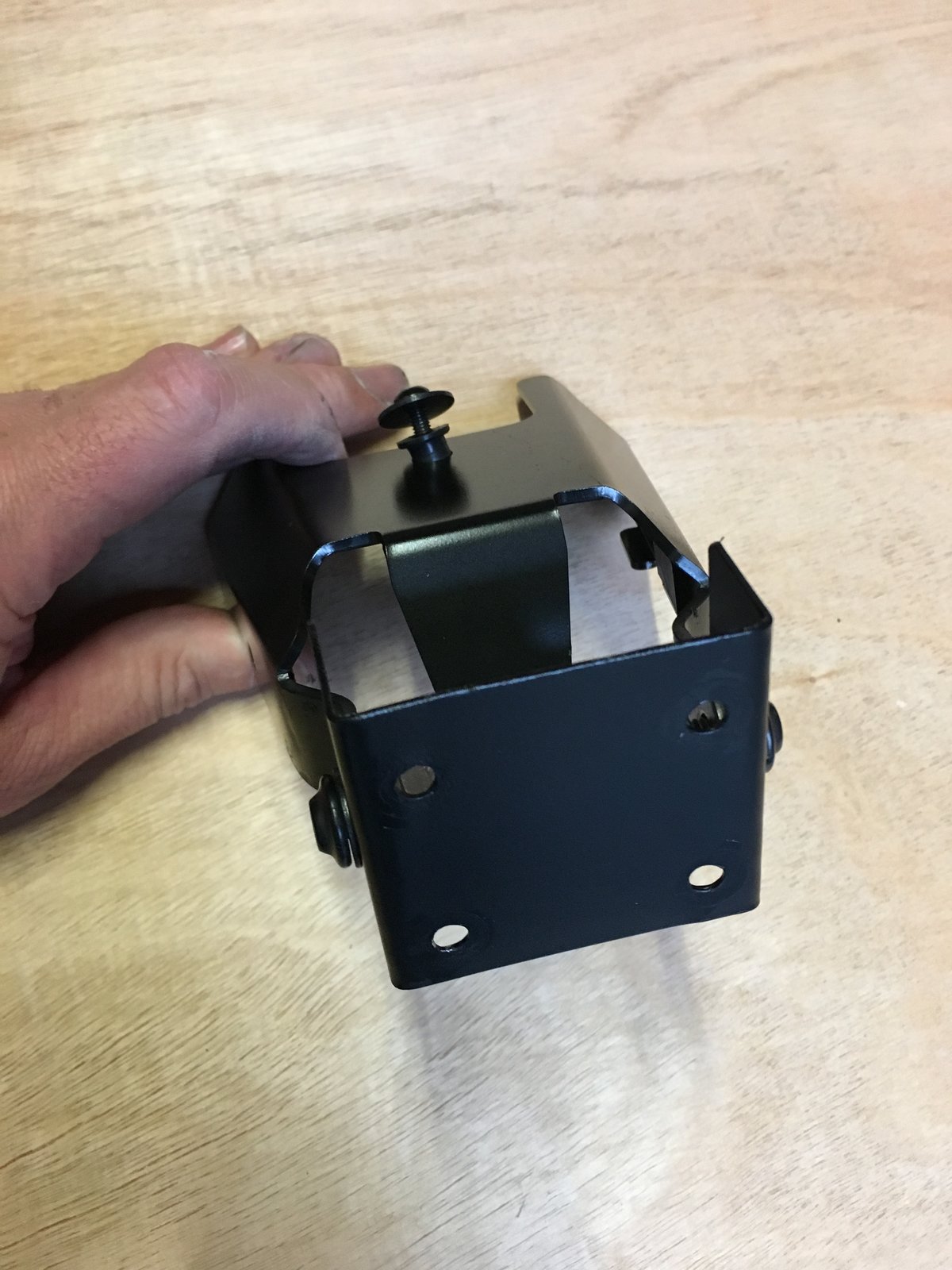

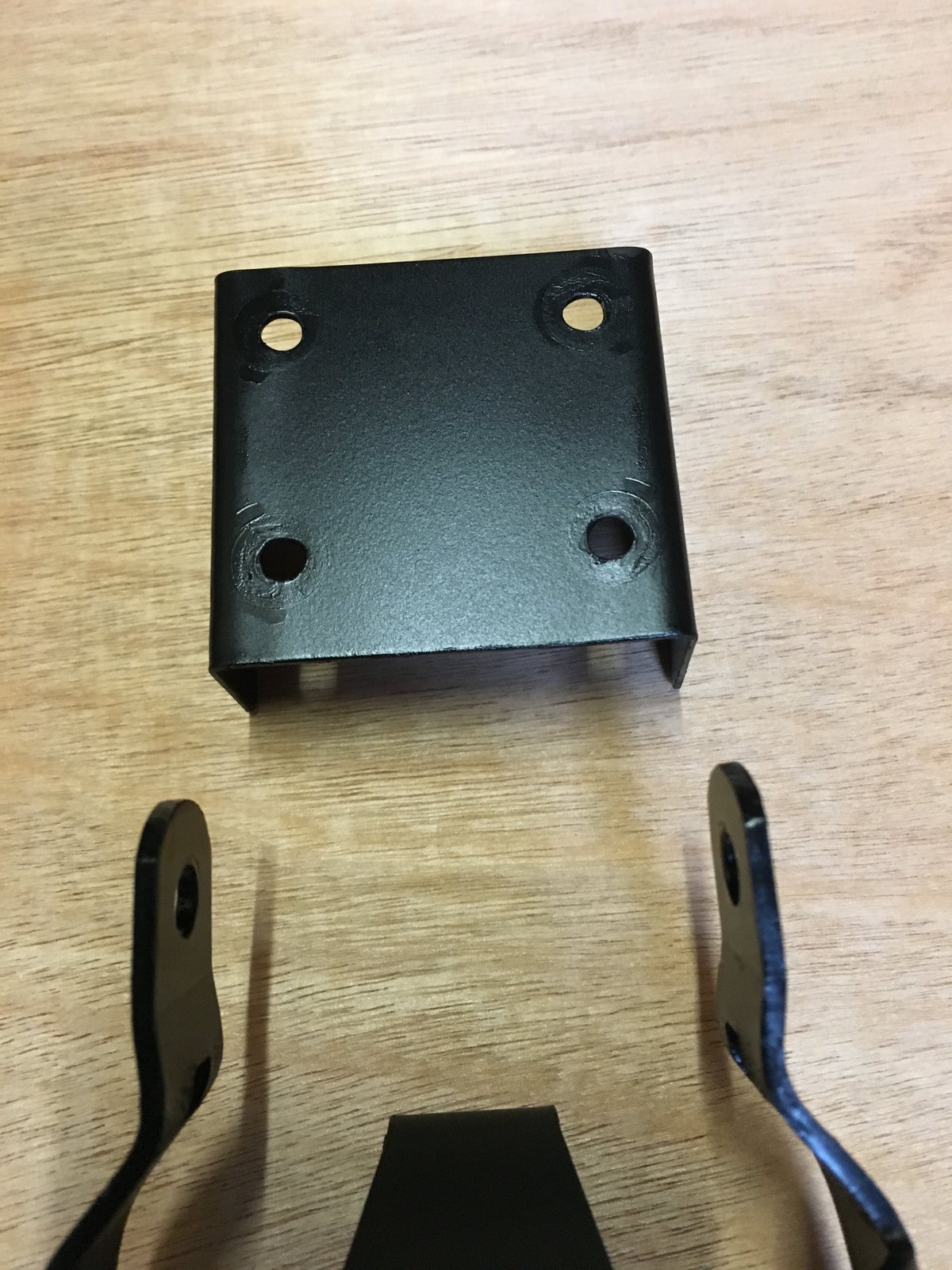

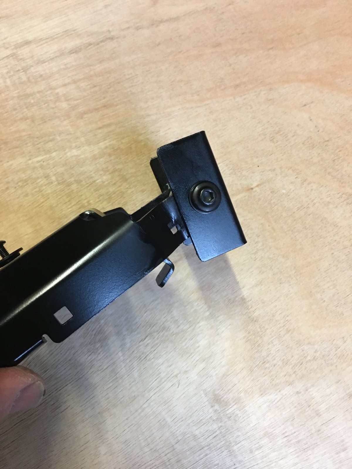

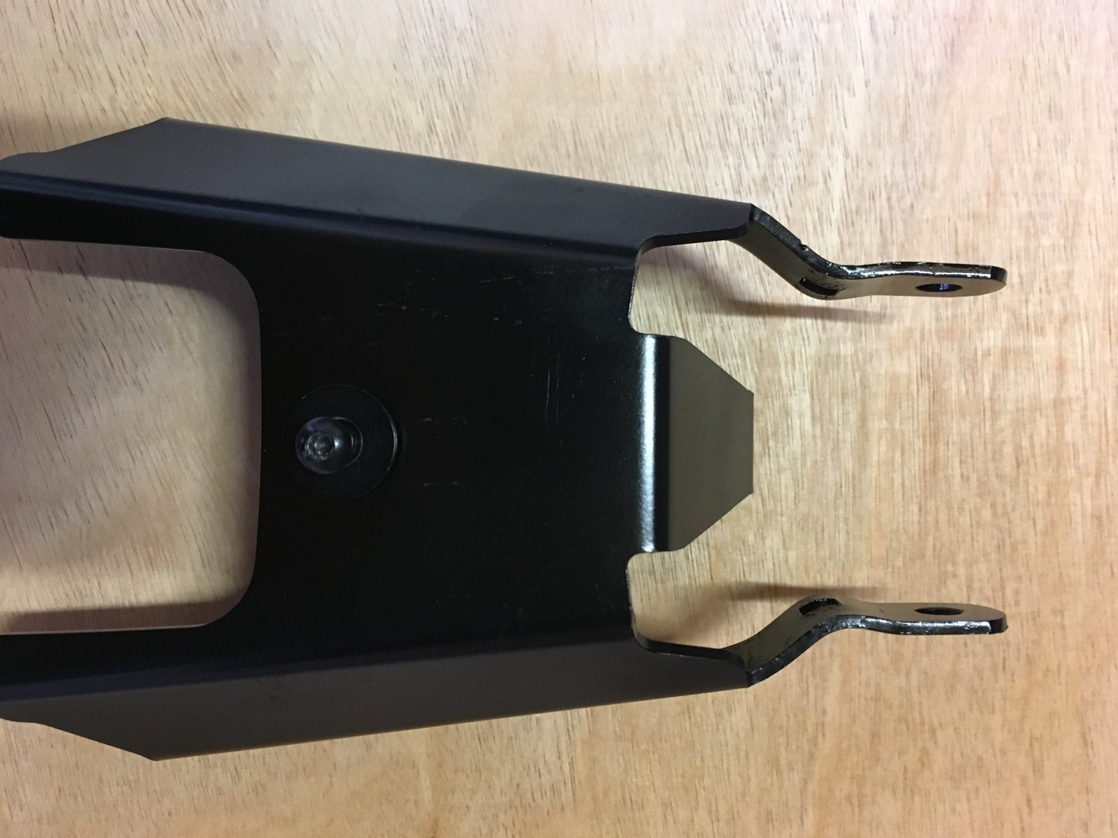

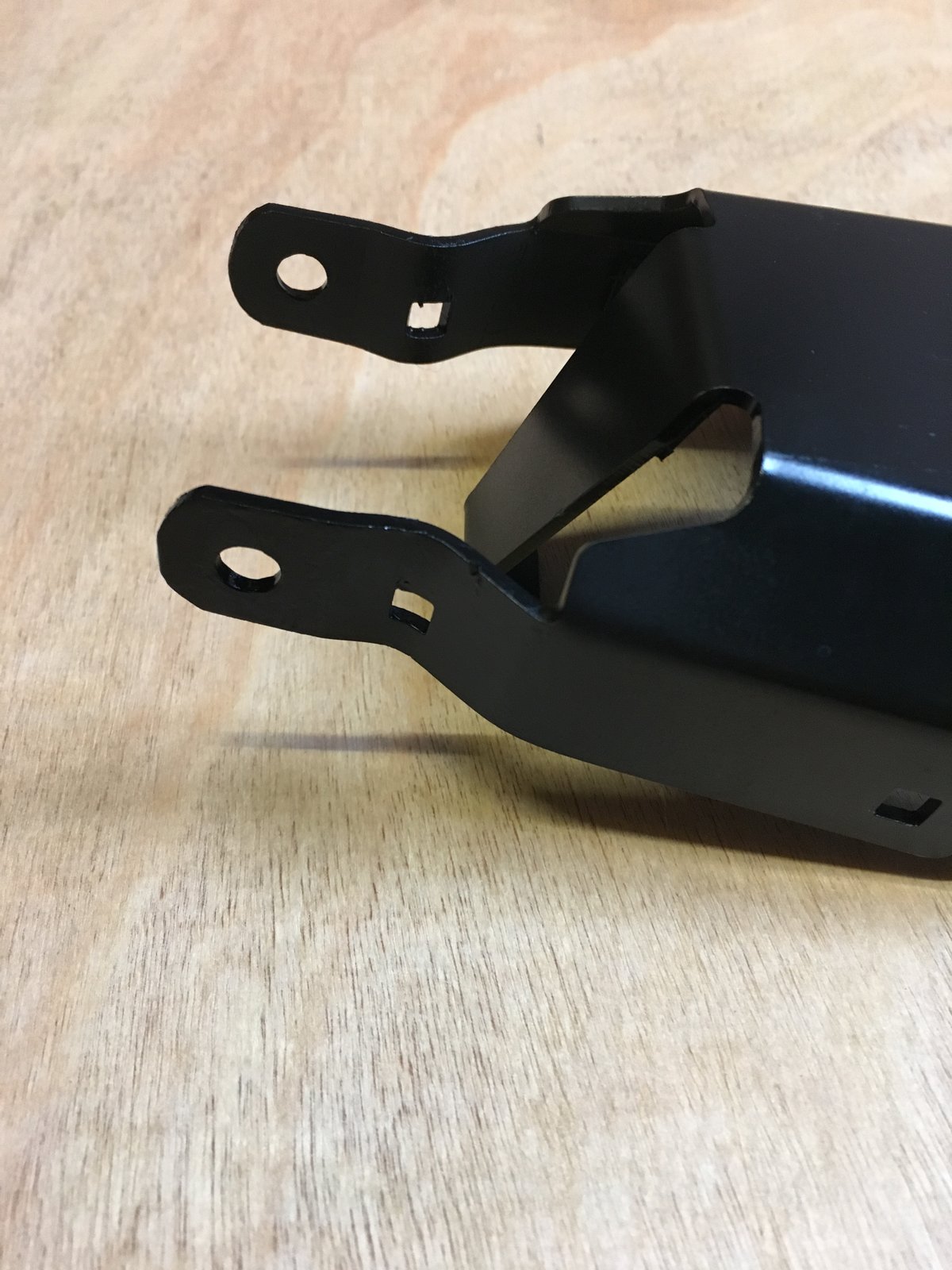

  2. bought a ducati high mount sat nav last week and had the same problem as others with fitting garmin zumo 590lm, so I bought an adaptor plate which worked but i didnt like how far the sat nav sat from the screen so got my mod head on and ended up chopping the origanal stalks down to hopefully stop the bouncing and made a new plate. all in all pretty easy and if you need pics will sort some tomorrow

  14. ok GH here some pics,
    In last pic of an origanal ive tried to show where I cut them down - red line and where I re-drilled in yellow, hope that helps
