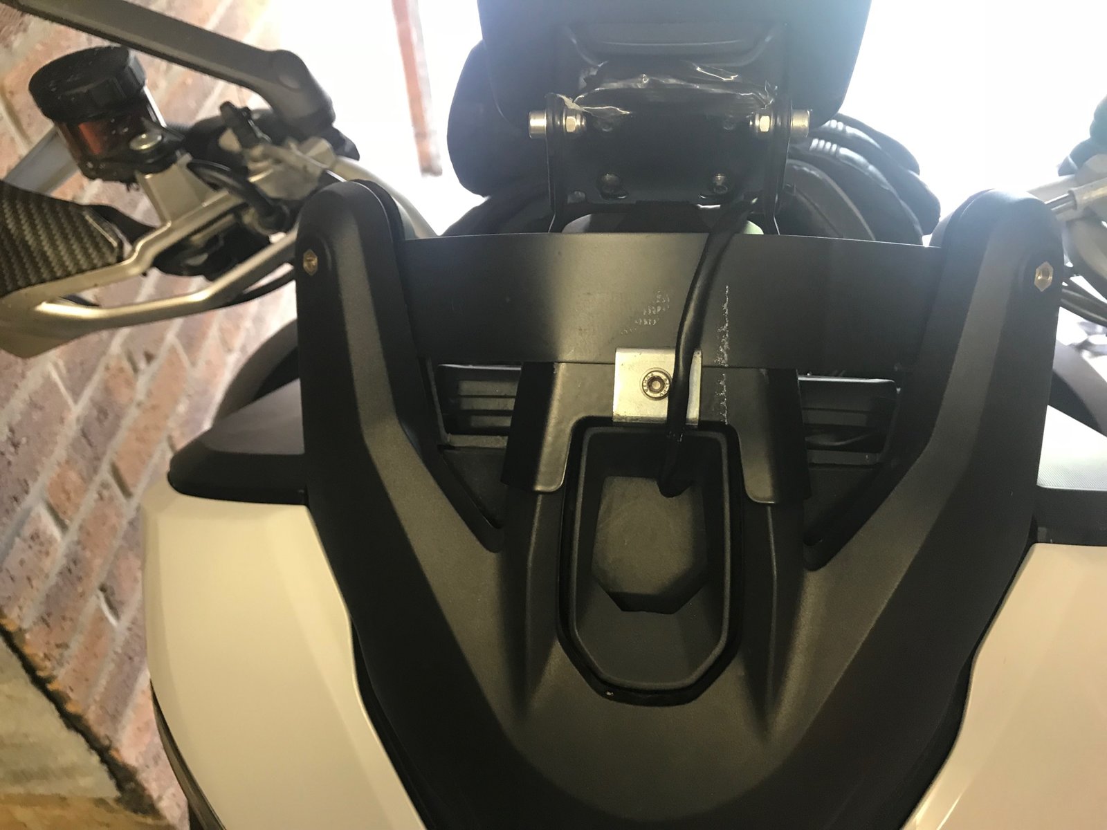

  3. Ok so I reckon (fingers crossed) I have sorted the wobble / vibration with the sat nav mounting, I got a piece of aluminium 300mm long, 25mm wide and 1mm thick and “eased” it around the mount and stuck the ends in the gap between the sliding screen mounts, I under the screw and using the U (flat) shap d but of steel screwed I’d down, see pictures. At all legal speeds it’s fine, on a private road at 120mph approx it still didn’t wobble, so I reckon that’s the best I am going to get.
