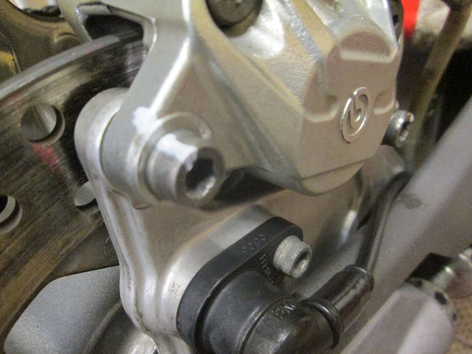

    I`ve always marked the pins on the split link. When oiling the chain, it makes it easy to see when the chain has done a full revolution.
    I also mark nuts and bolts when I`ve torqued them up. :bucktooth:

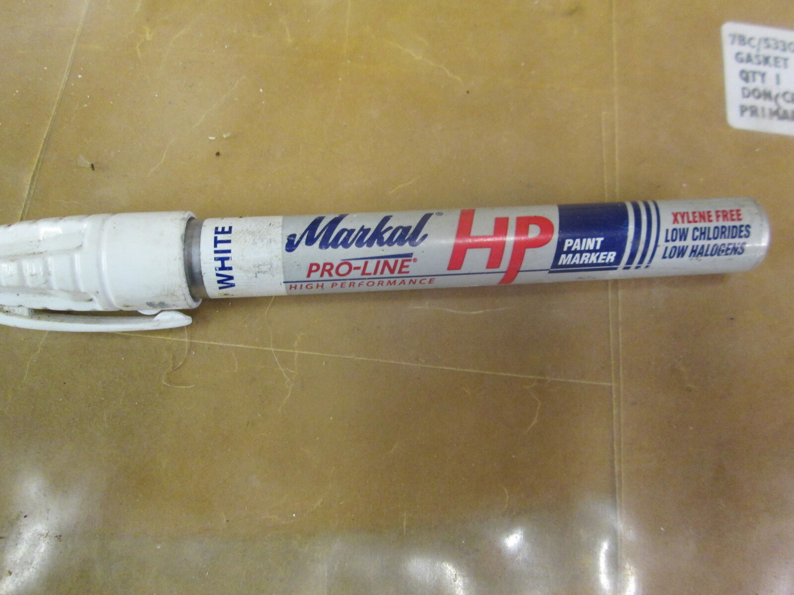

  19. What do you mark them with please? Everything I use were off, especially on the chain:(
  20. I use this.
    It`s not permanent but it does survive a couple of chain cleans. I use dry lube and I don`t spray the side plates.
    I don`t go mad cleaning and polishing, on non oily things it`s usually still on a year later.
    I`ve always marked nuts and bolts like this. It is a habit that goes back to when I was competing off road, a quick glance tells you everything is tightened up.
    I was once told "it`s won and lost in the garage." Now ain`t that the truth.
