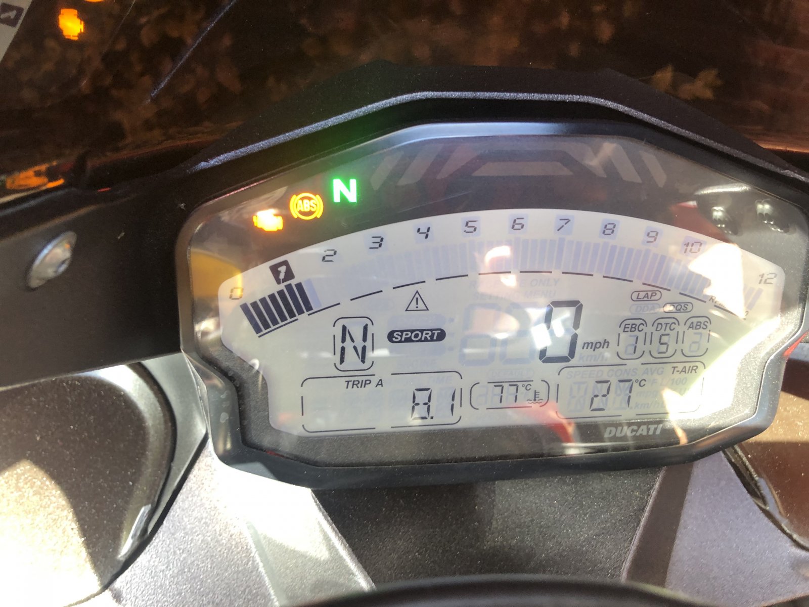

    I was out last Tuesday in that stinking hot heat on the little red bomb, outside temperature gauge read 30c by the time I got home and I just put the bike straight into the garage cos it had boiled me spuds and I was dying to get my leathers off!
    Got it out again last Thursday to go for a ride and upon starting it , the engine warning light just stayed on and there was a triangular warning symbol above the race mode that I’d never seen before??
    Anyone got any ideas about what’s happened?
    I’m just wondering if it’s the MAP sensor??

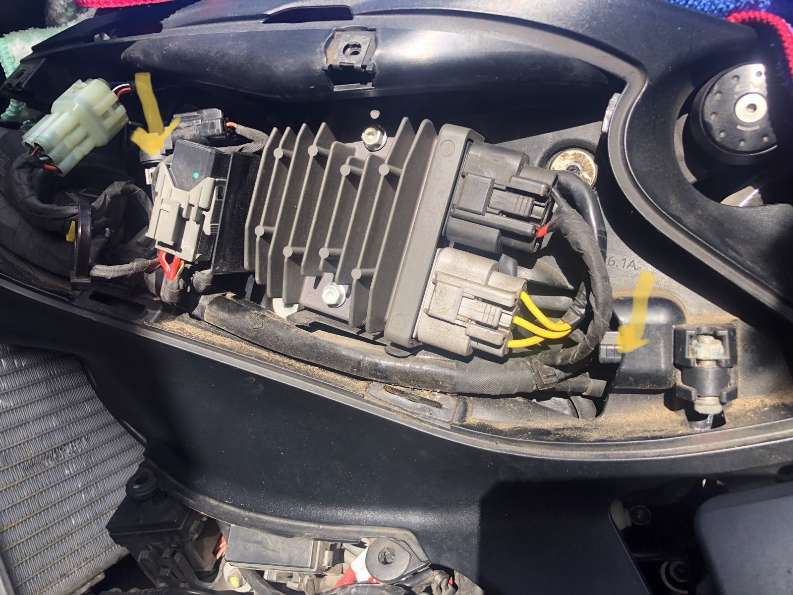

  2. That’s the warning I got when my map sensor failed but it may be the same for many other faults.

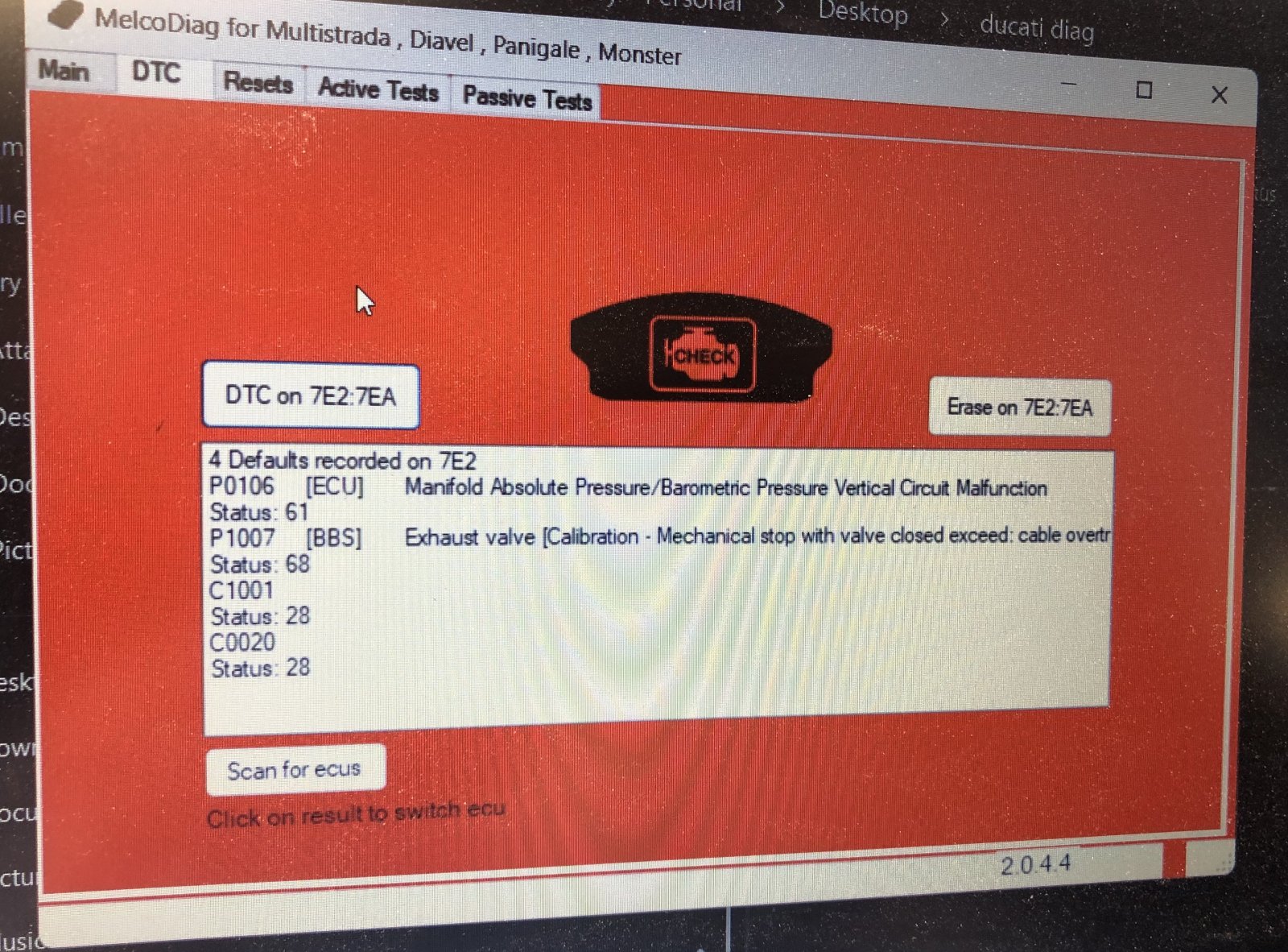

  3. i had this when my stator failed i wouldn't ride it far as mine kept cutting out. im in south shields you can borrow my laptop with melcodiag software if you can get through if not i could come to you but it would be thursday as i'm working late tonight.
  4. Thanks so much for the offer Jase, I’m gonna have a word with Ducati Leeds today, I’ll get back to you once I see what they have to say, cheers :upyeah:
  5. @jase just an update for you, a mate of a mate has two Ducati’s, he has the melcodiag software as well, I’m nipping down to see him tonight to see if we can diagnose the problem.
    Will keep you posted, thanks again for your offer of help :upyeah:
