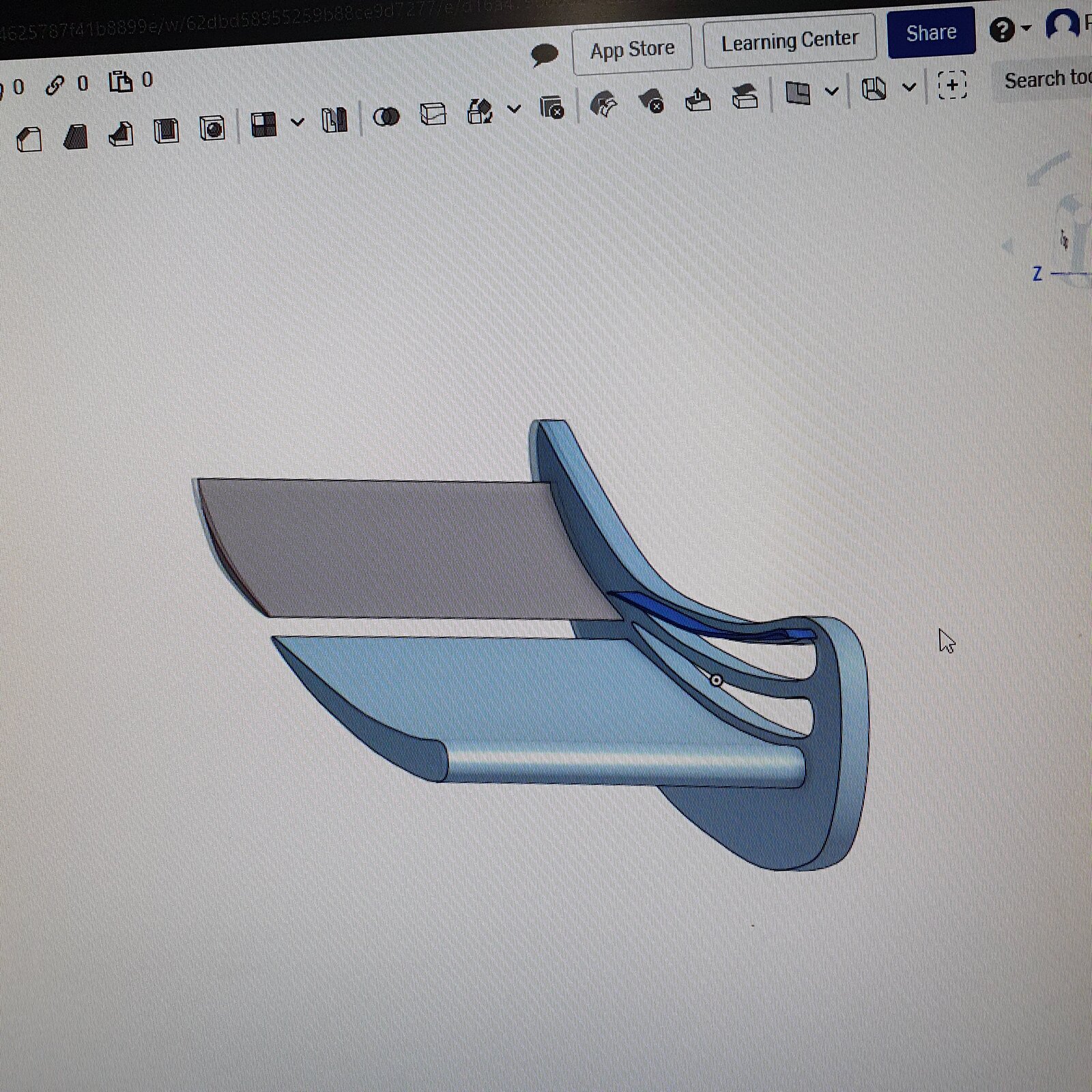

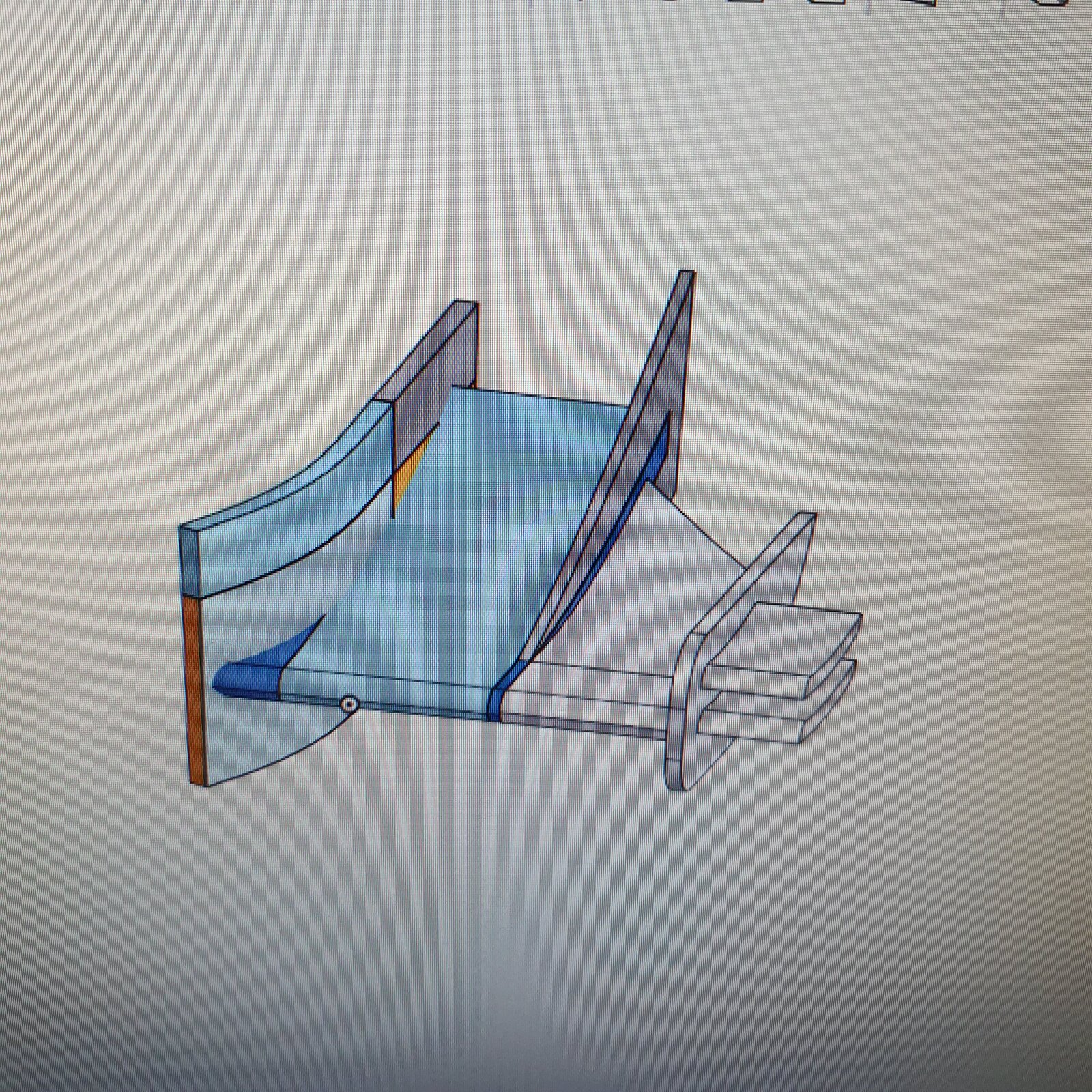

  3. Hi all,
    Just a quick update, I've started drawing the base shape for the bottom winglet,
    Just wanted you guys to see the progress

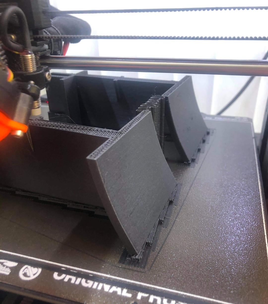

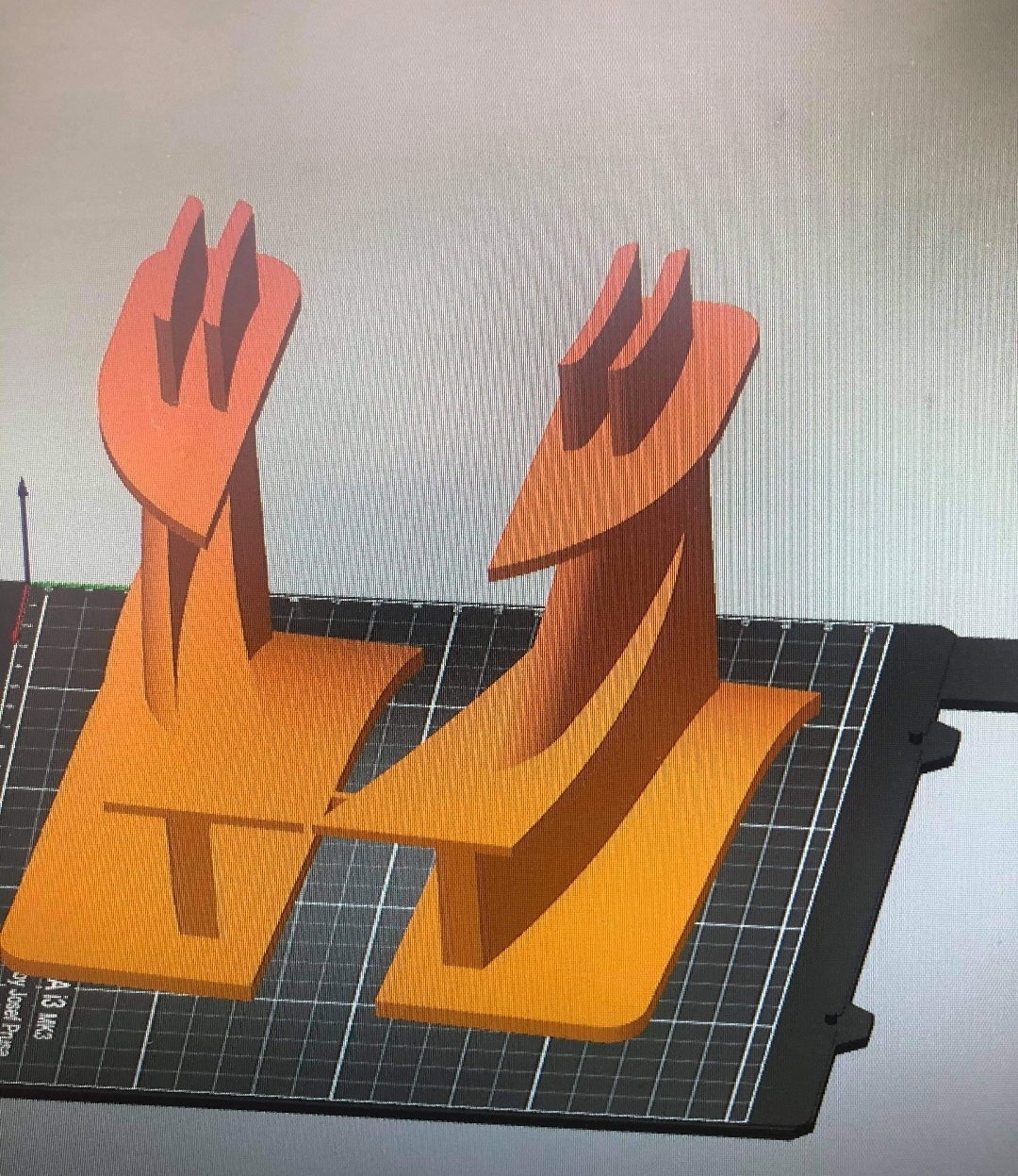

  4. Update on progress so far with the winglets, design is complete on the upper side and getting printed as I'm typing it now - material used is reinforced carbon
  5. Wow! Super impressive! :):upyeah:
  6. Thanks bud, the parts should be ready by 11am today fully printed, I just need to finish the design on the bottom winglets and print them too

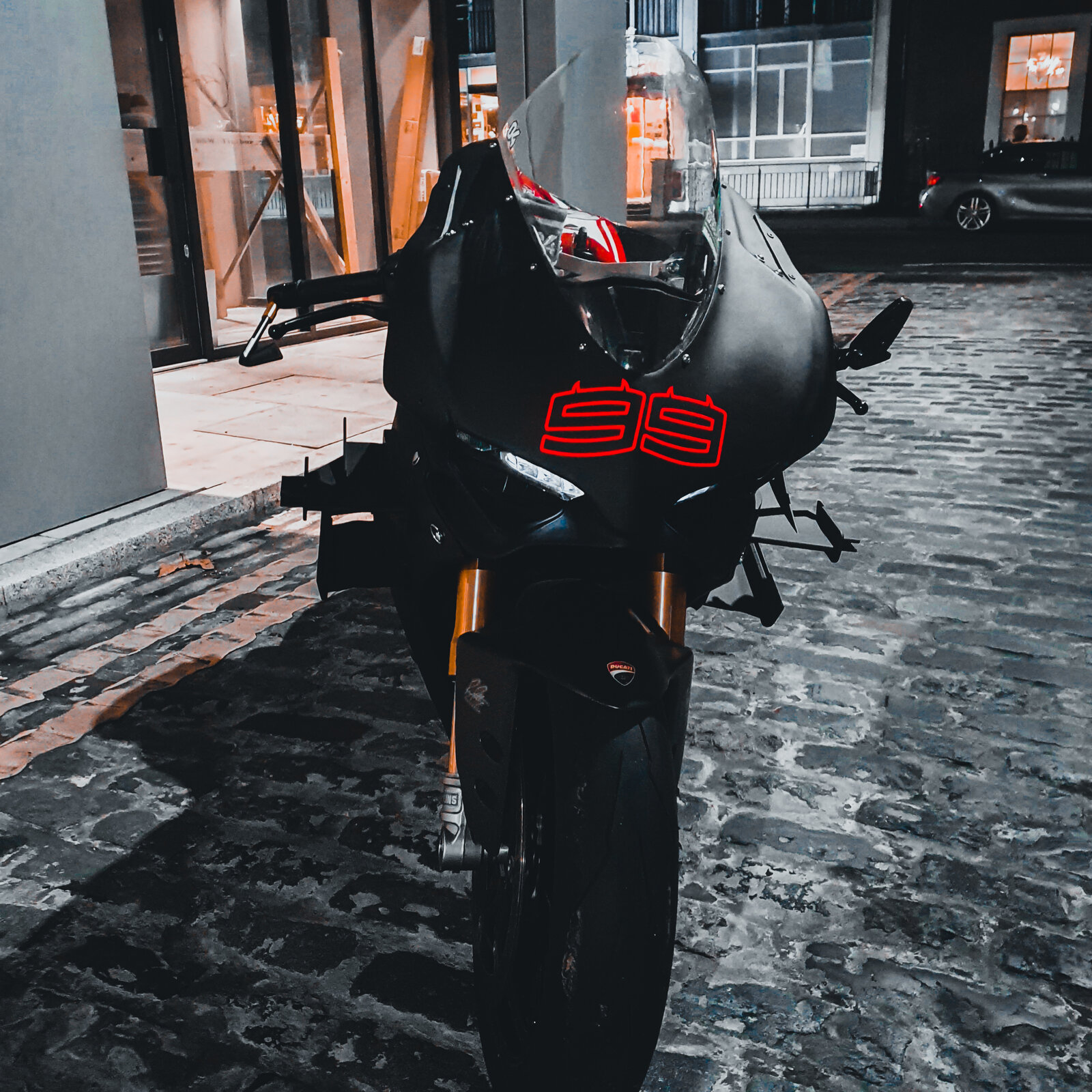

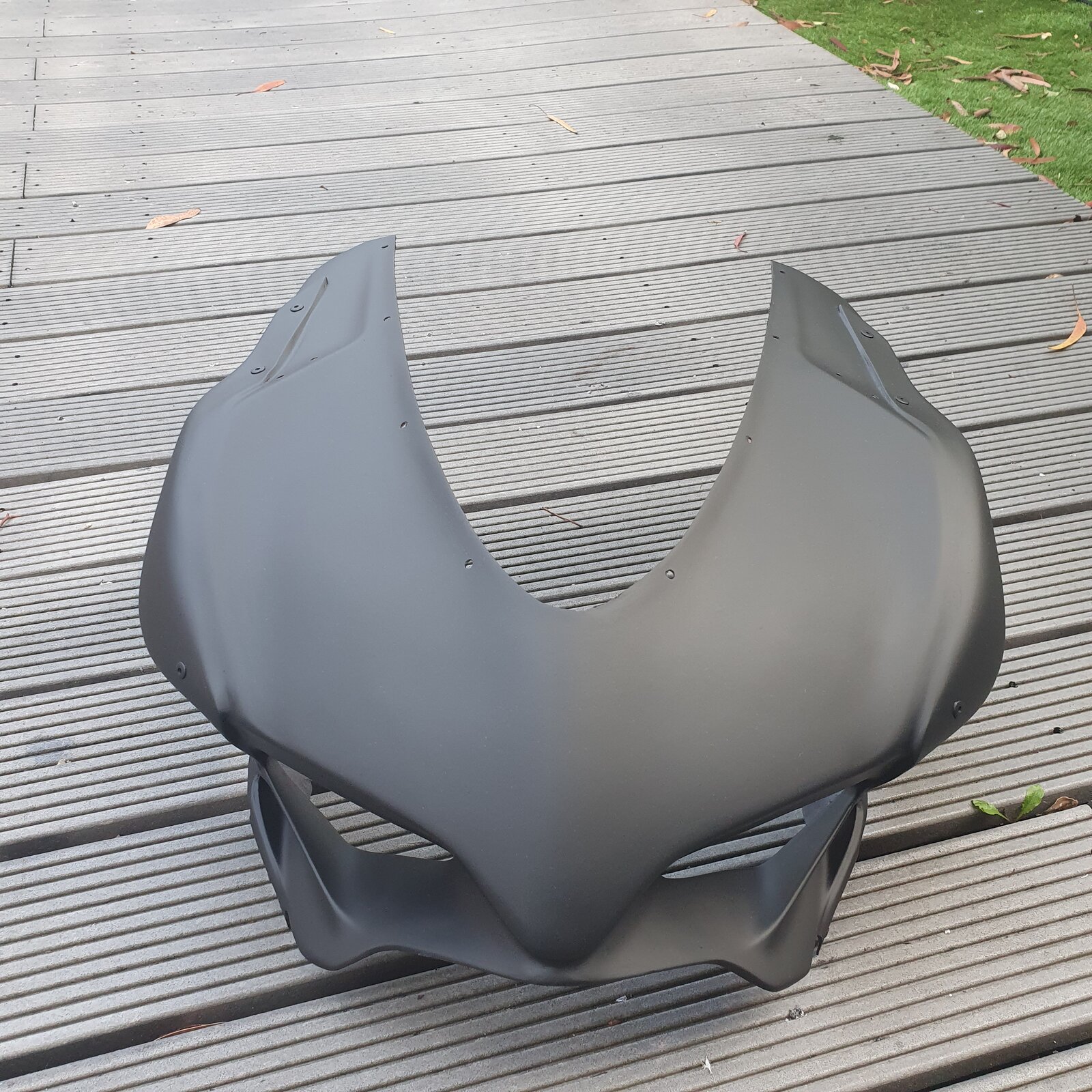

  12. And also a picture of the widened nose cone after paint
  13. Well, sorry for not posting the progress, been busy moving houses also..
    Partially complete, still need a bit of tinkering, not perfect but there it is
    Hope you guys like it!

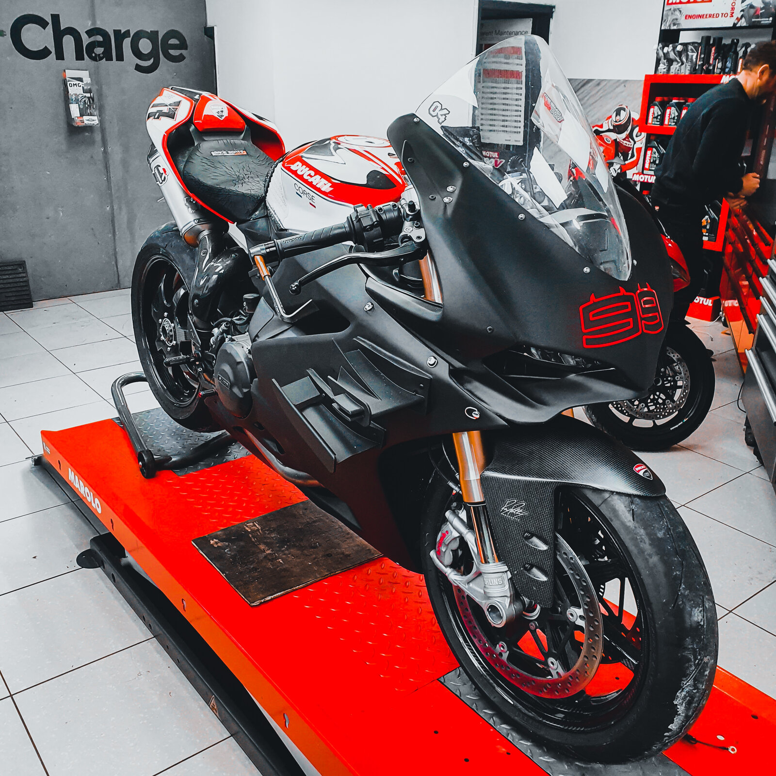

  14. Second picture looks a bit dim...
  15. Looks amazing! What’s going on with your seat? Funky....
  16. Thanks!
    Been used a lot cracked but still comfy tho

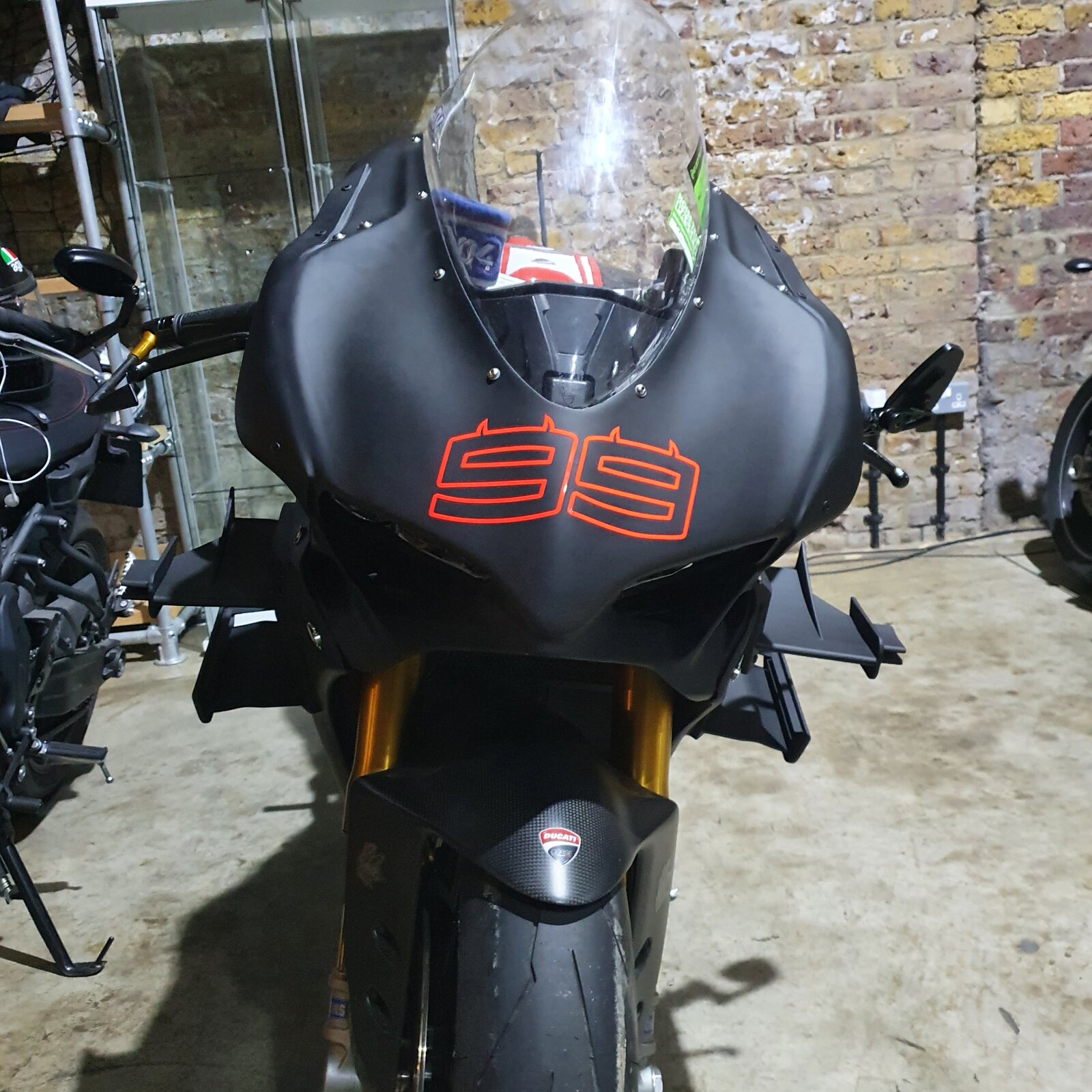

  17. Performance wise so far,
    Only went up to 95mph but you feel the bike more stable, a bit heavier than before as you can feel the front being pushed down and breaking wise, it feels like an r6 engine break when you release the throttle
    Can't actually say what downforce it gives but if you feel that already around 90mph then it's doing something
