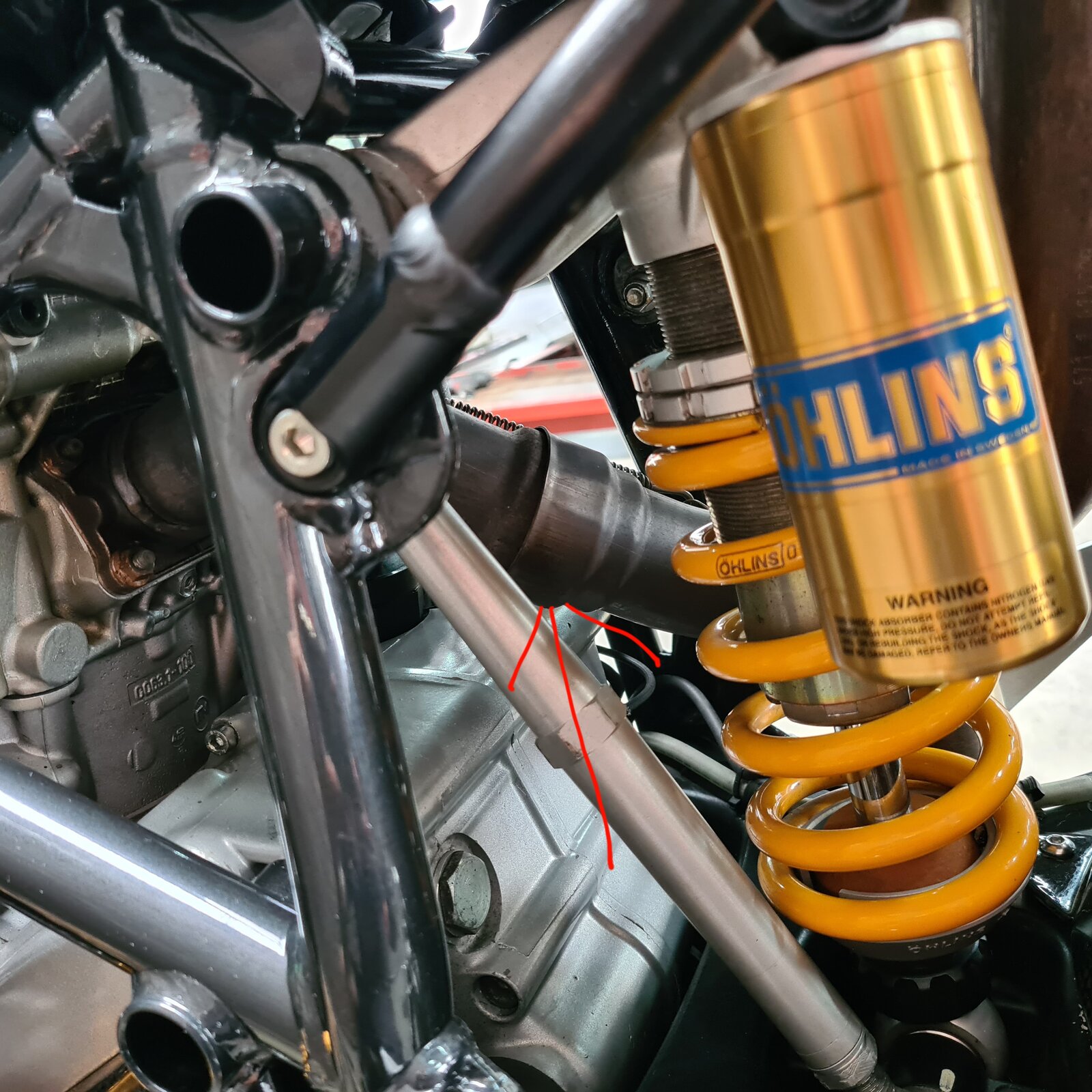

  3. Ok thanks.
    But i cant find the one of the picture with red arrow??
  4. That's because there is no gasket there.
  5. Hmm.
    Ok..thanks. so need a bit joint liquidsealer
  6. Just removed the spring. There was a v ring gasket. Same as the one in muffler and front horizontaal exhaust
  7. i understand. Weirdest thing is.. the horizxontal one has a flange where the gaskets stops en get pressed in.
    On the picture above the vertical one hasnt got a flange. .. but in real life..it has. same as the header of the horizontal one.? why does the picture doesnt show it??
  8. Its the same diameter also. So ordered 3 of them and 1 big one.
    Its the same diameter as the rest.
