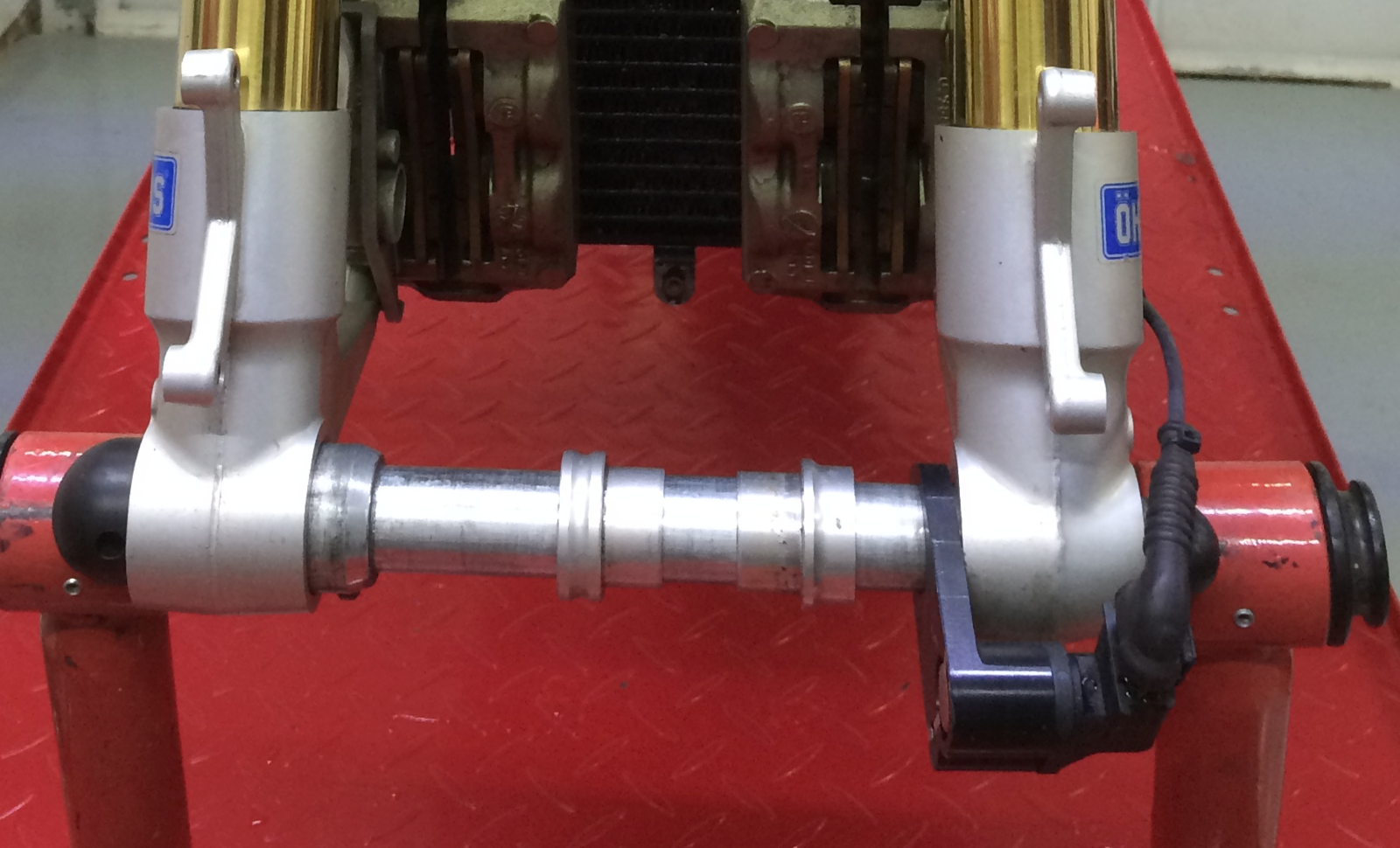

    Here's my sensor with the wheel removed. Obviously the spacer pushes the Nemesis bracket against the fork leg, keeping it in place. My bike also has non standard wheels (BST Carbon)
    So -
    • Have you torqued up your front wheel spindle correctly (63nm)?
    • Have you torqued it up before your fork pinch bolts?
    • Are your pinch bolts torqued correctly (19nm)?
    • Are your wheel bearings running freely?
    • The Nemesis bracket is hard plastic (*Edit, apparently it's alloy). Is it damaged?
    • Is the wheel ring fitted correctly? Is it catching the sensor?

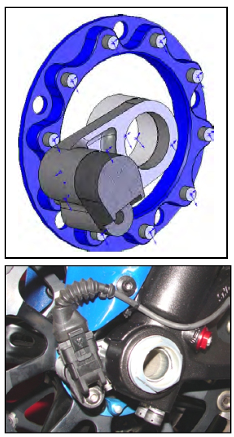

  4. An image from the manual as the bike is at a mates place till the weekend.
  5. Good questions and thanks for the torque values :)
    I'll check all this when I get to the bike on Saturday, but this should get everything sorted if nothing is amiss, as don't believe the bracket is damaged.
    Thoughts much appreciated!

  8. The bracket is ally.
    The clamping force on the spindle nut is enough to hold it in place.
    If it is rotating, something is forcing it around. Check pin/sensor gap. Or even that the inner bearing race isn't seized to the outer.
    I fit mine against the caliper bracket to locate it.
  9. Hmmm, maybe it is. Can't say I've had a great look at it tbh. Makes sense. :upyeah:
