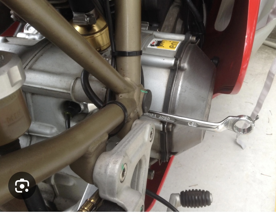

  2. back of the crankcase, in a nutshell. Hopefully it's just a lead with bared wire shorting out somewhere, or sometimes damp will cause this but usually temporary. They are a pain to remove because of the permanent flying lead, but picture shows one method. It can be two-lead or a single lead type, i always preferred the latter for simplicity.

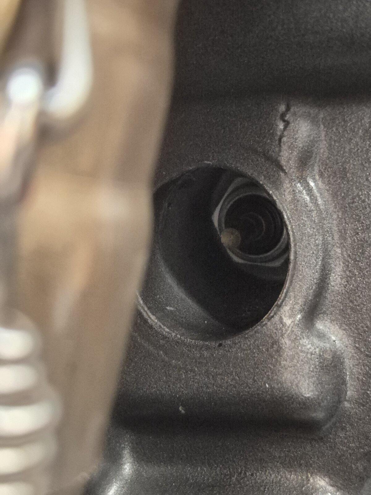

  4. Found it,
    Looks a pig to remove. Don’t see anything obviously wrong so I’ll have to remove it.

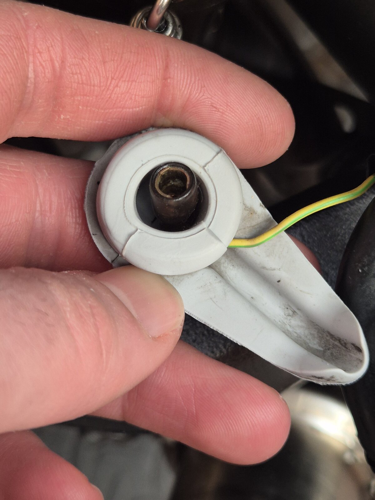

  8. Pulled out the rubber boot, gave the connector a crimp and pushed it back in. Did not work.

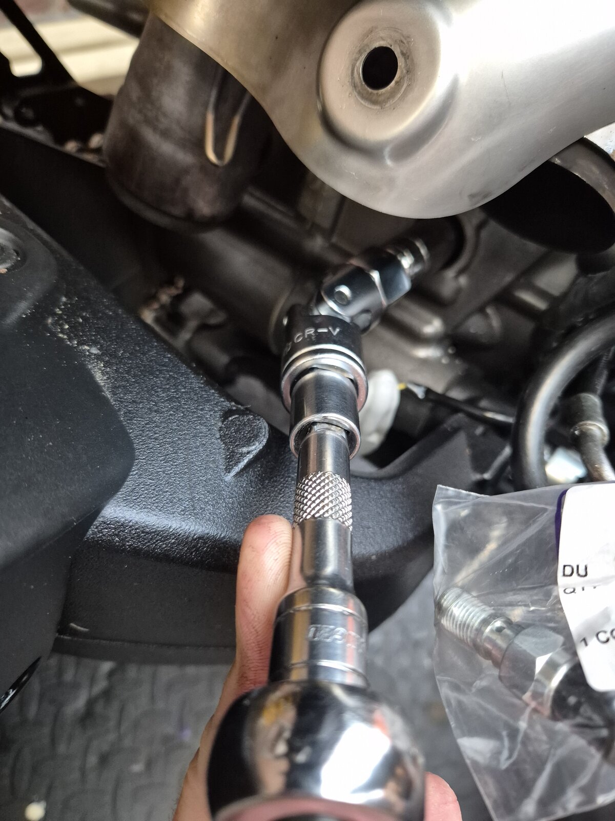

  9. when you say you are positive - all you have to do is earth that wire on to the crankcase with the ignition on to check that the light comes on. :upyeah: As you don't have a flying lead attached on yours, removal isn't that bad, and on most frames a deep socket will do it, or a deep socket with an additional external hex, like a spark plug socket.

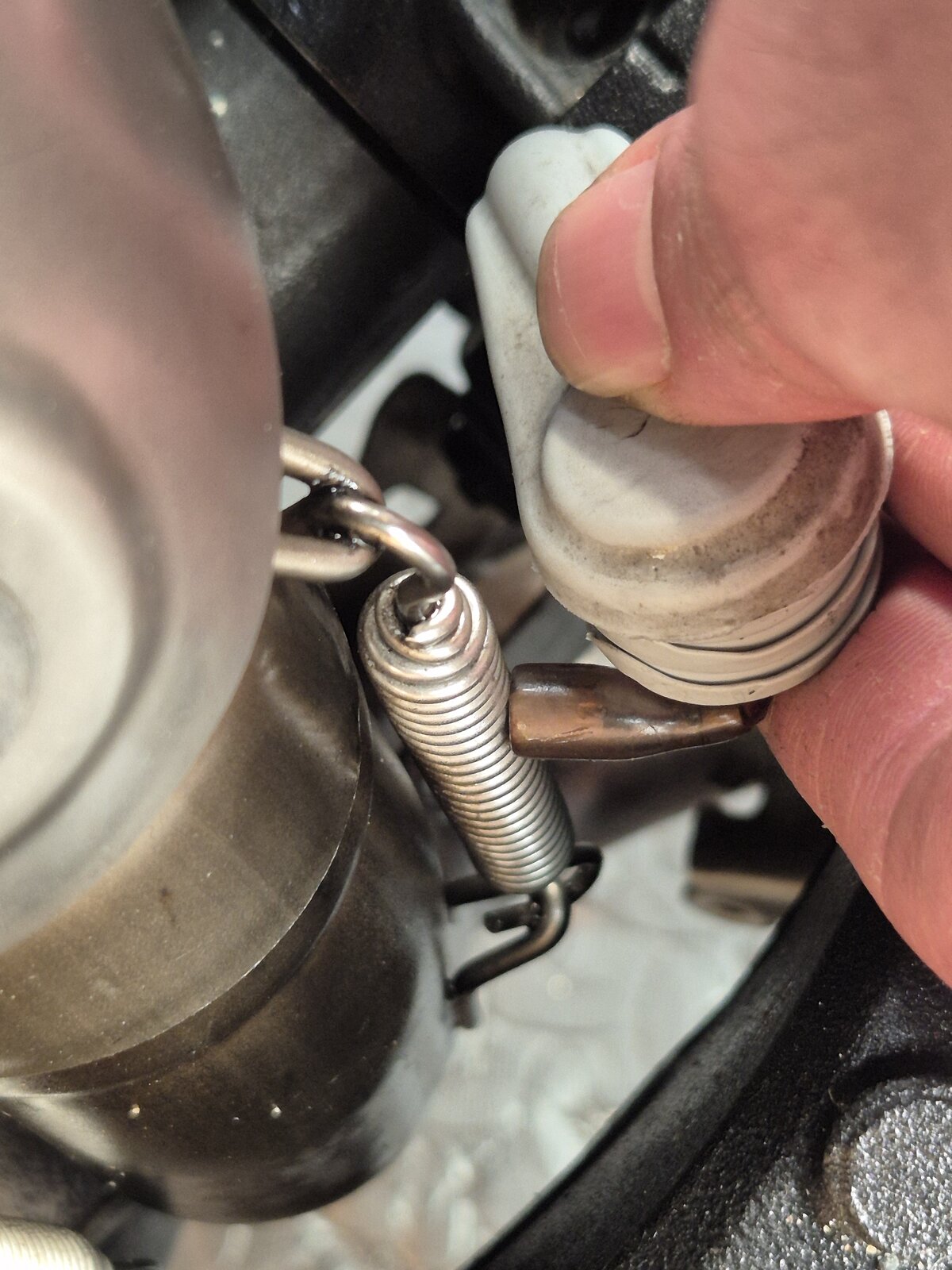

  10. Light on when it touches the spring, light off when I remove it :upyeah:

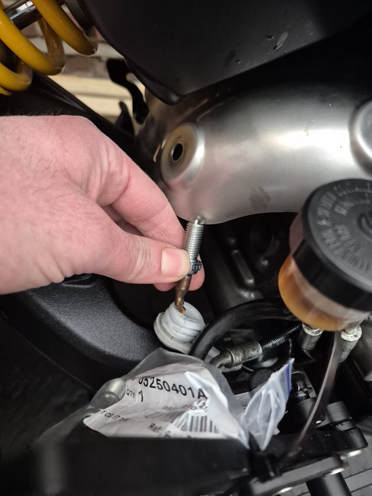

  13. Well this worked fairly easy and it's not too much hassle to remove everything out the way. Ready and waiting for new one.

  14. Removed mine too, it doesn’t open fully, I put a multi meter across the 2 wires, 25 ohms, press the switch 0.3 ohms. It should be open circuit when not pressed. I’ll have to order a new one.
  15. New neutral switch installed. Still no neutral light on dash, but once again with the cable earthed to spring it comes on.
  16. Removed the washer to see if that would help, but no luck. Bike is definitely in neutral. The bike starts with the cable earthed and the neutral light on but not while attached to the switch
