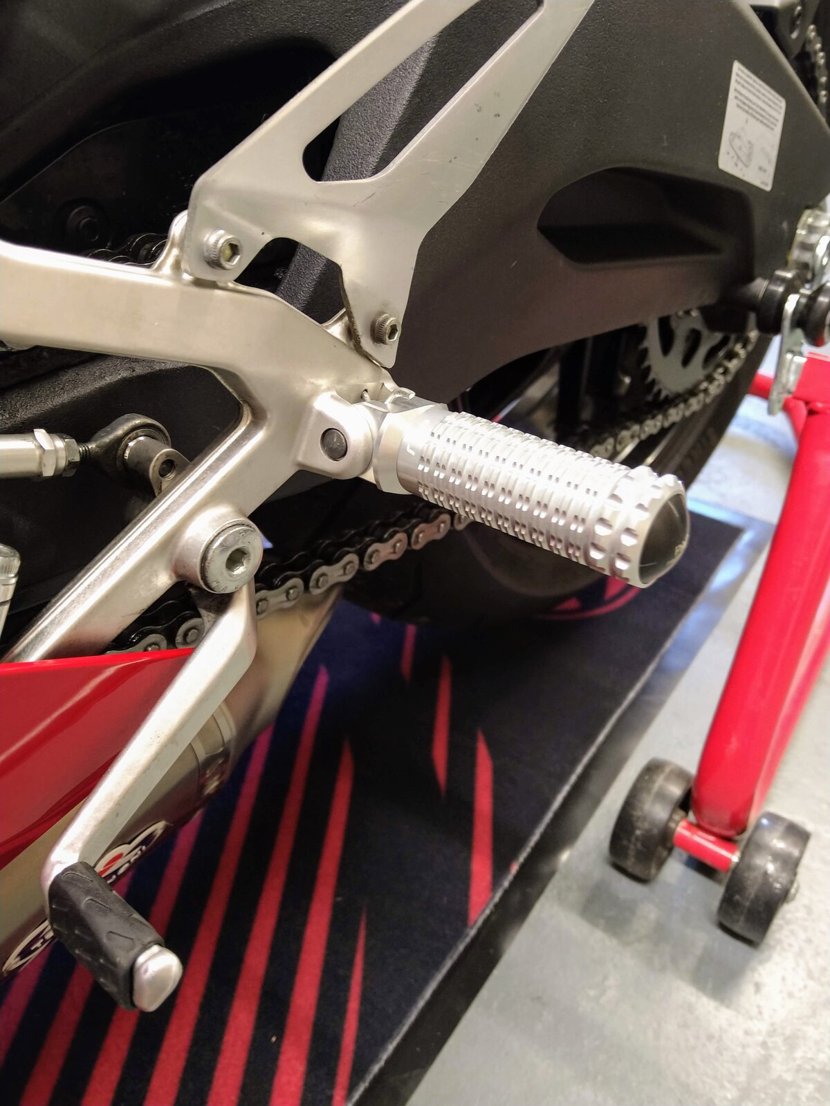

    2) As expected Footpegs are, well pretty s**t for grip. What are people using that are tried and tested? Are the Rizoma ones any good, any one running black or silver ones? Other recommendations?

  2. Do you have the old-style smooth pegs? If so, change them for some from a 1299. Much grippier!

    3) Yes, quite easy, do it ! (another pair of hands help when putting everthing back together, but pretty easy. Its all plug and play. From memory I found a video on Youtube that helped.
    4) Enjoy it, and the admiring glances. Nothing I've ridden gets such a reaction. For me, the Ducati performance seat was a good upgrade, and I also added for touring the SW Motech blaze panniers. I purchased my 899 new, and got it to 34K with no major issues.

  11. Also a new 899 owner here. I've just put rizoma silver pro b pegs on to replace the teflon OEM.
  12. I've got Oberon pegs on mine. No more slippy feet. Use some threadlock; it's all I'm saying. Have the DP led rear indicators too. Far smaller and neater. A doddle to fit.
