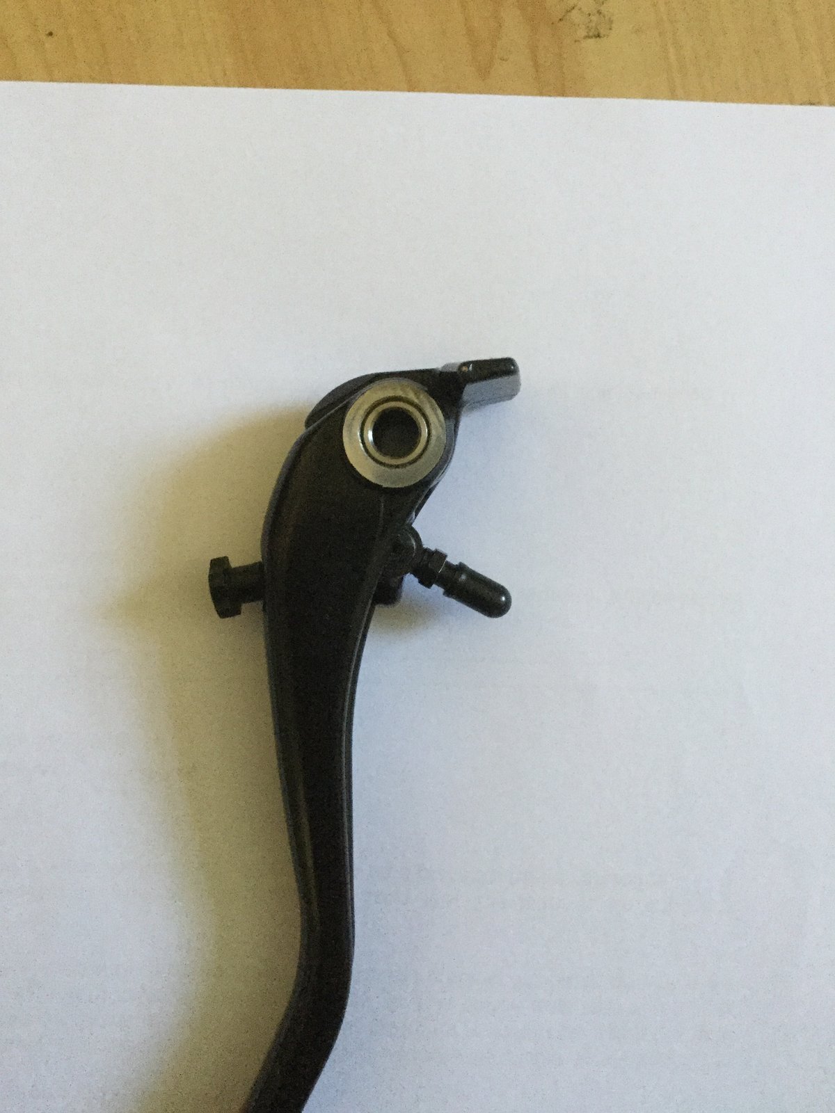

  2. Just looked at my OE Brembo levers and the plunger screws into a small barrel. The plunger is then fixed in that barrel with a roll pin to stop it unscrewing. IMO this not designed to be disassembled. I thought aftermarket levers are supplied with plungers separately, my ASVs and my Renthalls were. Andy

  4. [/QUOTE="Old rider, post: 952053, member: 28306"]I used the oem plungers.[/QUOTE IMG_0203.JPG
    If your OE lever looks like this, I'd be interested in how you removed the roll pin securing the plunger. If it doesn't, my Diavel clearly has different OE levers to yours. Andy

  7. Can you post a picture of your short levers ? Thanks, Andy
  8. Knock out the pivot and the two parts of the lever will separate. I used a 7mm deep socket to do this. Once they are apart you can lift out the barrel c/w the plunger.
    Incidentally the plunger is not held in with a roll pin it is a very small allen type grub screw that needs (I think) a 1.7mm allen key to loosen. Once it has been loosened you can adjust the length of the plunger to suit your new levers, if necessary. Be very careful about this as, if the master cylinder piston doesn't come all the way back, you can get the brakes locked on.

  9. Thanks Derek. Without knowing what short levers the OP tried to fit, I have no idea how much of the plunger subassy he requires. Andy
  10. Thanks for the replies. Used threaded bar, a socket and a couple of spacers and wound it out. New levers are a great improvement over OE, as i could not get the reach to the lever where i wanted it, but now, no worries and the brakes are spot on.
