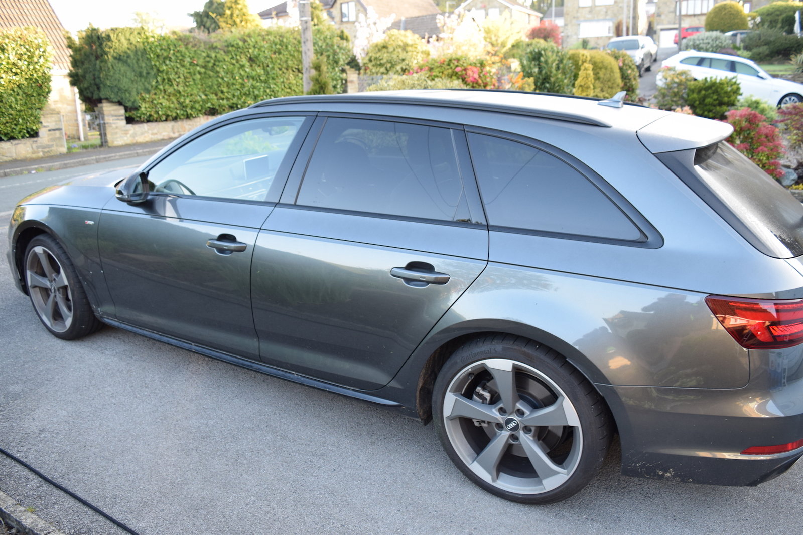

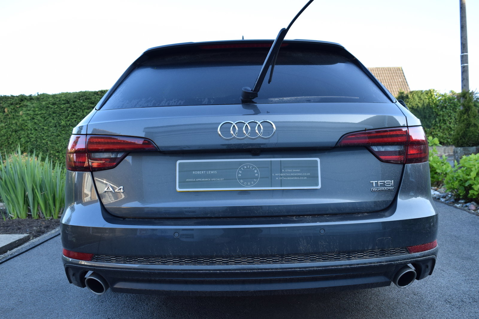

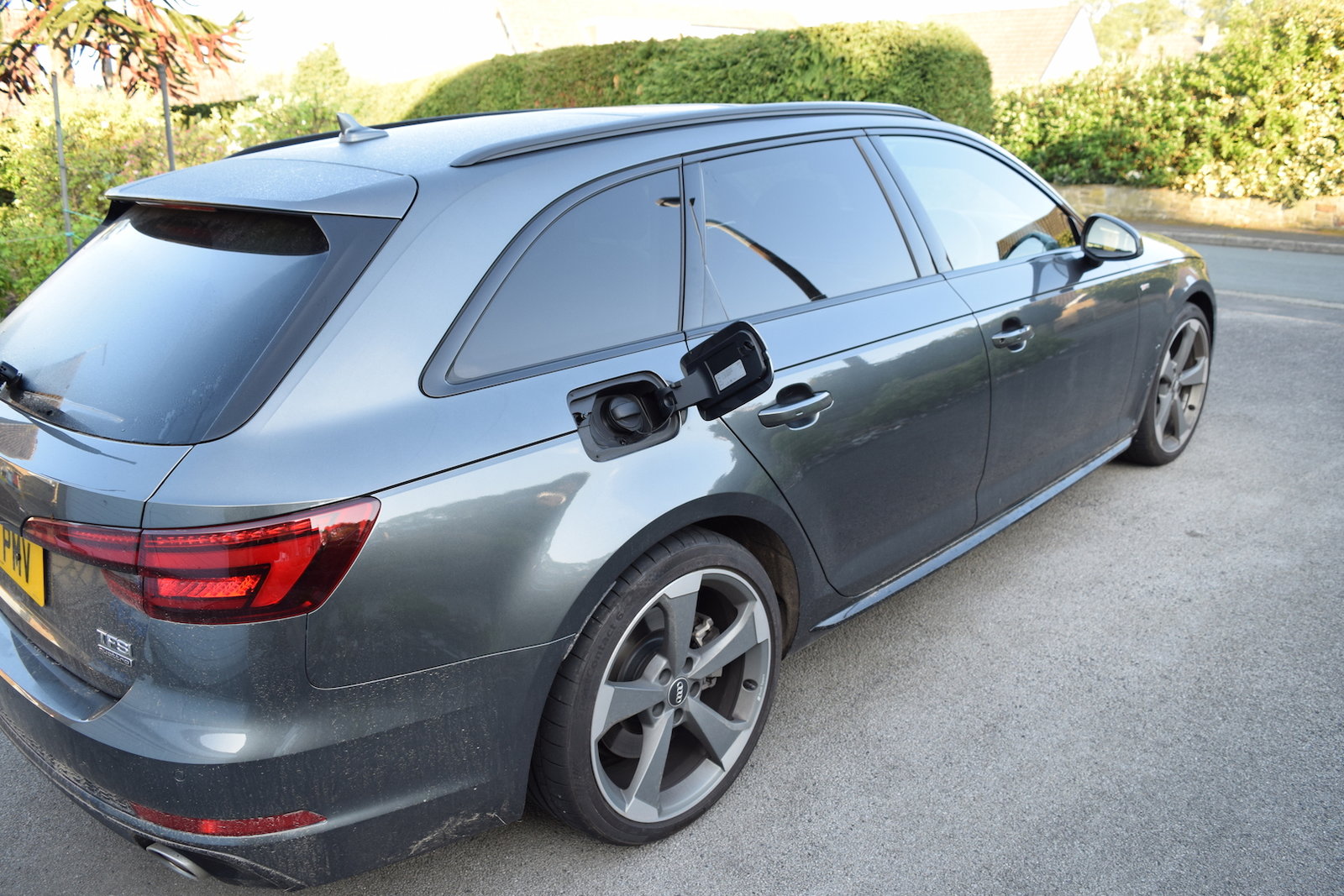

  1. I've been stacked out recently and still am....bookings up to June at present, so it's really difficult to get more details on this forum.....I will always try my best....( really hard grabbing a camera to take shots as you detail as you can't let anything dry ).....

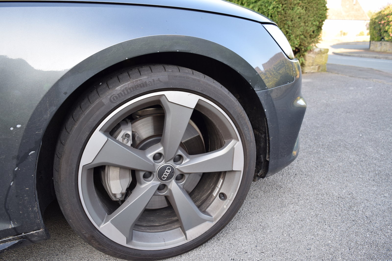

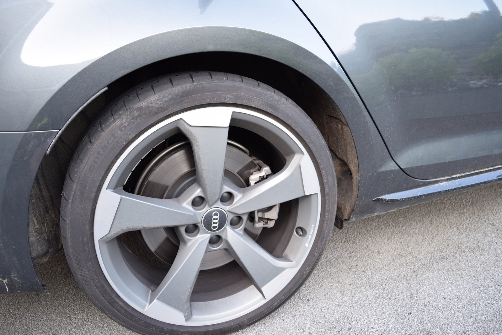

    Anyways my New Car Details are specifically for vehicles under 500 miles as any more miles a more in depth cleaning is required...this one had 1000 miles so took a bit more effort in areas like the wheels and arches to get spotlessly clean.
    Anyways....onto the detail which took me 12 hours non-stop.

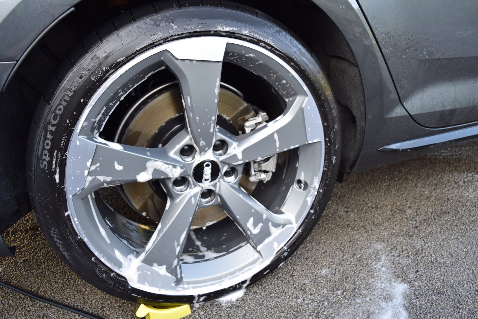

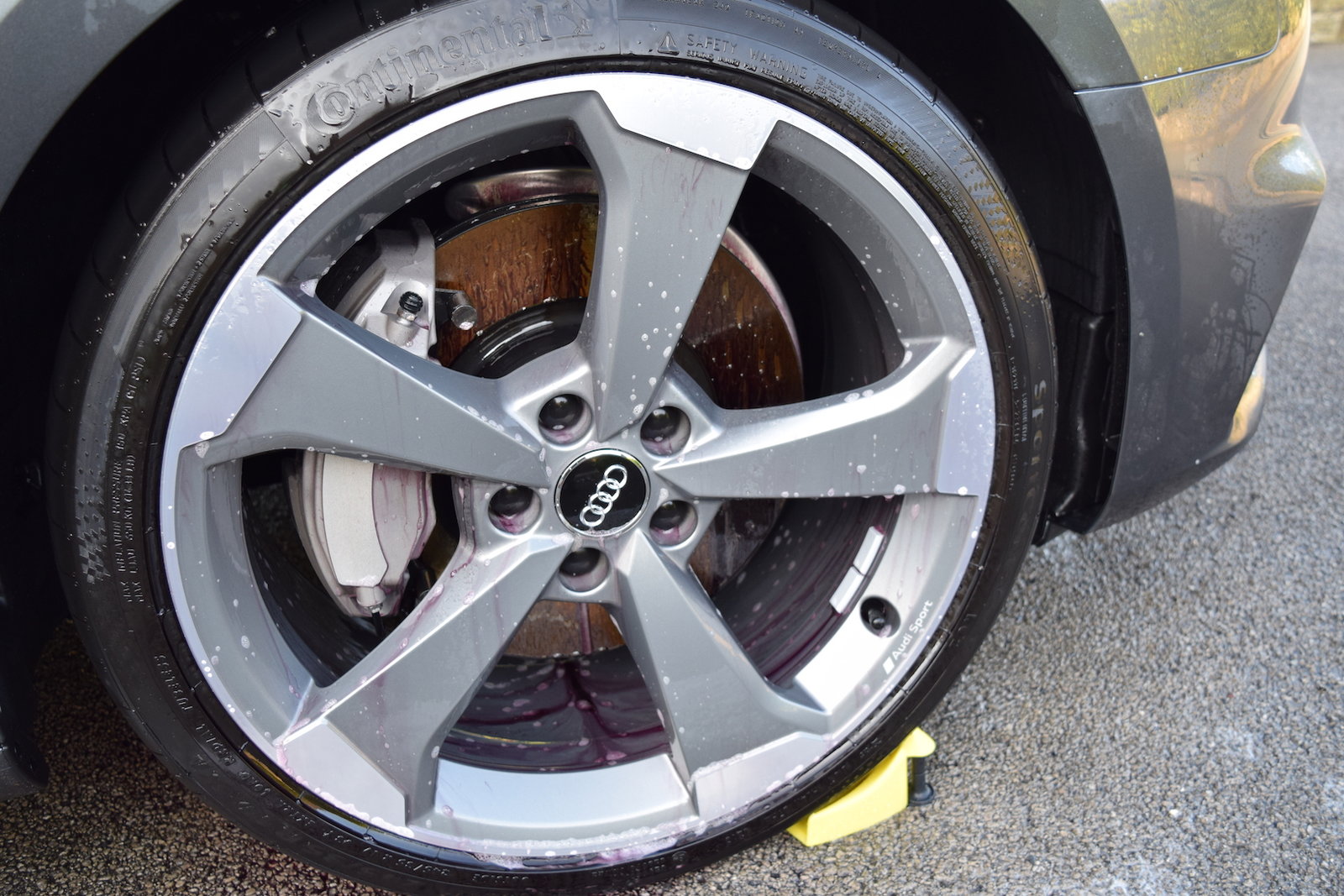

    Wheels attended to first as usual with arches and tyres thoroughly degreased with Bilt Hamber Surfex HD. ( Tyres cleaned twice to get a squeaky clean surface for the application of tyre dressing to bond ) Alloys were cleaned with Angelwax Billberry wheel cleaner, sprayed on and allowed to dwell for 5 mins before being agitated with my many wheel brushes.....all pressure rinsed off. ( dedicated wheel bucket with dual grit guards ). Finally wheels get a further chemical iron decontamination with Bilt Hamber Auto Wheels to remove all embedded iron particulates ( allowed to dwell 10 mins then hi-pressure rinsed off )

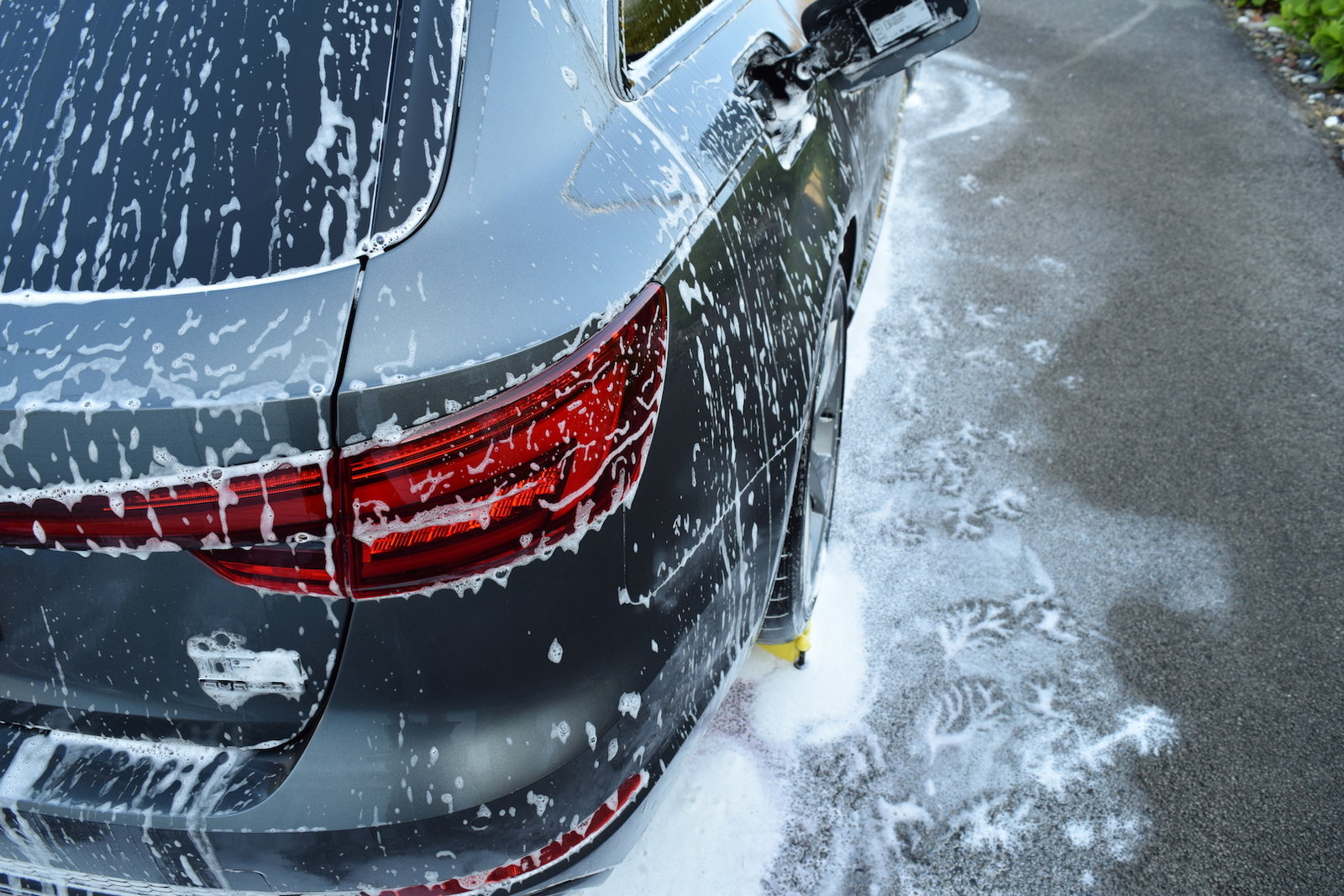

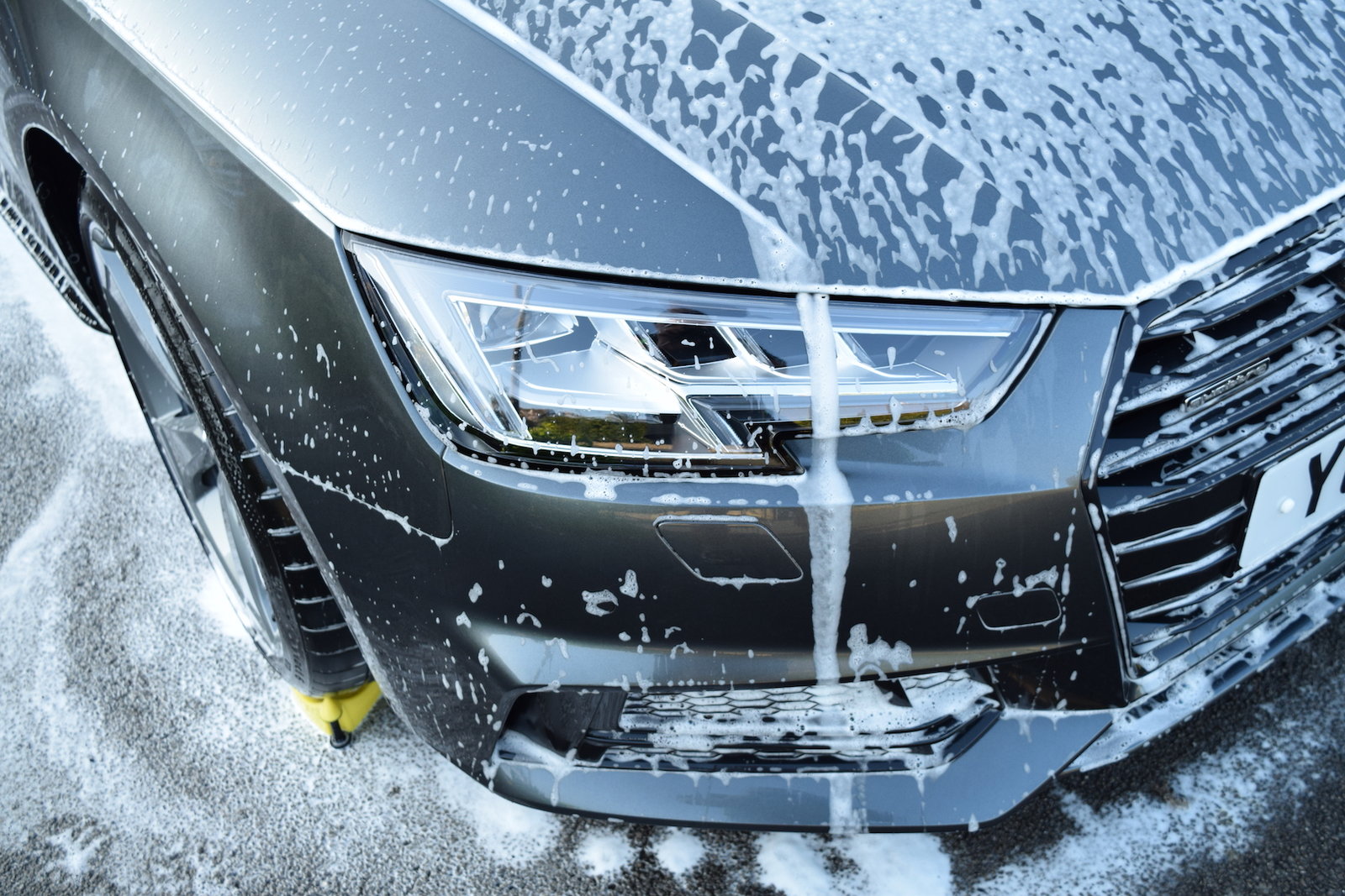

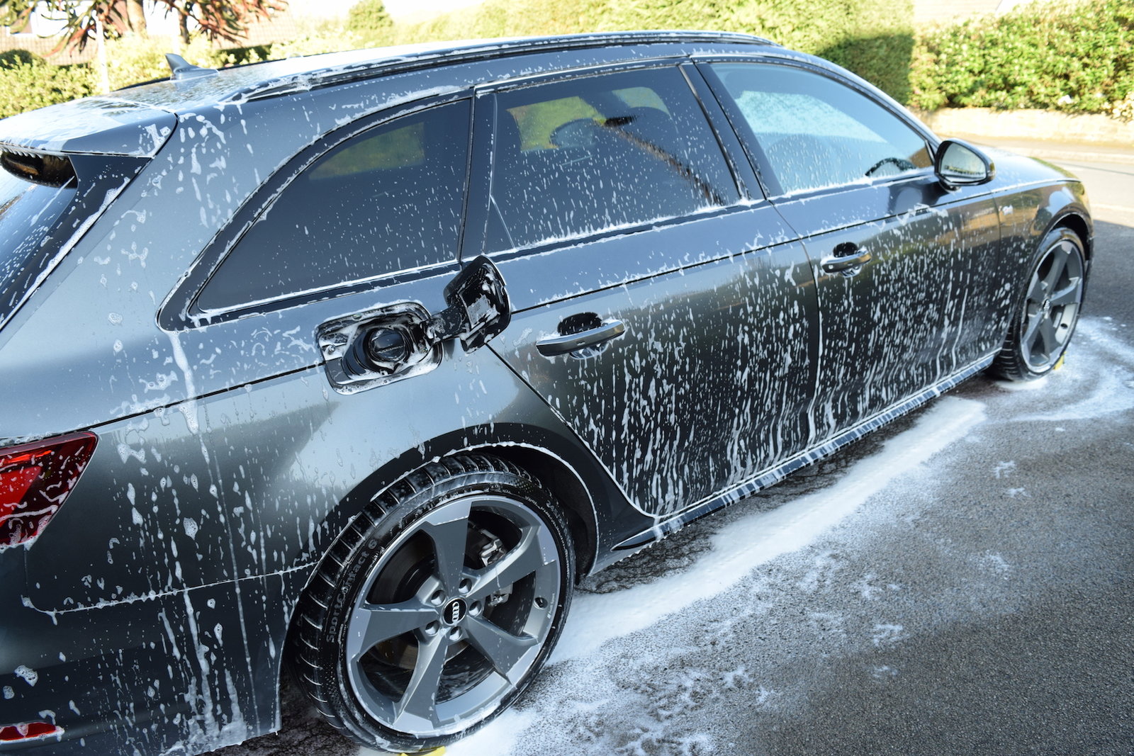

    Next the whole vehicle was bathed in Bilt Hamber Auto Foam pre-wash ( THE BEST pre-wash available IMHO ) and all tight areas agitated with a soft tipped detailing brush. After 7 mins the remaining foam was hi-pressure rinsed off.

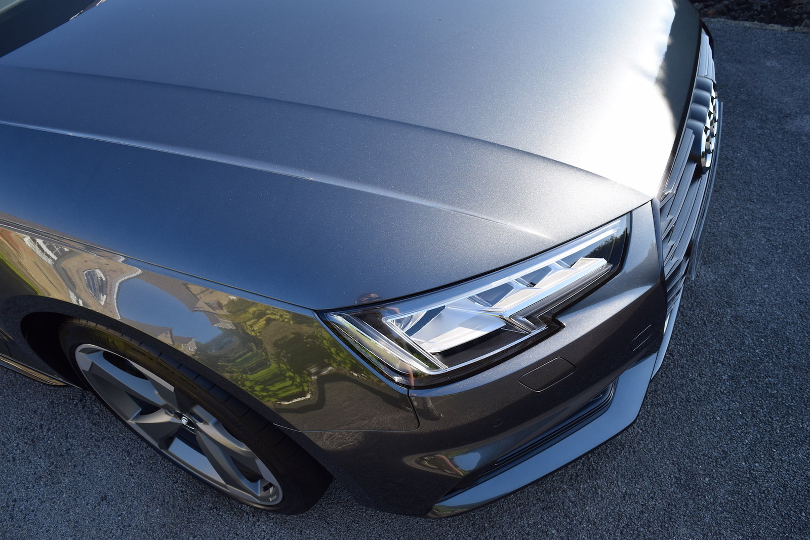

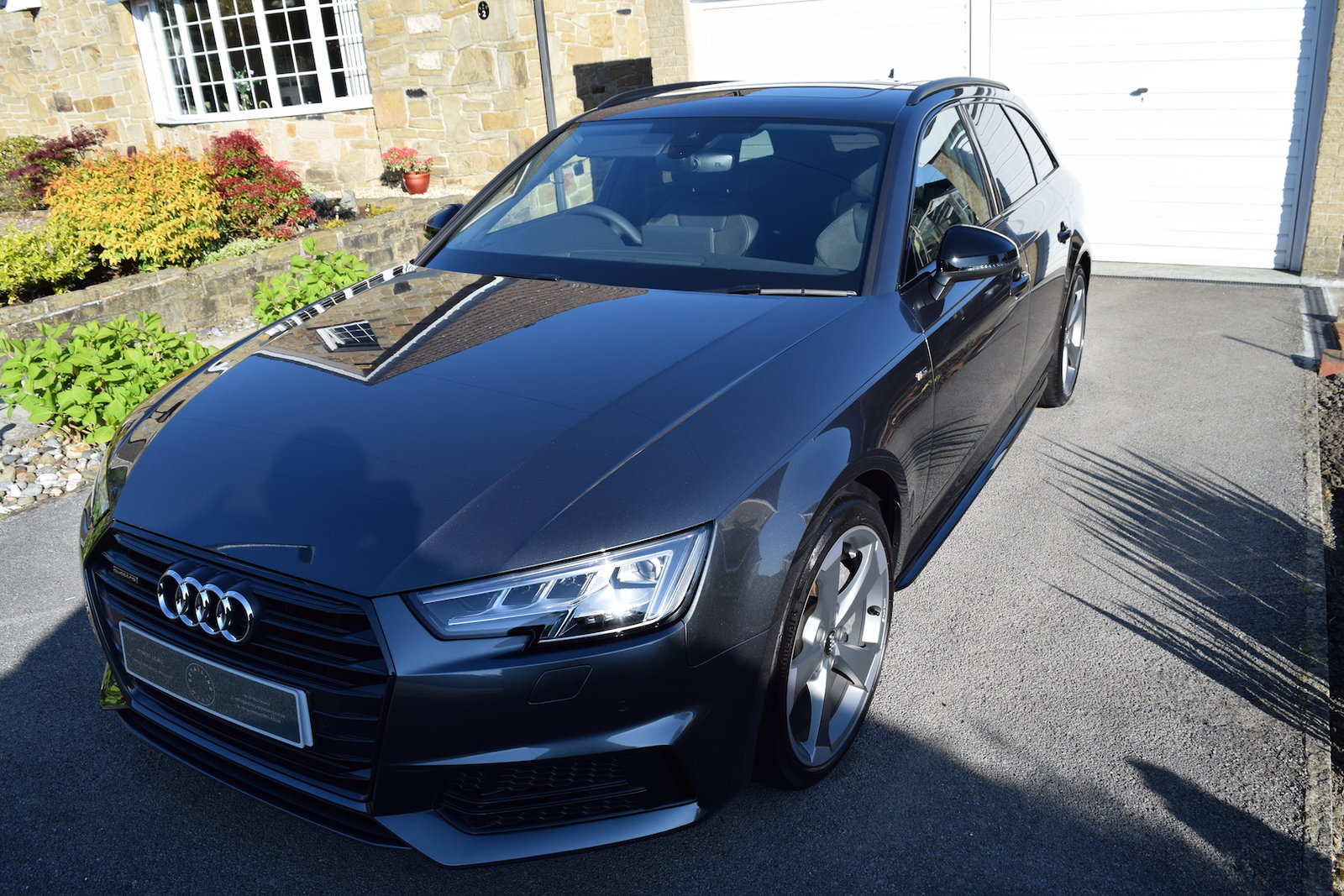

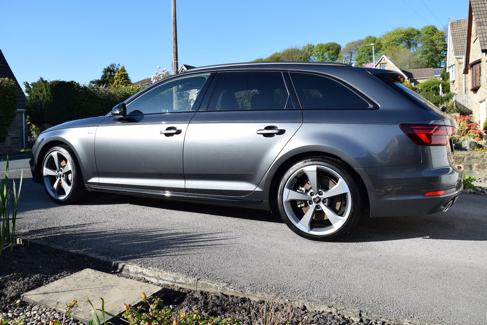

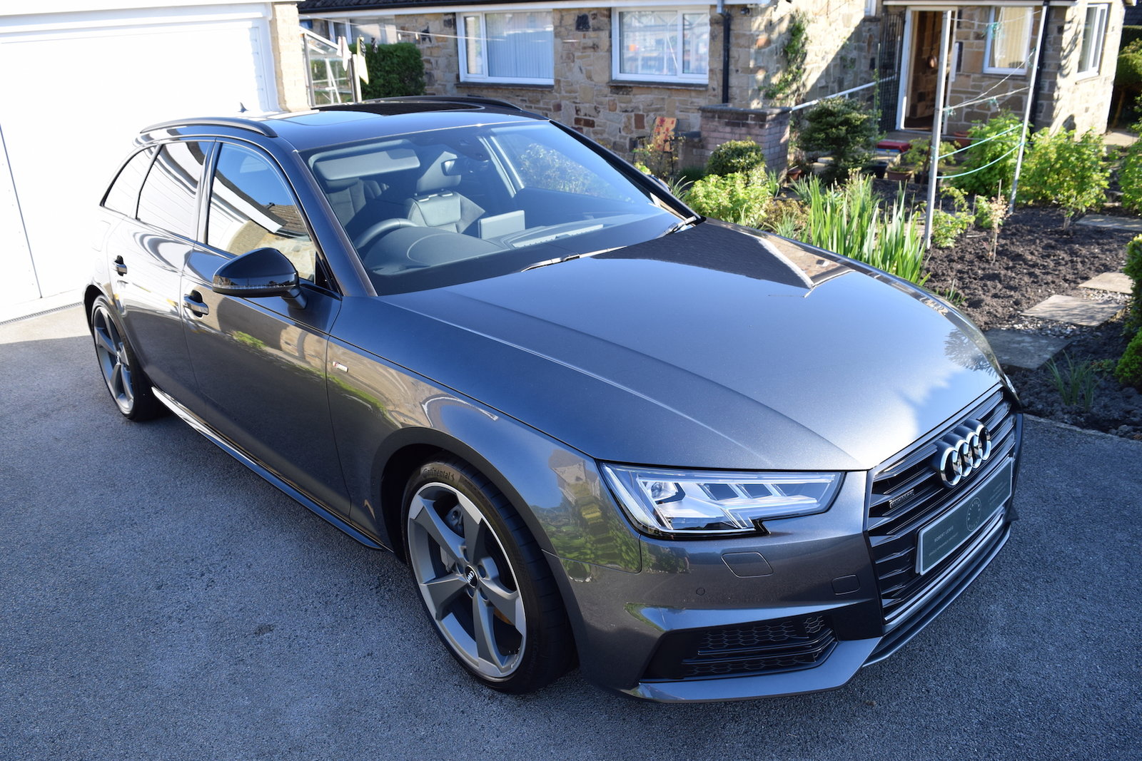

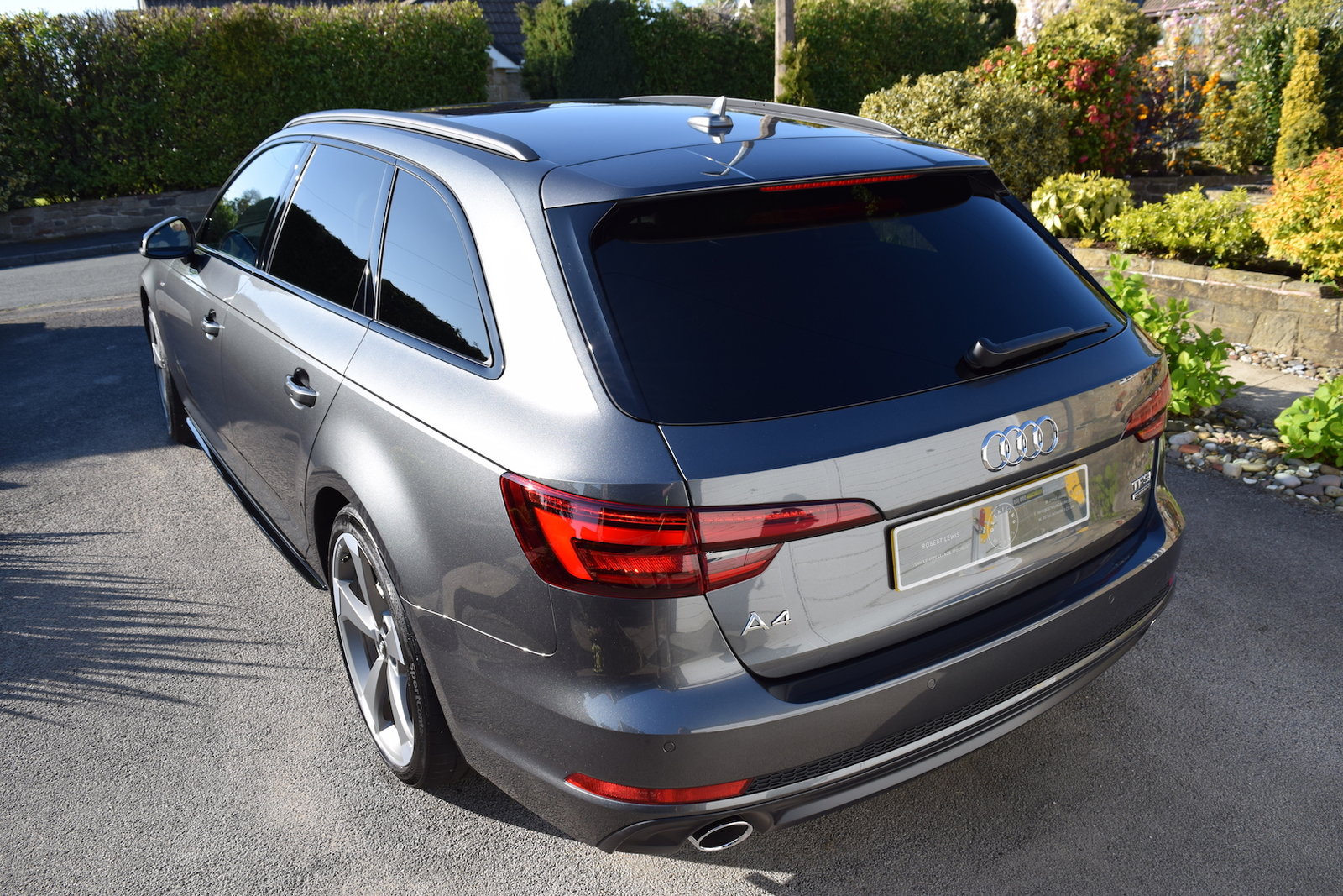

    3 Rupes polishers was used in this detail....a 15MK2 , LHR 75e and the amazing iBrid Nano....Various grades of Rupes pads including Microfibre cutting pads to remove the deeper scars...and a * secret polish....sorry can't give away all my secrets lol...
    Vehicle then panel wiped down twice to remove all polishing oils and to ensure a superb bond for the last step protection which was 2 coats of amazing Nanocoat.
    Wheels panel wiped also and two coats of Liquid Crystal protection applied. Tyres wiped down again with a Panel wipe and a application of superb Gyeon Tyre.

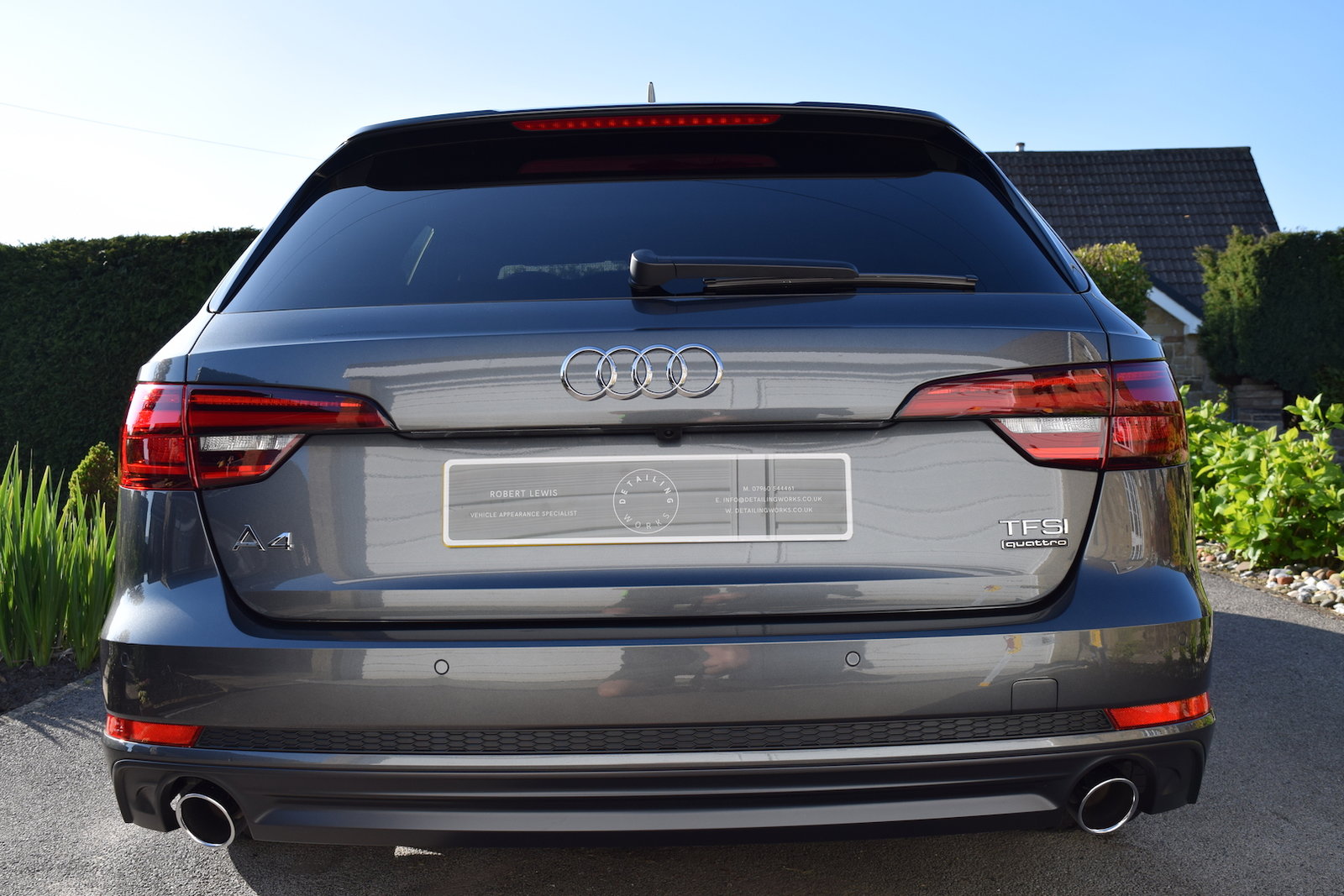

    Finally exhaust tips cleaned and protected.....and my ' Newish ' car detail has finally finished....hope you enjoy this one.
