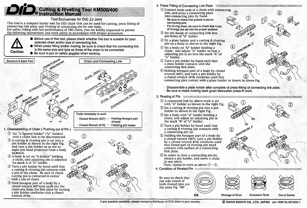

    Note that if fiddling about with a DID chain, you need to use the correct riveting tool - DID KM500R.
    Although there is a lower cost alternative available which does the job just as well.
    Bickers catalogue reference number 5914609, which I think is the Powerite one.
    Apparently when DID upgraded the 520ZVM and 520ZVM 2 (essentially the same chain) to the 520 ZVM-X chain; DID retained the same part / reference numbers for them which unfortunately included the ZJ link.

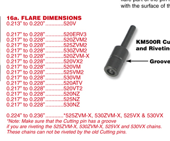

    Anyway my chain albeit was in good condition but ‘out of date’ and the link I required was the old type ZJ link.
    If using a DID chain here is a useful chart for the rivet flares.

    Then comes the riveting...I'd never realised it was such an exact science. I bet most of the places I've taken my bikes to have chains replaced just use a hammer.
    Arquebus...I had a look for the DID tool...most places are out of stock...though I did find one...£114! ...The Powerite version is about £40...much more acceptable..Thanks for the heads up on this.
    I like the look of the 'Whale' chain riveter (£80 though)...you just give it a crack with a hammer...then I read that these are only to be used on 'hard' links and not 'soft' links...Any truth in this?
  5. I use a laser riveting tool, not the best quality but does the job.
  6. If you take a hammer to a DID chain rivet, you may be in trouble.

  7. I dont see why it would need to be the specific DID riveter though.

    I think I'll pick up a DID 'style' riveter...they say they can handle any brand of chain...and see how I get on.
  9. I would suggest that a hammer and centre punch would do the job if you are a) confident b) careful and c) can do it off the bike on a bench (this may not be possible on all models). There is a chance you can cock it up so confidence is key - as well as checking the pin dimensions after twatting :upyeah:
