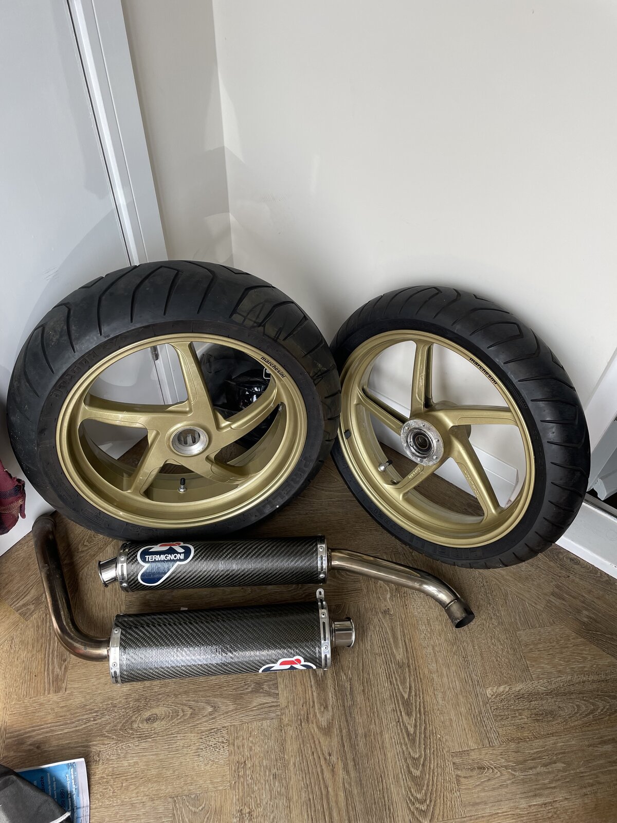

    next up, collecting some 5 spoke wheels and carbon termis…

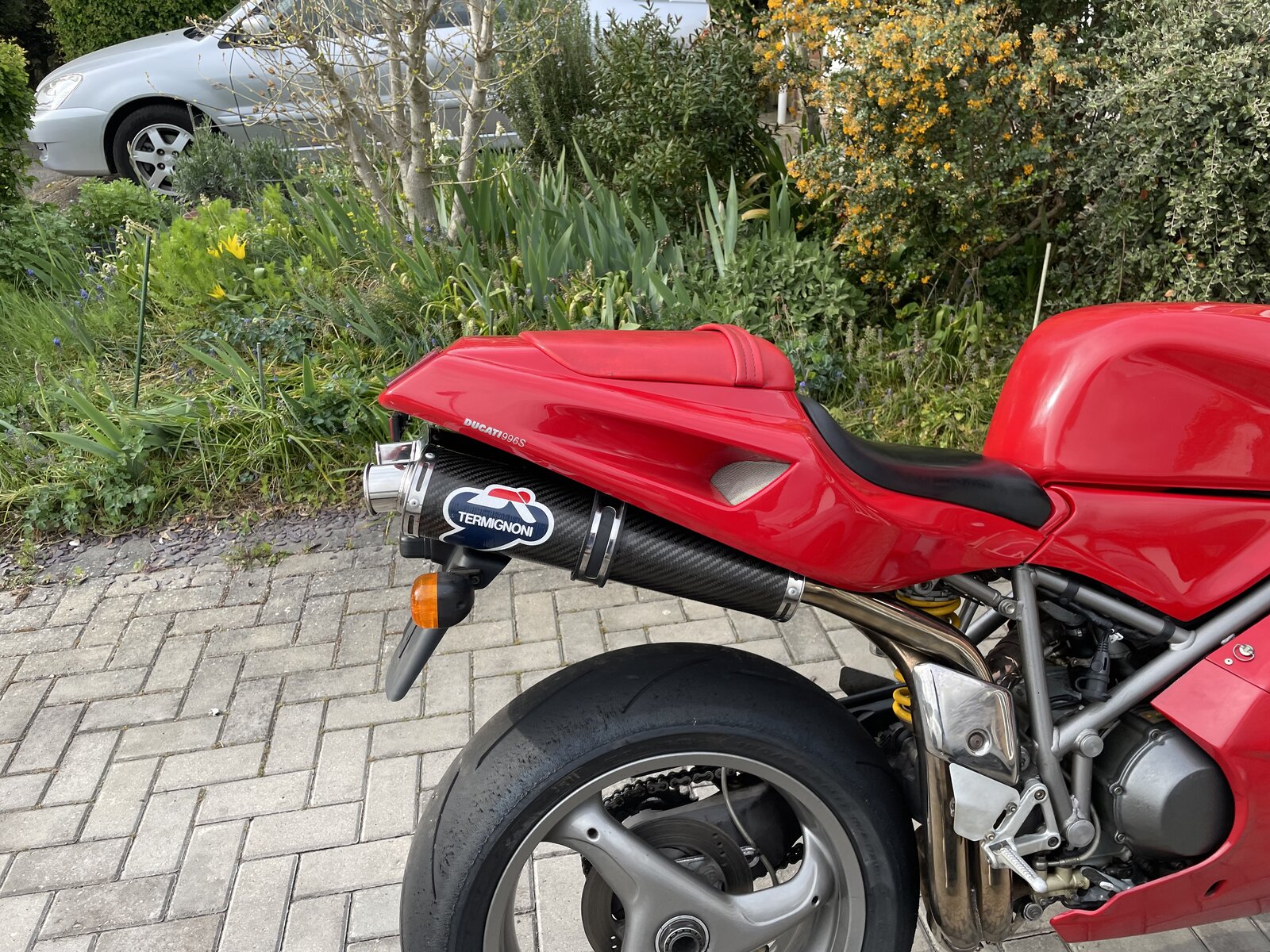

  6. Today bought some goodies…
    Couldn’t resist fitting the Termis this afternoon.. looks way better..
    Wheels will wait until I’ve decided on a colour scheme. Gonna respray the bike and wheels.. in either red, black or….
