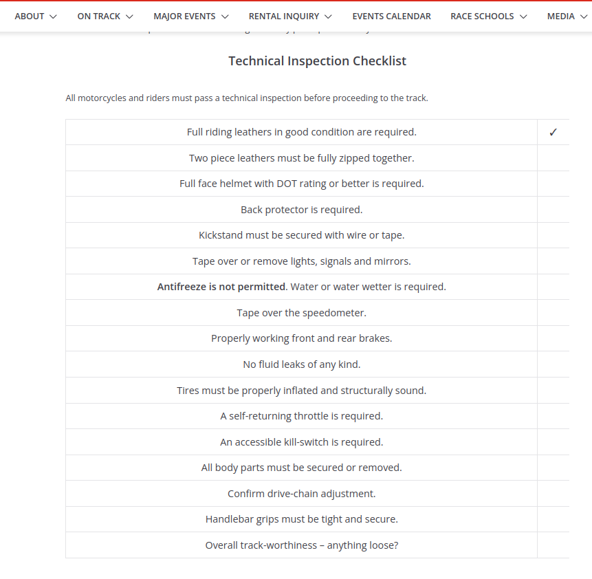

  3. Stock bike is fine. Do your homework about your local track rules.
    If required, replace coolant with water. Remove mirrors and tape your lights.
    Leathers must be one piece or two pieces with waist zipper. Gauntlet gloves, Track boots.
    A Wheel Chock is handy plus items on the attached checklist.

  8. I disagree with this quote because you can't take it as "all encompassing".
    Do your homework about your local track rules. (I've edited my post above to reflect this)
    Please don't be late to the safety meeting and inspection / sound check.
    Our tracks require removal of engine coolant. Water-Wetter additive is permitted. If yours do not, then fine, don't replace it. However, You don't want to be the guy responsible for an hour delay while the track is being cleaned.
    Reason for the safety rule:
    Last thing you want to have happen is somebody crashes and spills anti-freeze all over the track. That stuff is stupid slippery and not easy to clean. All of the track-days in our neck of the woods require this.
    Do your homework. Rules and etiquette. Study the course map.
    Here's a safety checklist of one of out local track. Note that some tracks require you to tape or safety-wire your kickstand as this one does. Having a wheel chock is very handy. Screenshot from 2024-02-12 12-46-50.png
    #8 DarR, Feb 12, 2024
