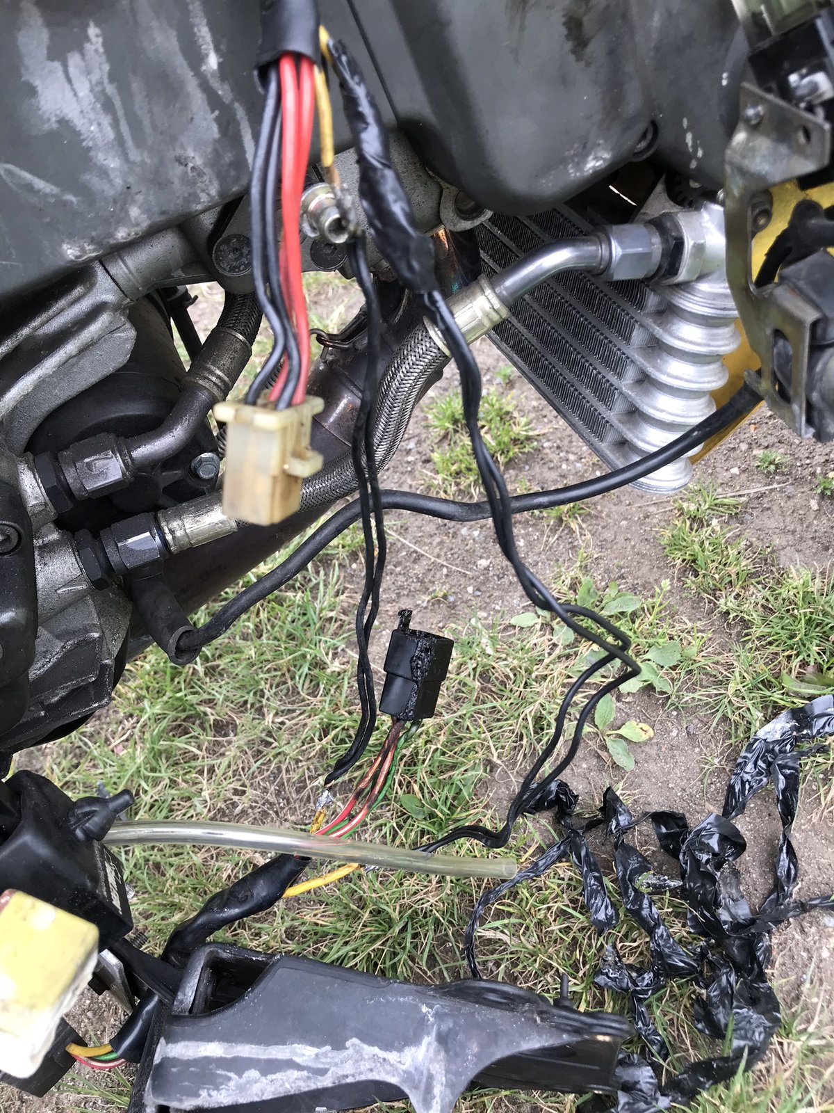

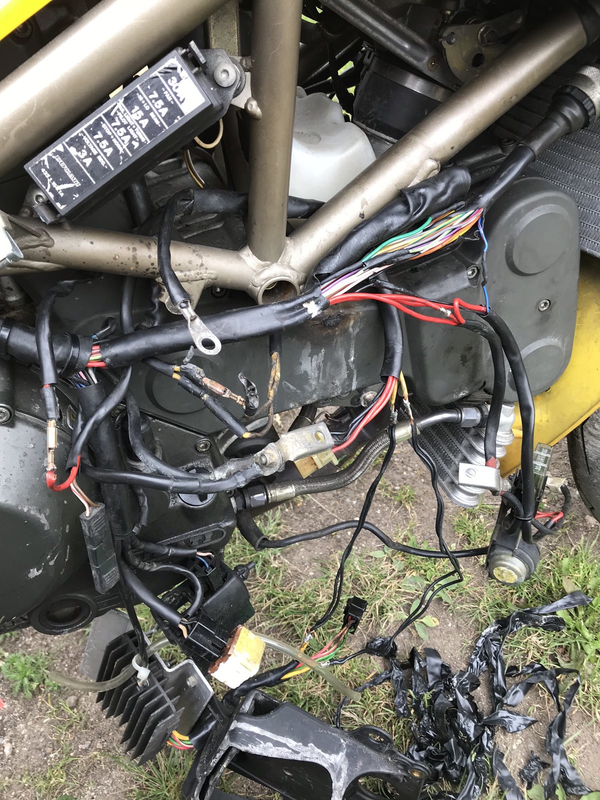

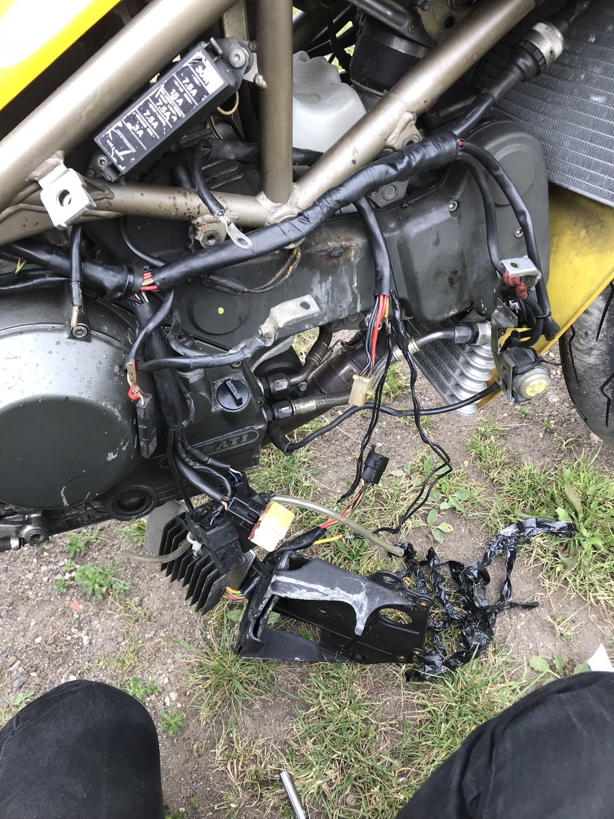

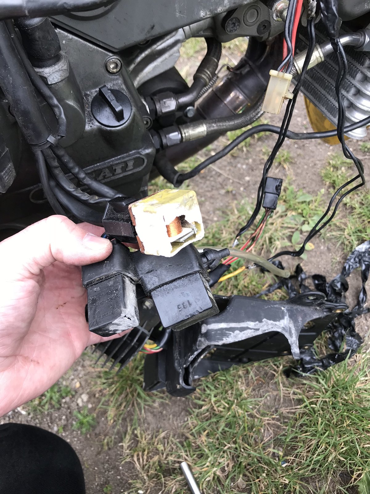

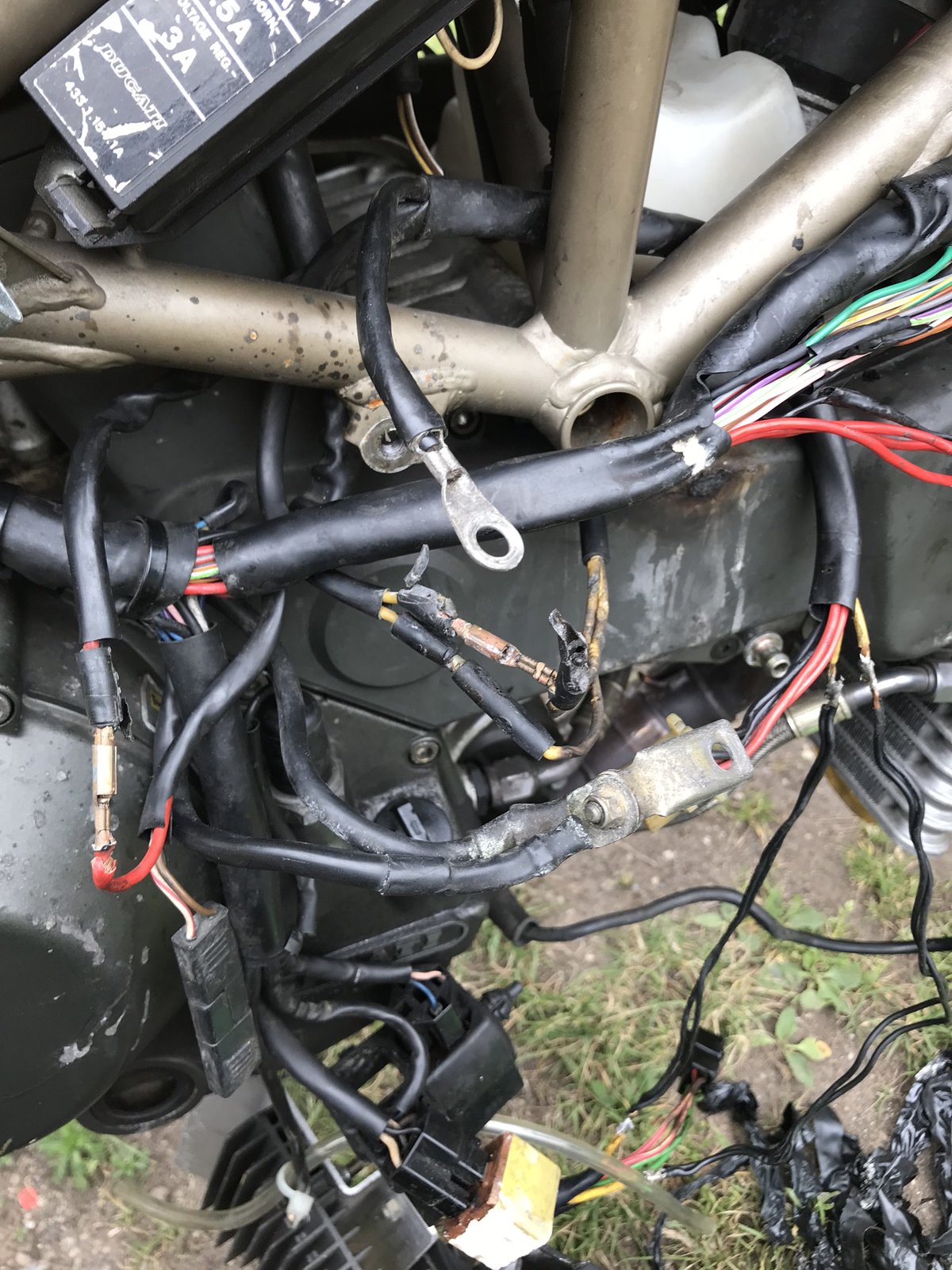

  2. So I’ve started looking into the electrics and I’ve got a fair few issues to address!
  3. Looks almost easier to get a new loom.
  4. I think you might be right, it’s just managing to find one that’s right and is in better condition.

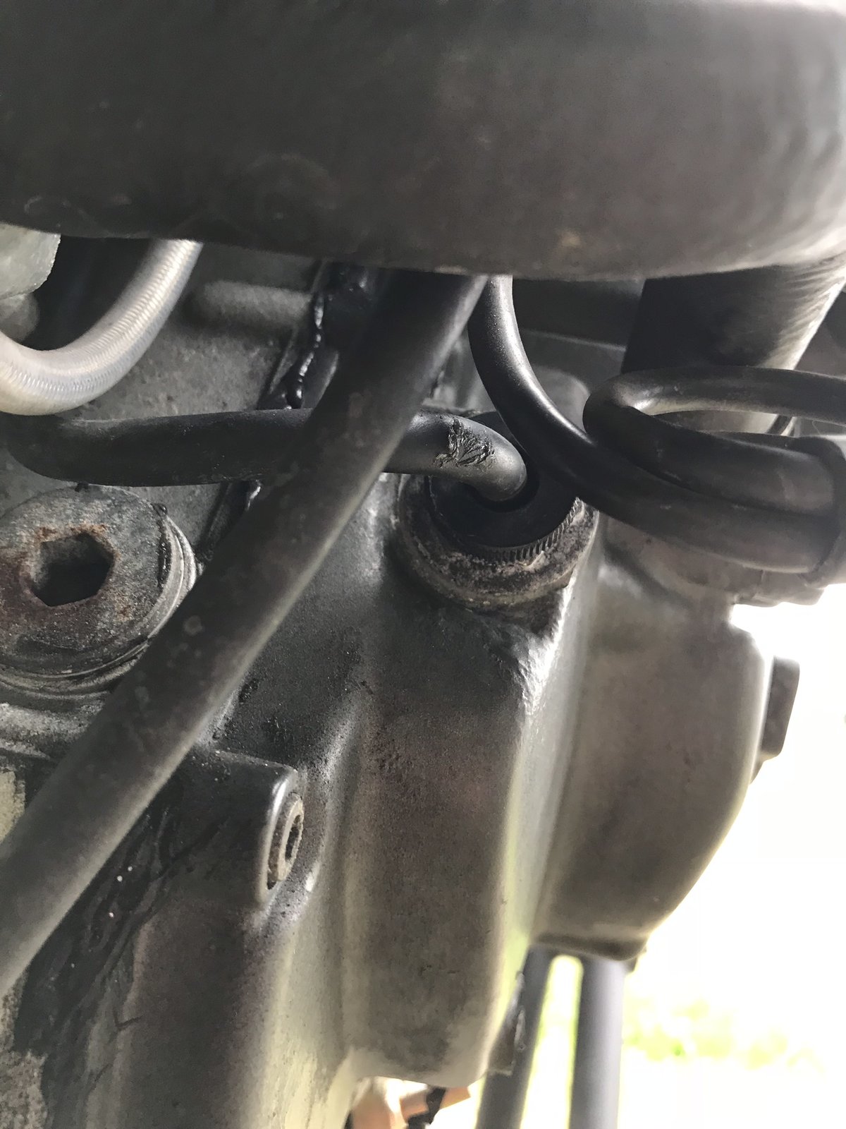

    Any idea what the black wire going through the round plastic plug on the other side of the casing is? Possibly a temp sensor? The wires are pretty melted too

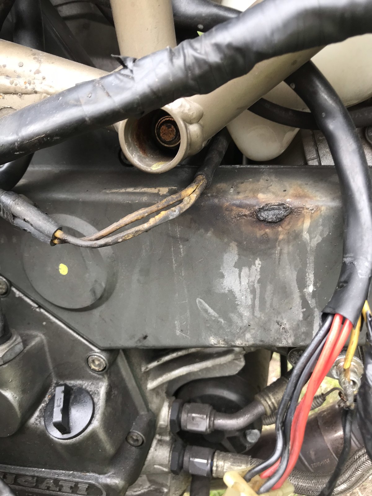

  5. Looks as if it's been bogged in the past, the extension wires connected to the two generator wires in particular, although it looks a mess at the moment, with a little care and patience it shouldn't take long to put it right.
    Good luck.
    Steve
  6. Cheers Steve,
    It has a slight misfire now and then and will cut out if you don’t have a few revs up, this is the first stage of trying to sort that problem out, ultimately it is going to get stripped down but would like to know it’s running sweet before I do :upyeah:

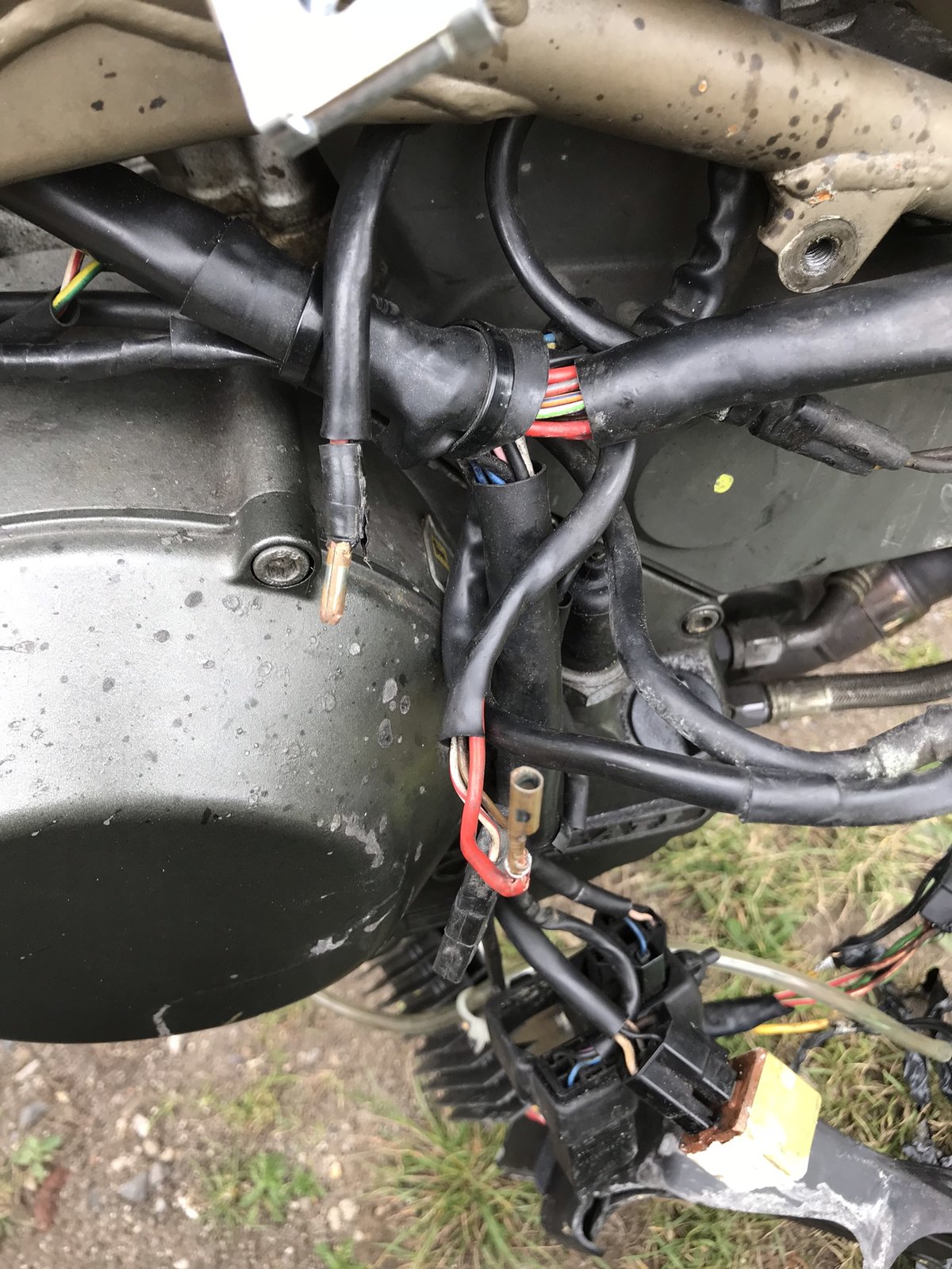

  7. I think that’s the generator wire that plugs into the rectifier below the battery.

  14. I found some 50 amp wire, that would be useful for the generator wiring. I used it to extend my wire so that it is not laying right next to the engine.
    Let me know if you need some and the length.
  15. I'm going to try keep it standard (where possible) as there isn't many of the SP left, I am definitely going to strip the bike once running correctly then get the engine and frame painted the correct colour.
    I would like to buy the mid section loom inc. relays and belt cover where mine has been melted, if possible new wiring from the generator but I think this may be possible to joint through with a bit of care and attention.
    I'm sure I will need other bits but the motor has had a full service two years ago and hasn't done 1 mile since inc. valve clearances, oil, belts, new clutch, new rear disc, new tyres its the electrics letting me down! Also the elusive temperature bezel as that is cracked in the usual spot!
  16. Id still have to say strip to the frame, clean, recoate and re-assemble...its the only way you'll uncover everything...and if you want to keep it standard (understandably) then moreso - my only reasoning from the motogadget angle is that it would simplify and shitty loom to start with..! one thing the motogadget unit does away with is relays!
