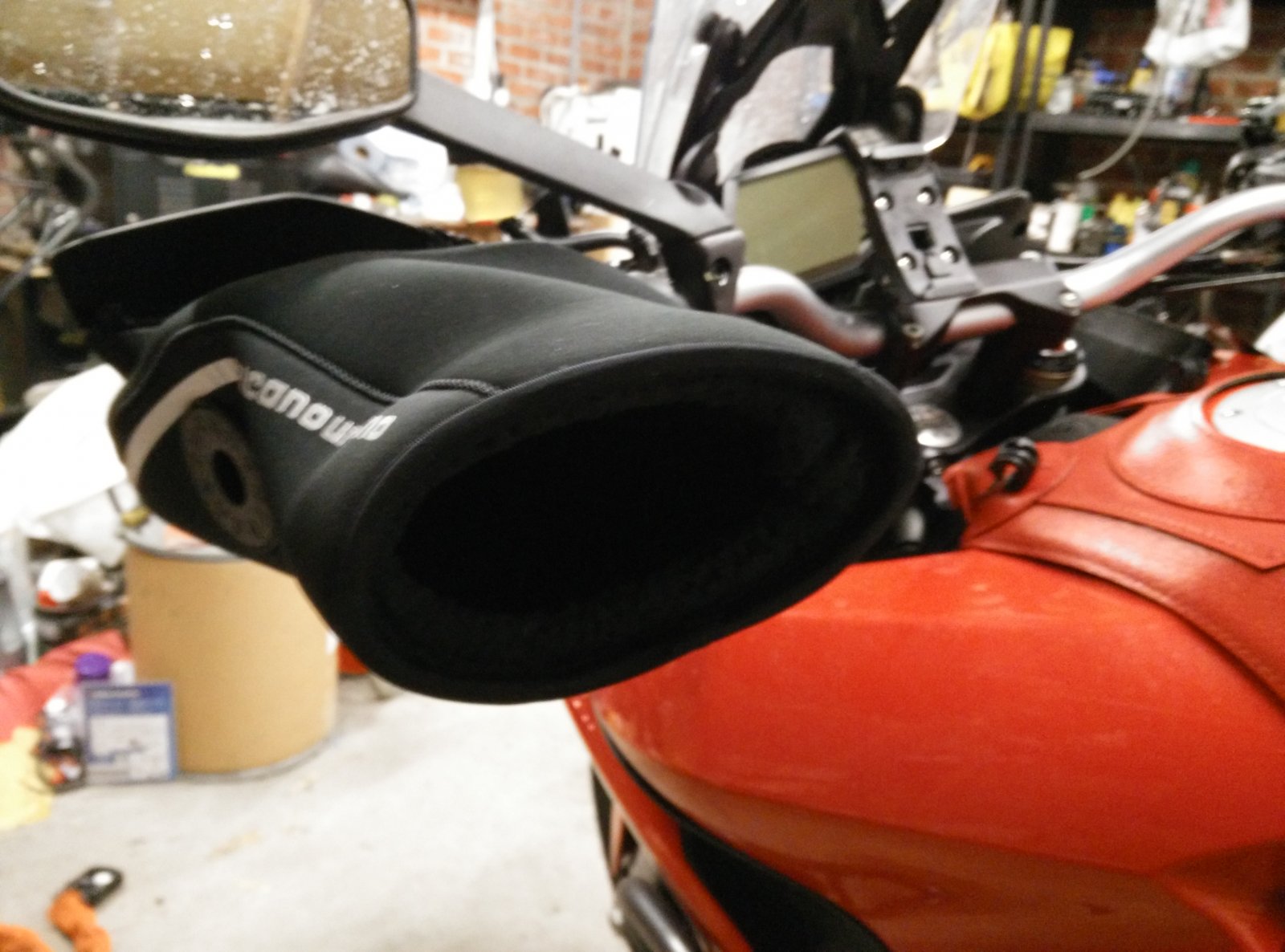

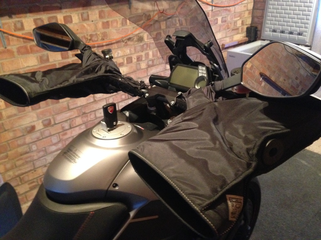

  3. Oh, yeah, baby... that's what I'm talking about. Look at that nice furry muff... doesn't that just look so inviting, just makes you want to slide your hand right in there?
    Summer gloves tomorrow, I think. :Happy:

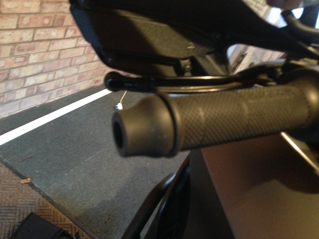

  4. ... and I know it was particularly mild this morning, but I almost had to turn off the heated grips!
    Maybe should have gone for the R360 muffs instead of the R361, which are designed for bikes without bar ends, but I think putting some bar end weights on will keep the muff in place better.

  6. Well, sure, that's something to watch out for, and that's why I'm quite picky about the muffs I choose. ;-)
    The ones I've got have an internal rigid insert which should prevent that happening.

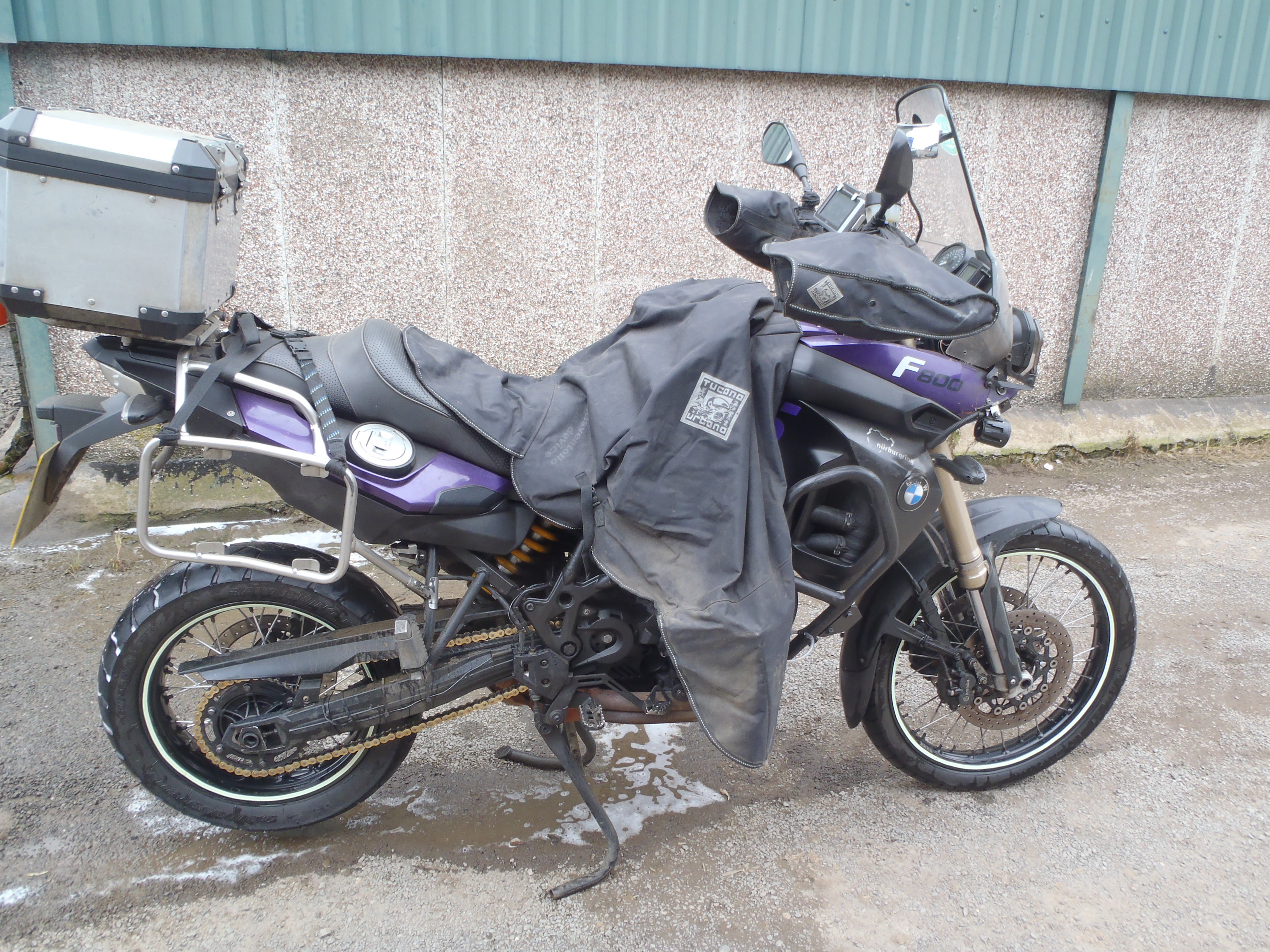

  7. Whilst i like my Rukka Argosaurus, bought almost especially for the MTS, I much prefer the summer gloves inside the Toucano muffs on my F800GS. Now I have seen these I maybe tempted next autumn.

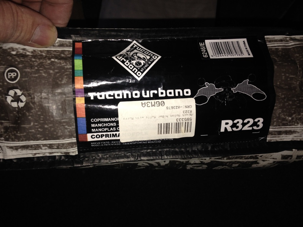

  17. With the impending forecast and the fact I got the keys to a garage today (finally after years of cleaning and working on bikes in the front garden) I gave the bike a decent clean up and got the bag of muffs out of the shed to see if I could make them fit as they are the ones designed to go over handguards on my old GS1150
    first off I thought i had the 319's, i didn't, i have the newer ones that are the R323's doh
    once they were offered up they wouldn't sit correctly so I fitted the spacers that came with the muffs which gave the correct positioning

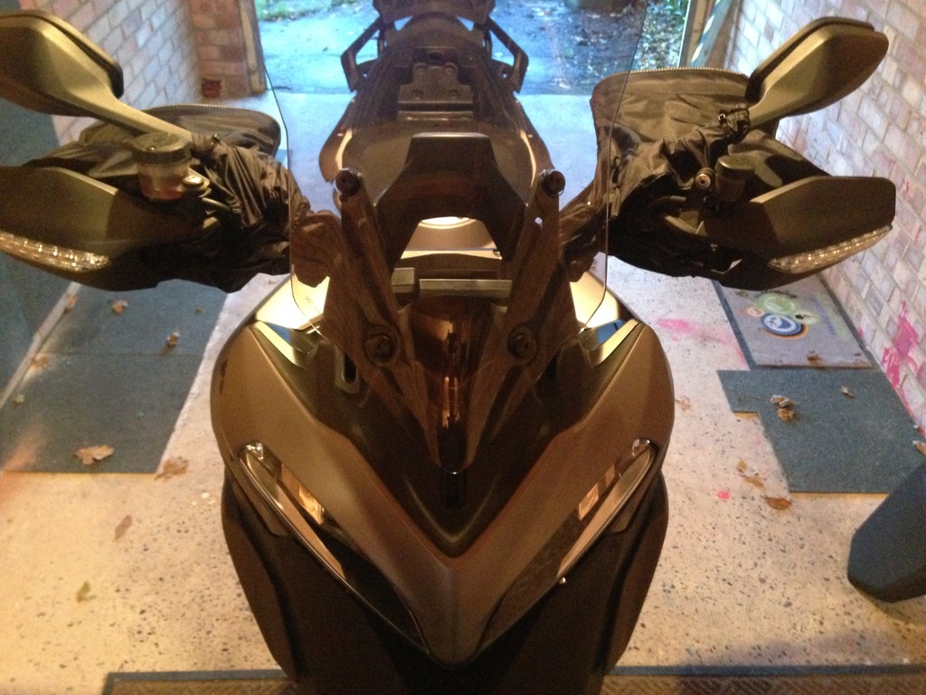

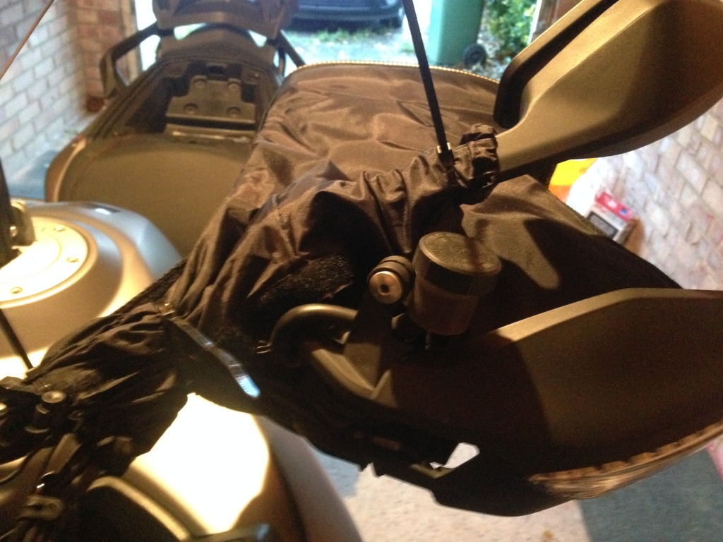

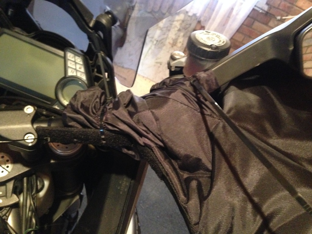

    Both muffs went behind the hand guards but had to go round the reservoirs for the brake and clutch which would normally be under the muff itself but that would also hide the indicators ....bit of pulling about and cable ties seem to have sorted the position
  18. Once that was all done and a bit of tidying up I reckon its not a bad fit. I can still get to all the controls and switches and the hand guards should prevent the muffs being pushed onto the levers
    I think I may have a couple of small spots that will let a draught through but will find out once I get a chance to test it over the next couple of days
