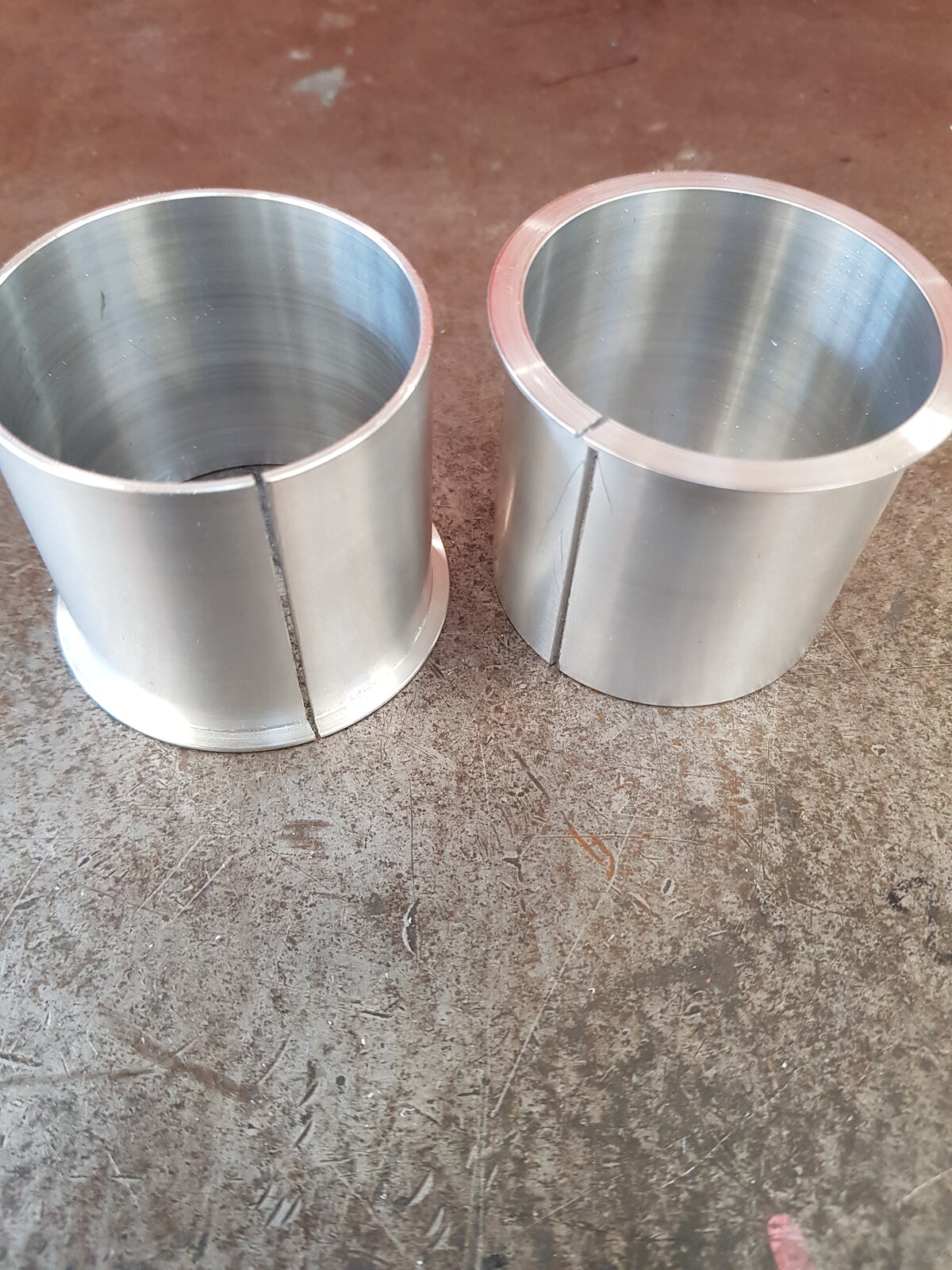

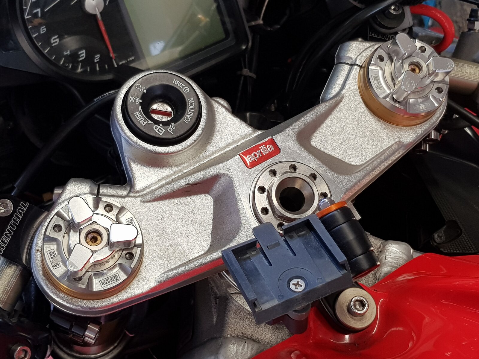

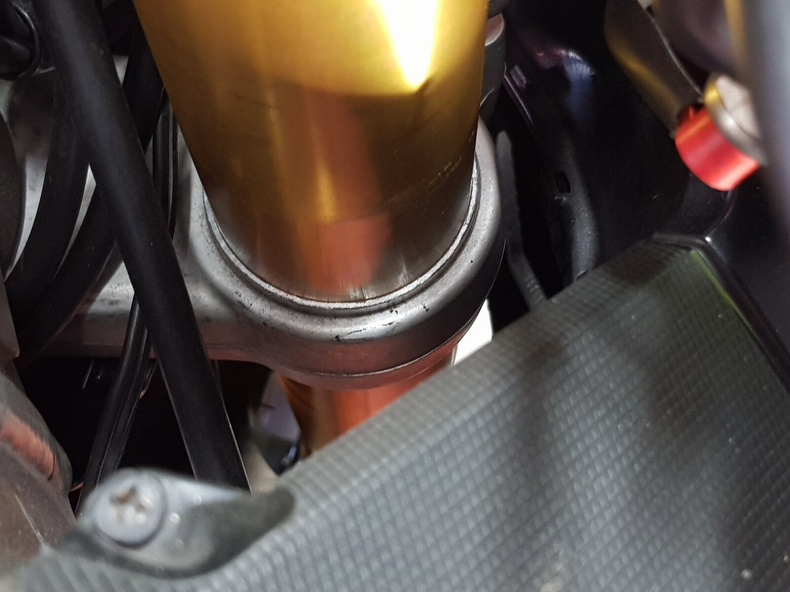

  1. Not sure which way this is gonig to go but thought id put it up all the same. Ordered some showa upgraded NiX30 forks for my rsv4 a few months back....took 6 weeks to turn up then got bent over by customs to the tiune of 300 quid making my cheap set of nix's..not so cheap. Anyway after stripping the whole front off to change them then found out they didnt fit....the ohlins that came off were 53mm the showa's 50mm for that extra kick in the teeth. One of those things were you think - no one probably said this cos everyone knew that...(apart from me)
    So, ive successfully managed to make a couple of sleeves up (1.5mm thick ) to fill the gap meaning i can keep my ohlins based yokes and accomodate the showas (just in case ohlins go back in for whatever reason)
    Temporary sleeves as one of the lads on here hopefully should be able, make me some nice ones with a knurled top so they drop right in.....
    Quite chuffed with myself. Plus i can now flog the old ohlins to go towards these..
  2. The Ducati Corse, 30mm offset magnesium triple clamps were originally supplied with a set of 3 pairs of sleeves to make up the difference between manufacturer’s fork diameters with, I believe, Ohlins being the largest. Well done. Andy
  3. I make them with a little lip on the top to stop them dropping through.

  5. Those are the same as the ones in my bottom yoke. It’s the top yokes which are the problem for mine. I think the diameter difference is either 1 or .5mm and fitting them in is a nightmare.

  7. how much does one charge for such things?
  8. If you need to ask :D
  9. well you know... politeness and all that!
    I'm in need of some you see...
    We likes them precious.. we likes them..
    to sleeve a 56mm bottom yoke to fit a 53mm forkses precious...
  10. I know - i pm'd within about 30 seconds...a million times better than my shit arsed attempt but they do the job for the moment...
