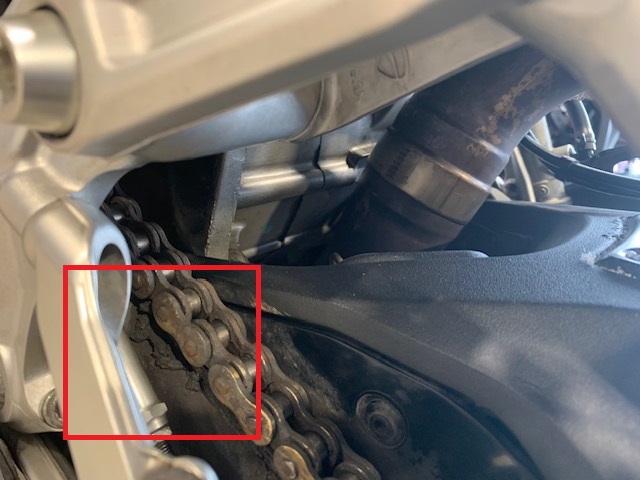

  5. The bike does have custom fairings and some custom parts, I'll drop a link below - maybe someone can spot something that would give some more information of the history of the bike away? Also, I asked the shop to send me some more pictures of the exhaust pipes to figure out whether it's a full system or just a slip on, and noticed a corroded part, which I can't identify - I highlighted it on the pictures attached. I think it's a swingarm? Big red flag?

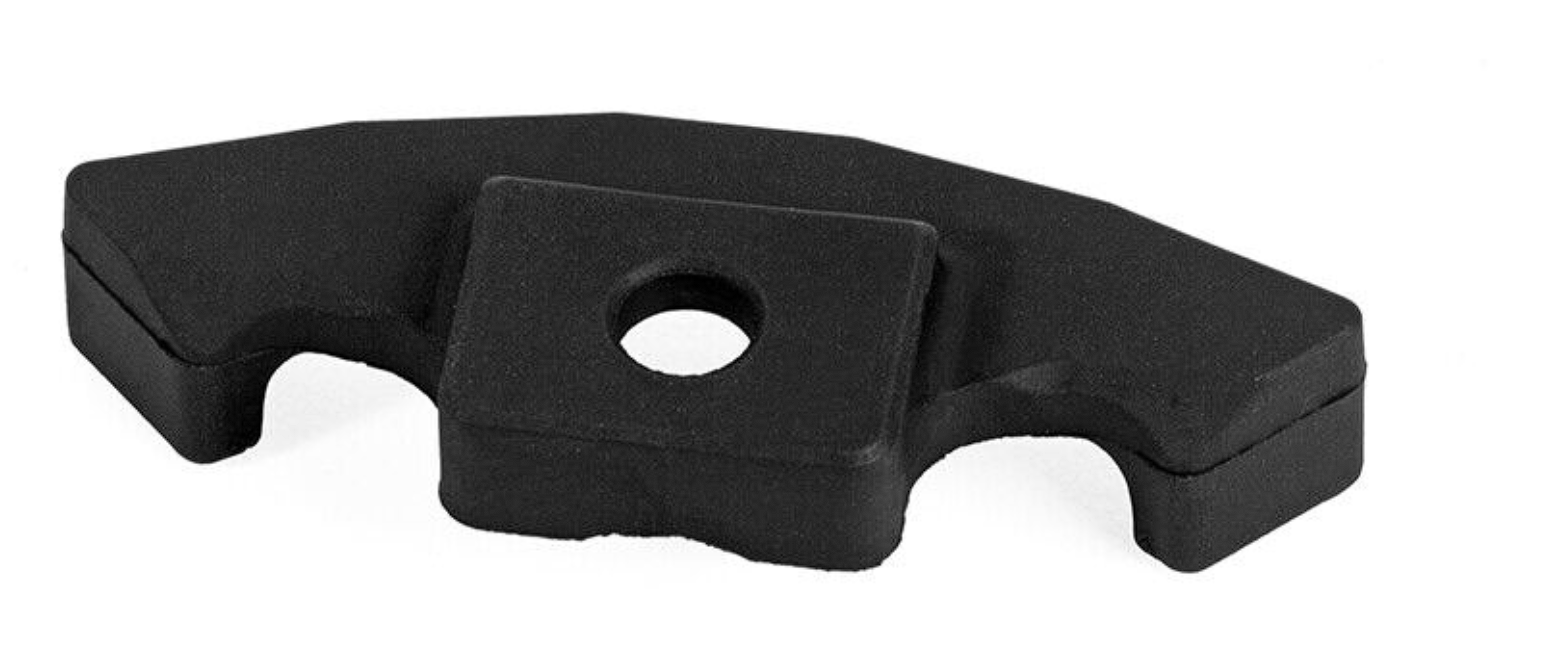

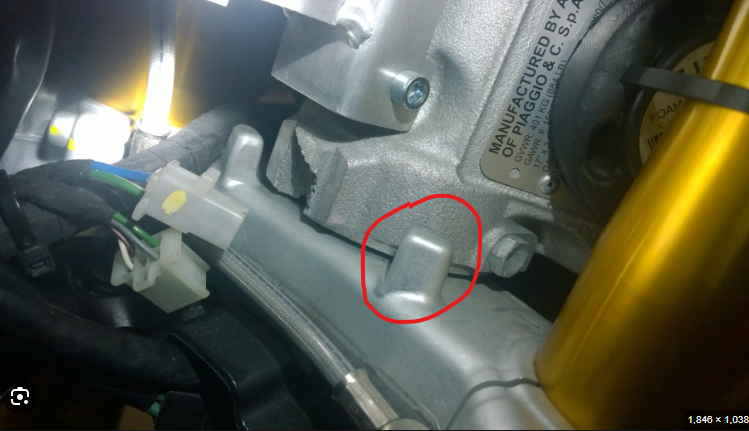

  8. So on the bike there will be metal posts either side on the triple clamp
    IF they're missing you can easily see as the metal will be jagged, crystallisd snapped looking. This means the bike has crashed... Racebikes crash a lot. There is a lock stop on either side of the headstock. Look down the side of the instrument cluster... Note this is not a ducati image, but it's the same on our bikes

  9. No lights fitted at time of test would almost definitely mean it’s had track fairings on but maybe the last owner did some track days and then left them on for the odd road ride. The corrosion you highlighted looks like a build up of cruddy old chain lube, nothing a good clean won’t sort. Checking lock stops is a good call they break off if you look at them wrong on these bikes.

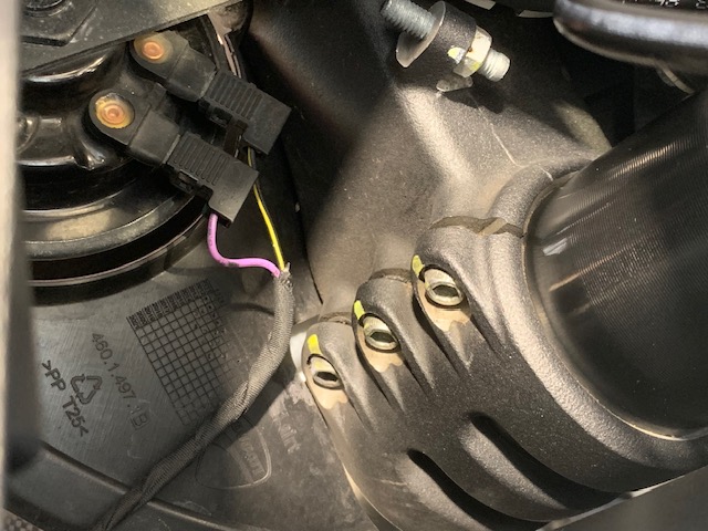

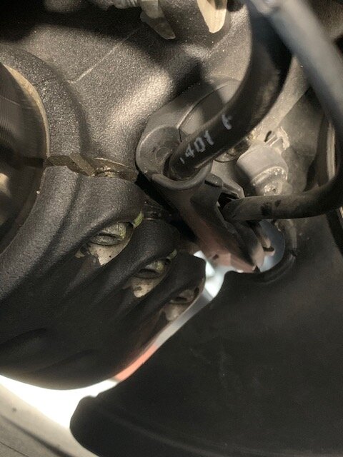

  10. Thank you, I've asked the shop to send me some pictures as it's quite a trip from Manchester. This is what they sent back but that doesn't look right? Thanks again for all the help with this.
  11. Is that the item in question mentioned previously that I should be looking for to check for damage?
  12. Those are fine. It’s the lugs with yellow paint on and adjustable bolts through them.
