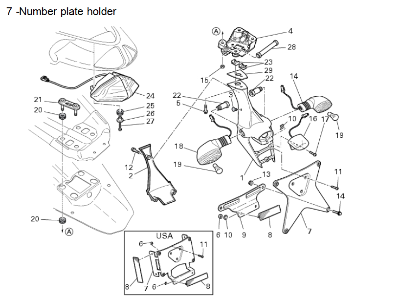

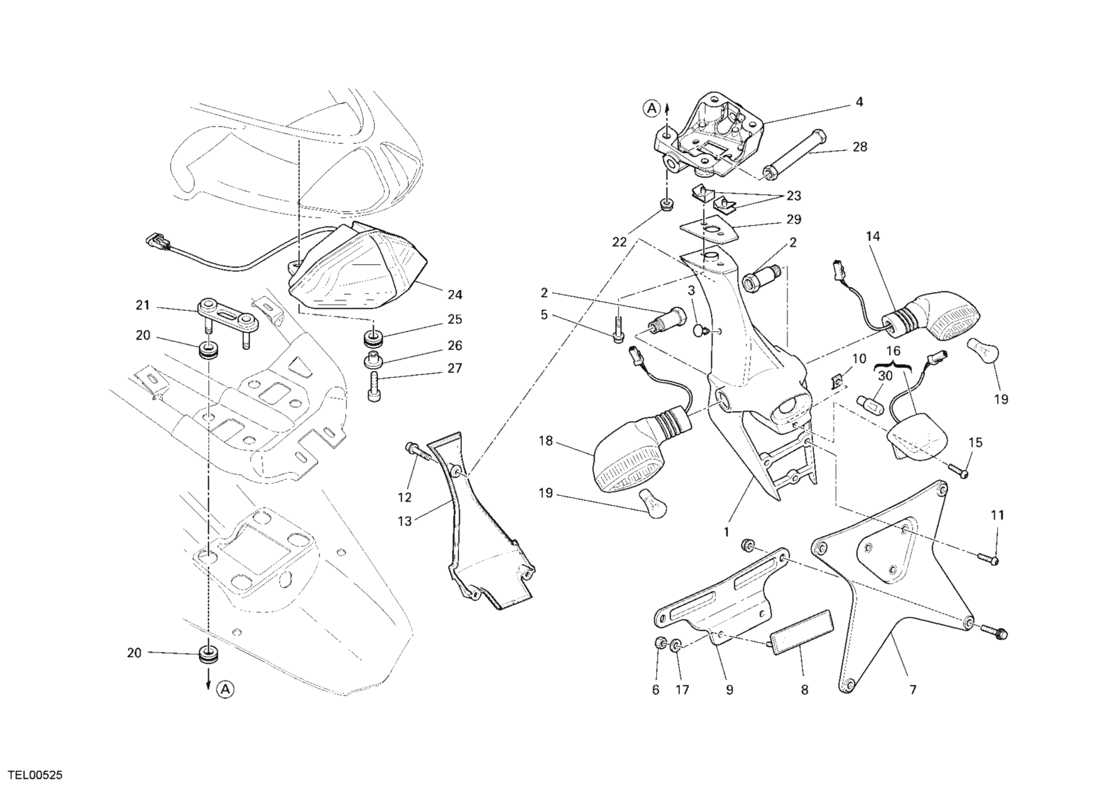

    Remove part (4) by removing 4 x nuts (20)
  4. Remove the cover No. 13 (3 screws)
    Once that is out of the way, undo the electrical connectors and remove the two screws no.5. They're a bit fiddly but you can get them with a long key. emap.png

  8. No 4 doesn’t need to come off.
    Just two bolts no 5 go up through through no 1 and into clip nuts in no 4.
  9. No 4 stays in place as it houses part 28 which the exhaust brackets bolt to.
  10. Do you know what it is. I think you are right. I must have had to refit (4) when I stripped the bike down after getting it. I remember refitting it and to my mind thought I must have been puting it back on after the original owner removed it.

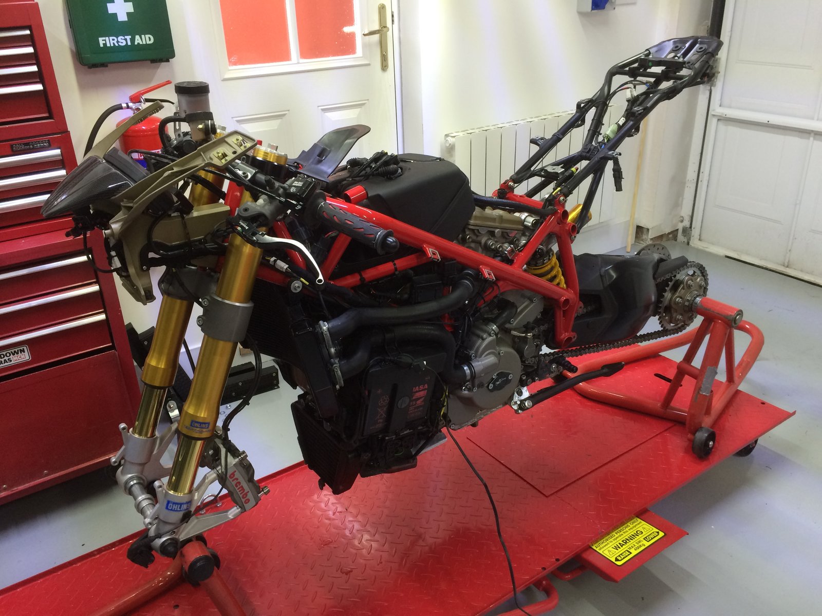

    Sorry chaps. It was a while ago now. :innocent: It was off in this pic (that's my excuse) :)
  11. Confused me then yep. No 4 has the exhaust bands screwed into it. Two screws (5) are all that holds the hanger in place.

  13. What has been said before - just the 2 no. 5 bolts that need to come out.
    I use the Ducati Performance plate hanger, part number 96993308B. Much much easier to swap back and forth between road/track use.
