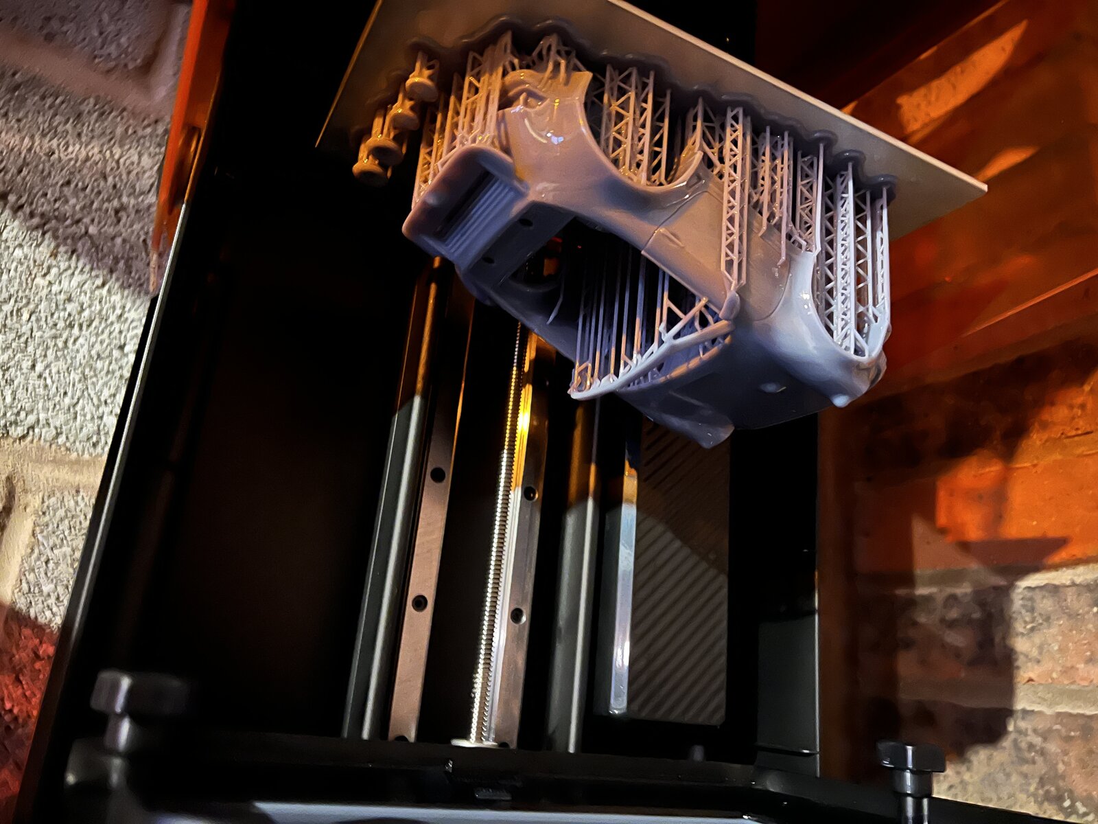

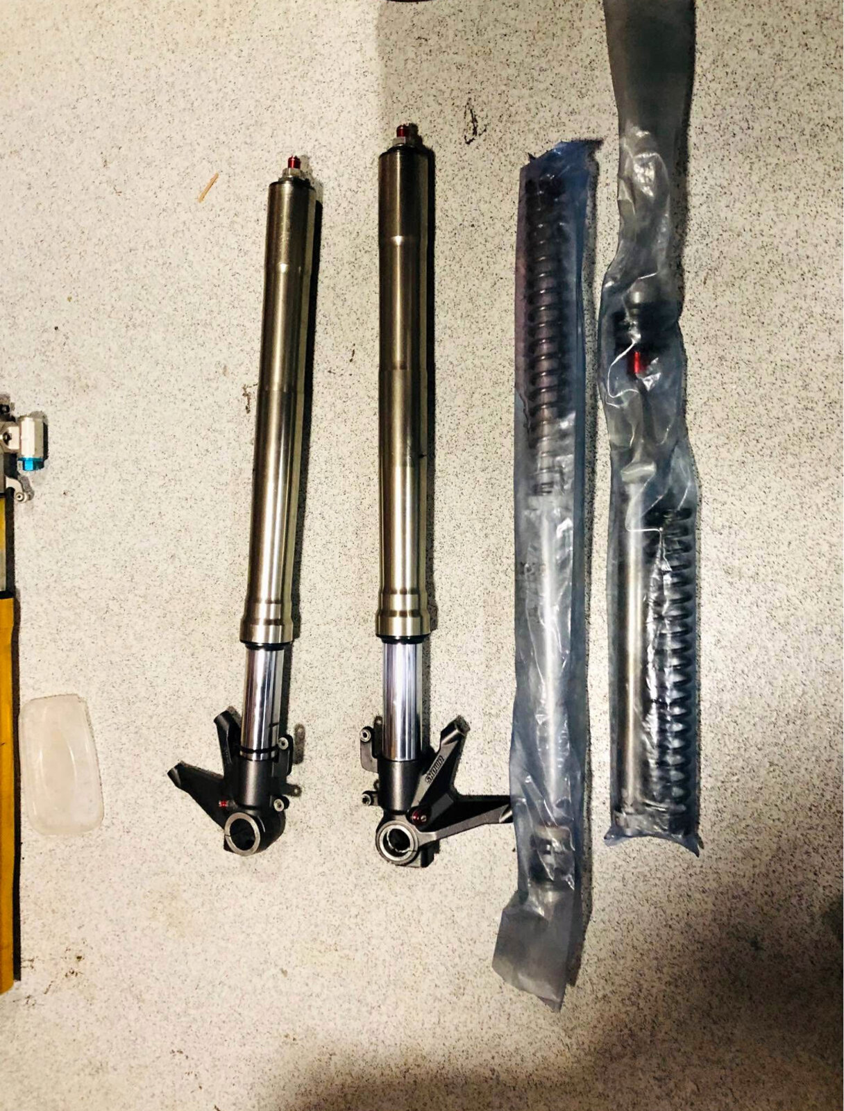

  6. Managed to pickup some 1098 forks for a good price, nice chap that sold them too me, absolute beaut of a 1098! He also does fully insured bike delivery.Aiming to get them fitted and make the radical a roller this weekend. Lil singer 930 off the printer aswell.

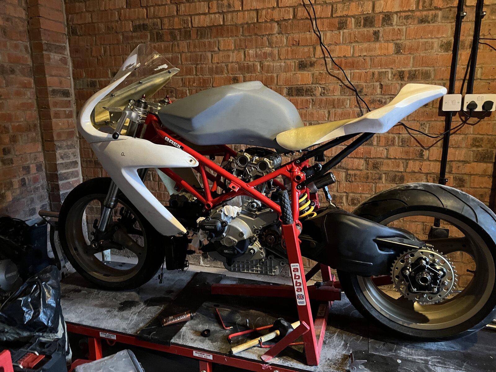

  7. Busy day…

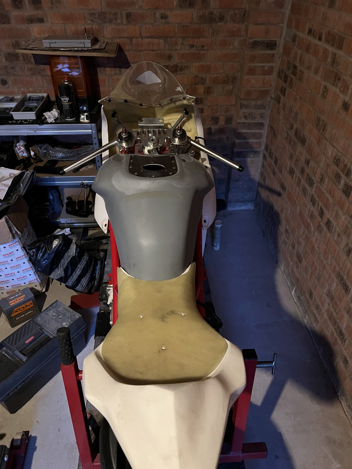

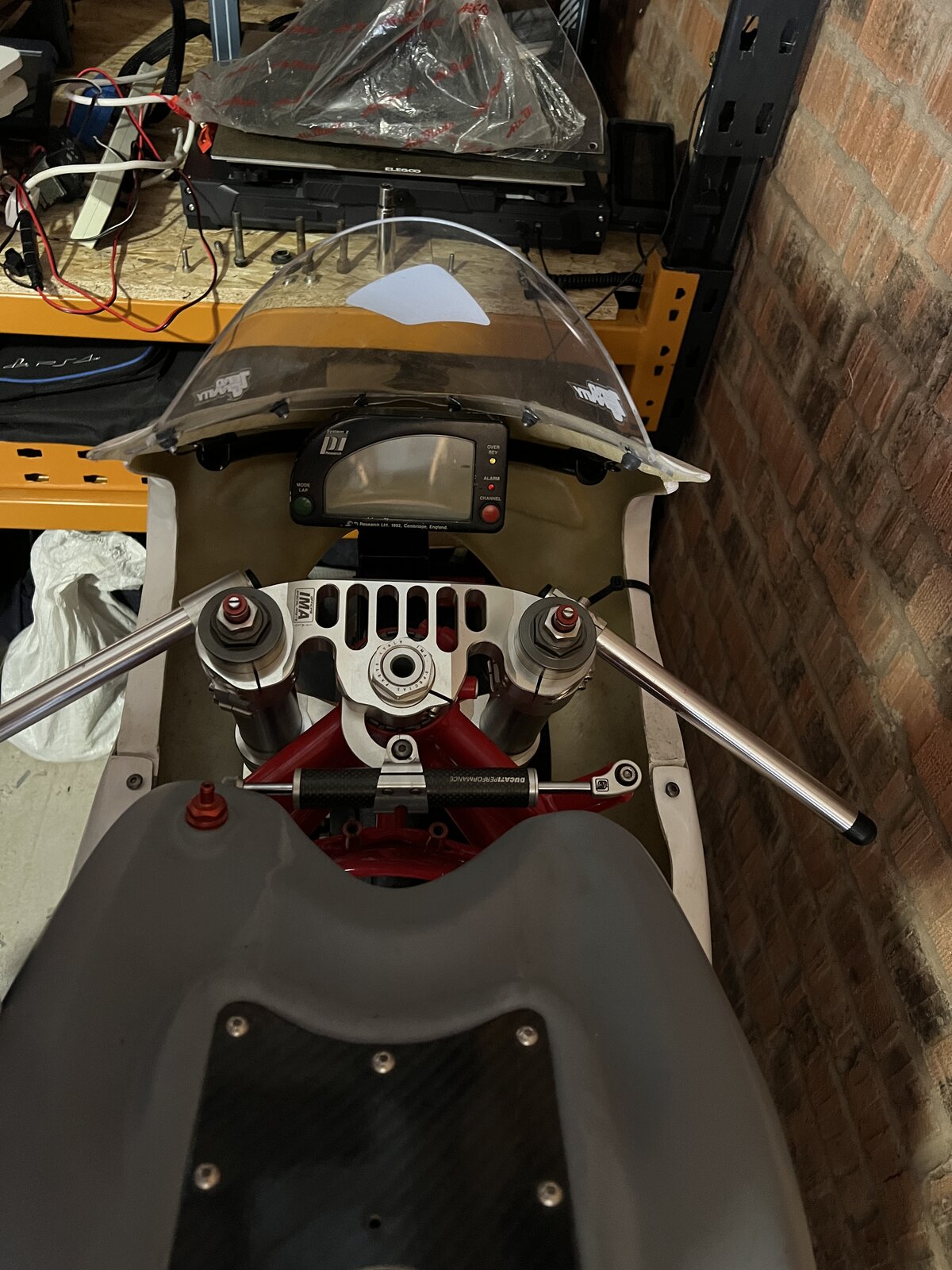

    Radical now back on wheels, 1098 forks now fitted, need to source an axle and spacers to complete. The low 999 fairing stay works great for the radical(managed to pick this up with another set of track fairings last weekend). IMG_9949.jpeg IMG_9952.jpeg

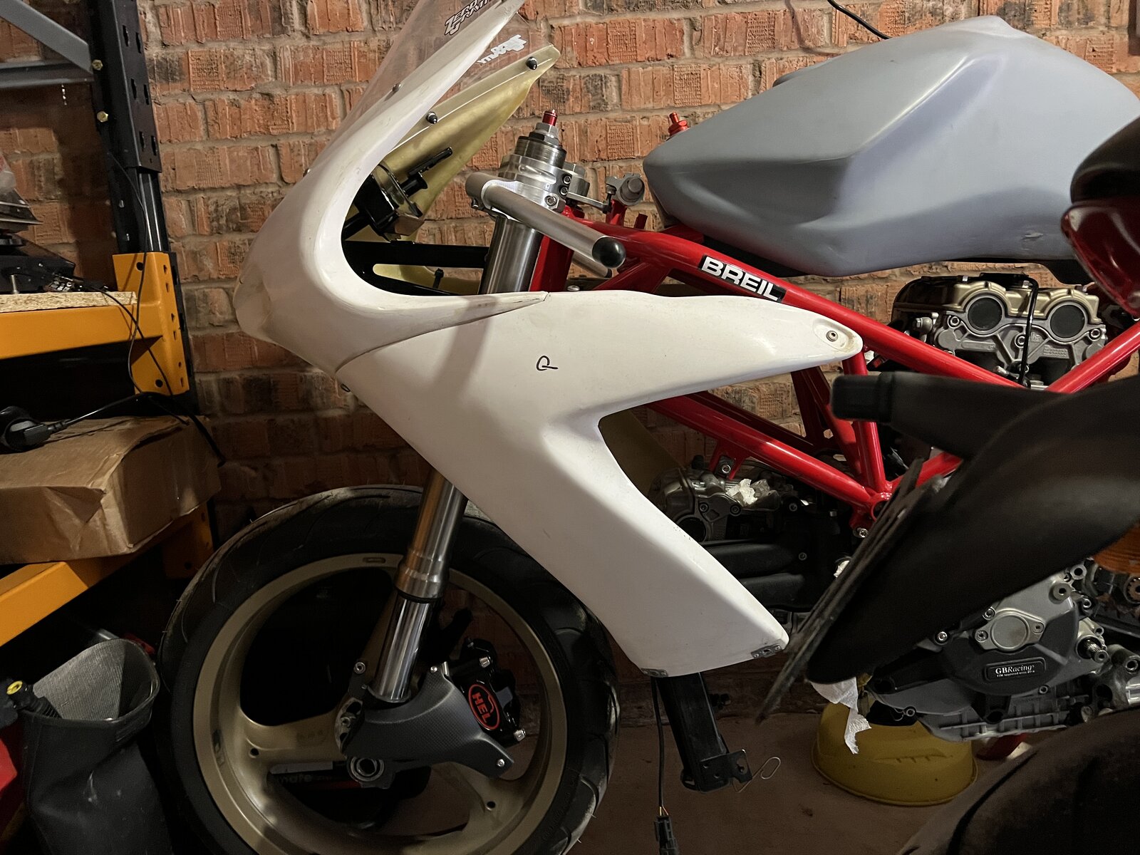

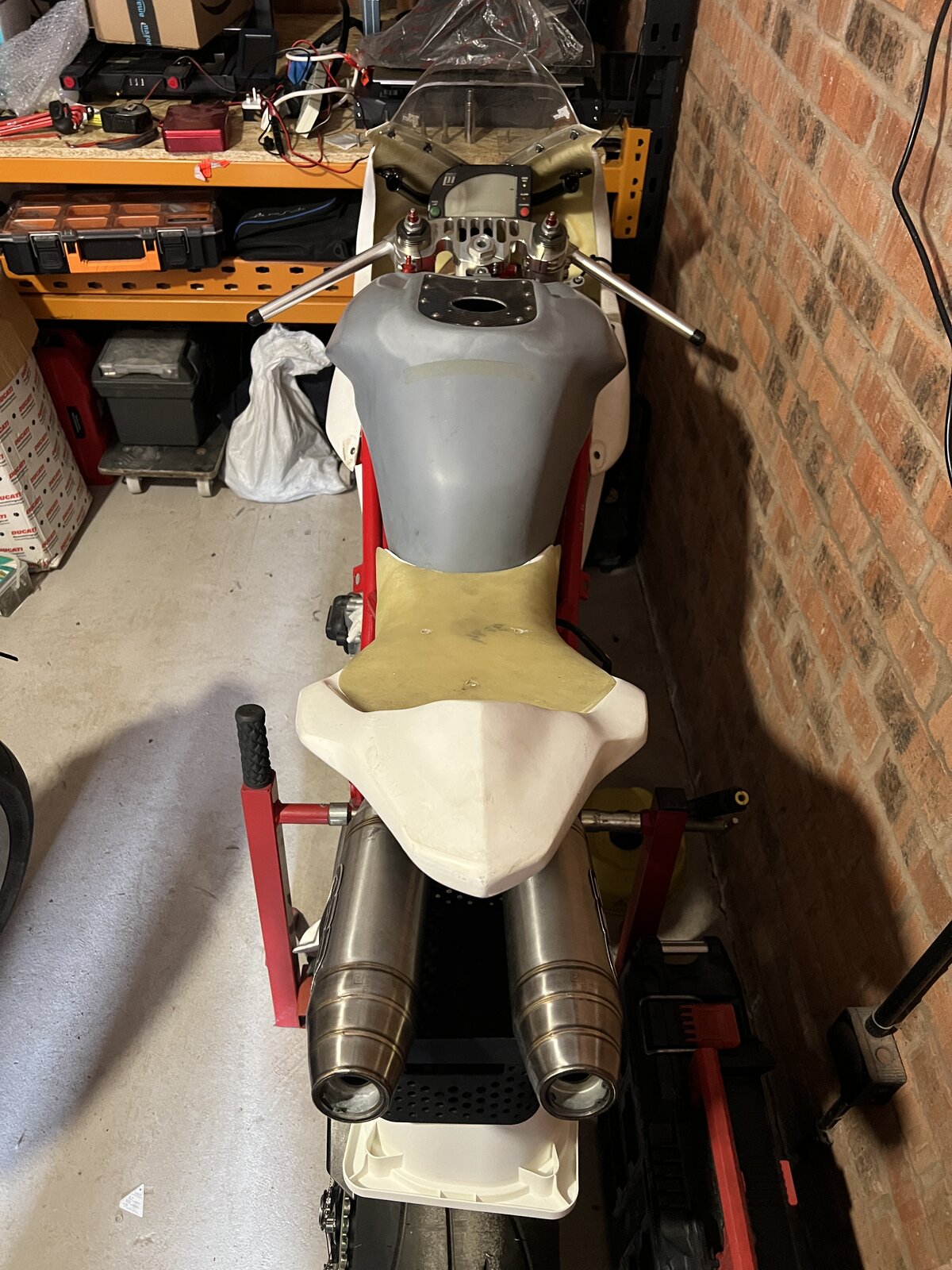

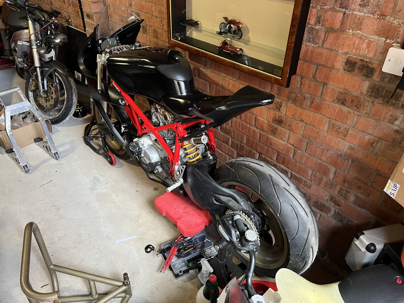

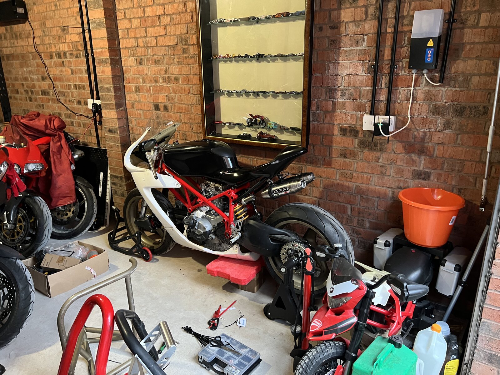

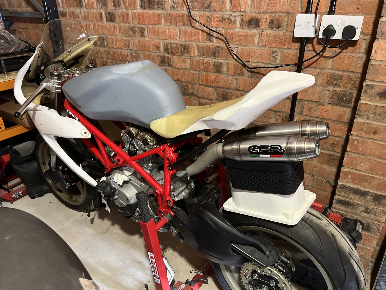

  11. Spent a couple of hours this evening in the garage, mainly sizing things up. I mocked up the position of the exhaust, I’m happy but it leaves me with very little room for the vertical cylinder header. I already knew it would need to be a custom job from the cylinder head, but looks like I need very short link pipe.
    It may also call for a rear shock with a remote res. Next step is to make a new mounting bracket that spaces the exhausts further apart.
    I popped the belly pan back on to check the clearance to the front wheel, it’s close but still clear. Will need to fab some new brackets for the rear mounting points, horizontal header will have to be fitted to get the final clearance distance.

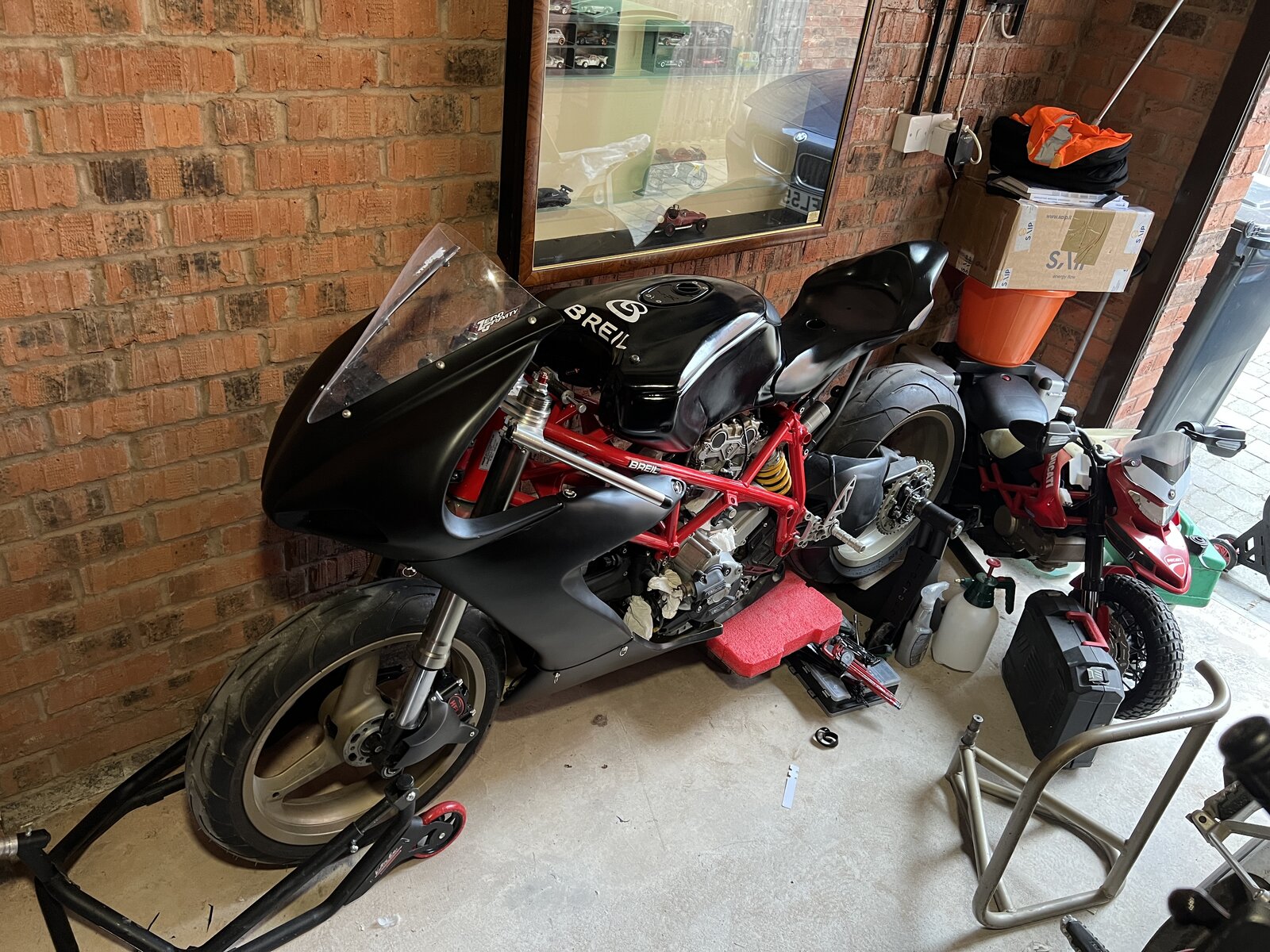

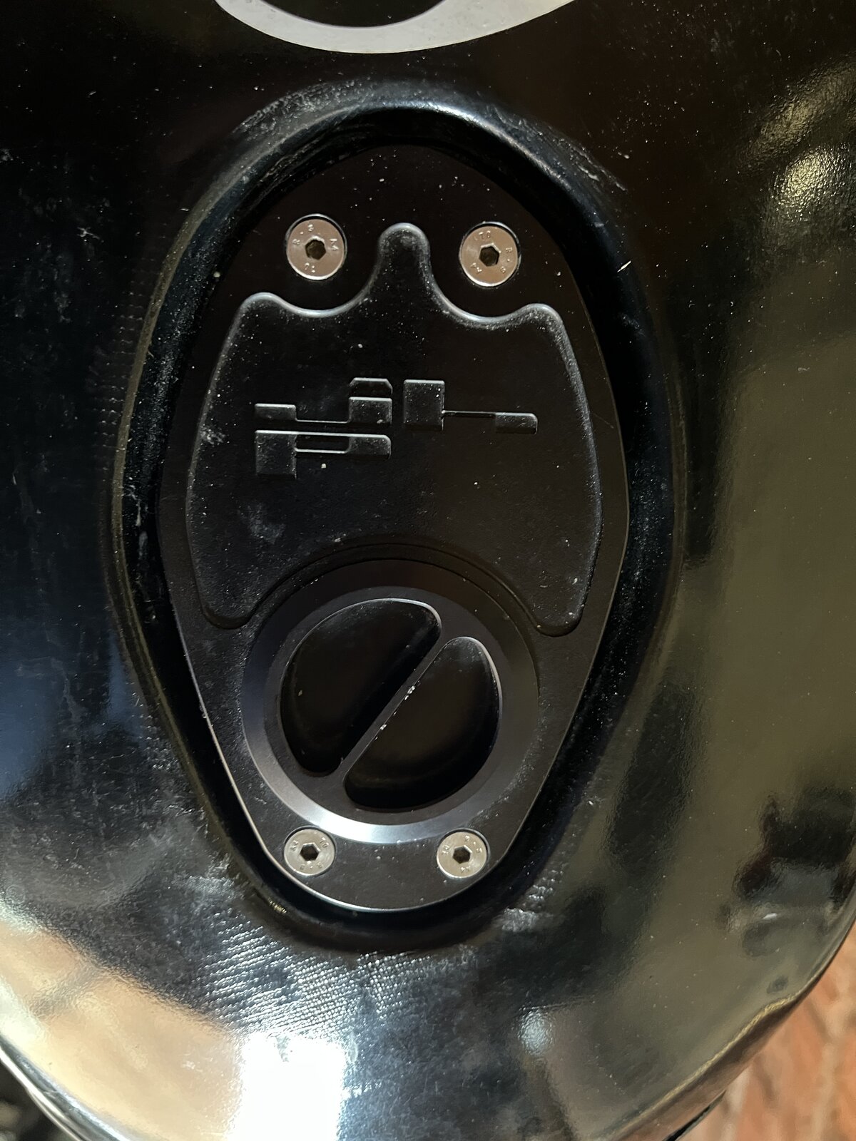

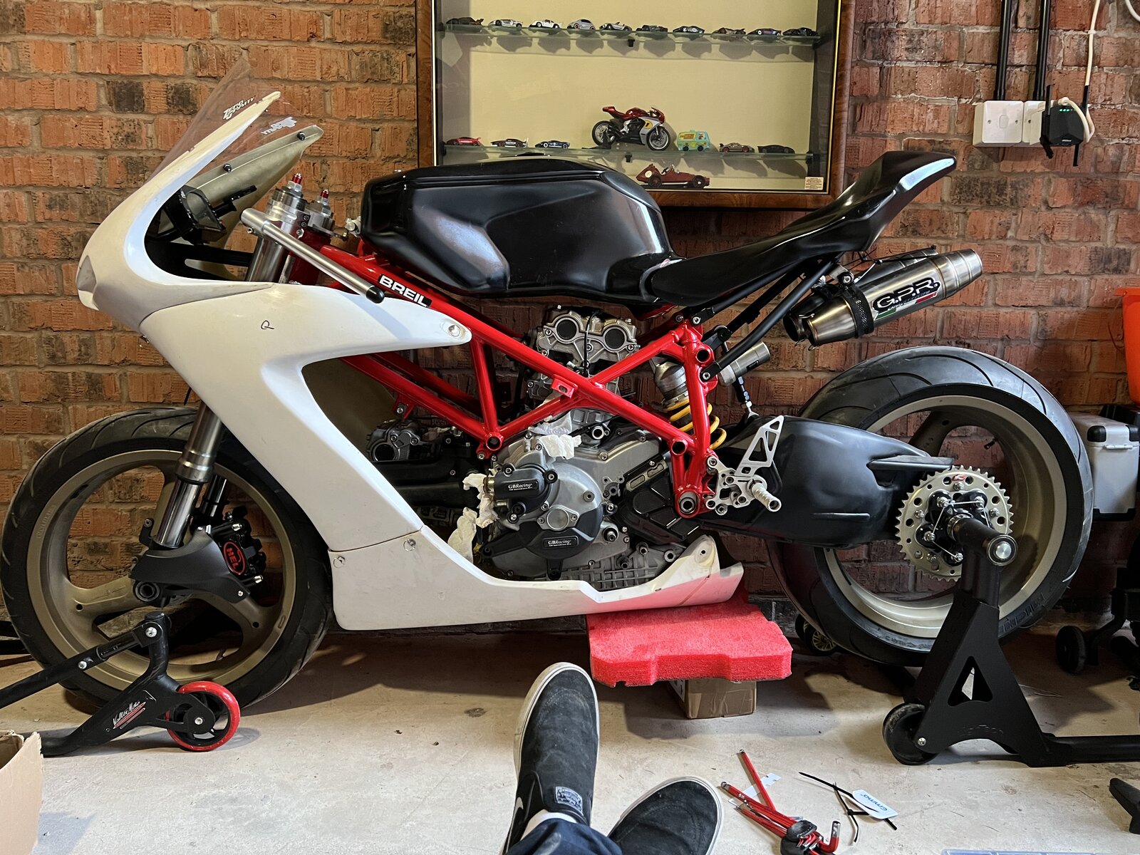

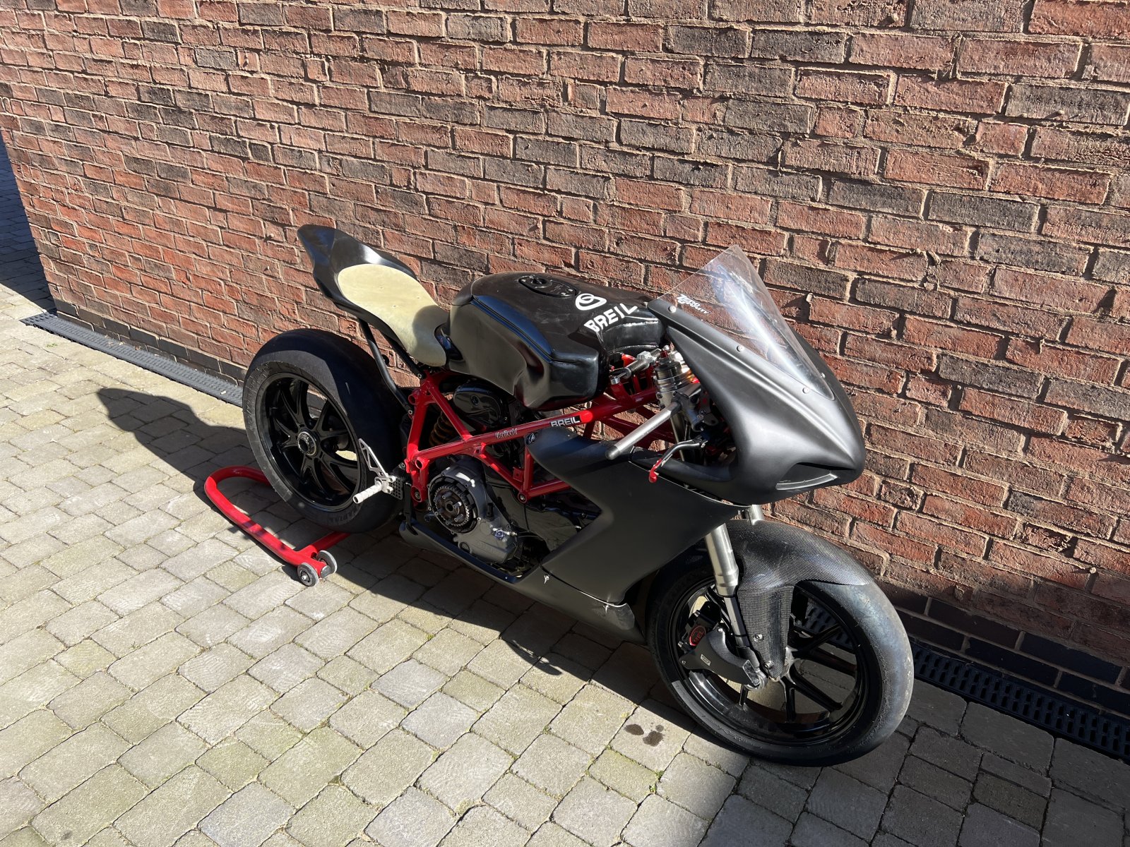

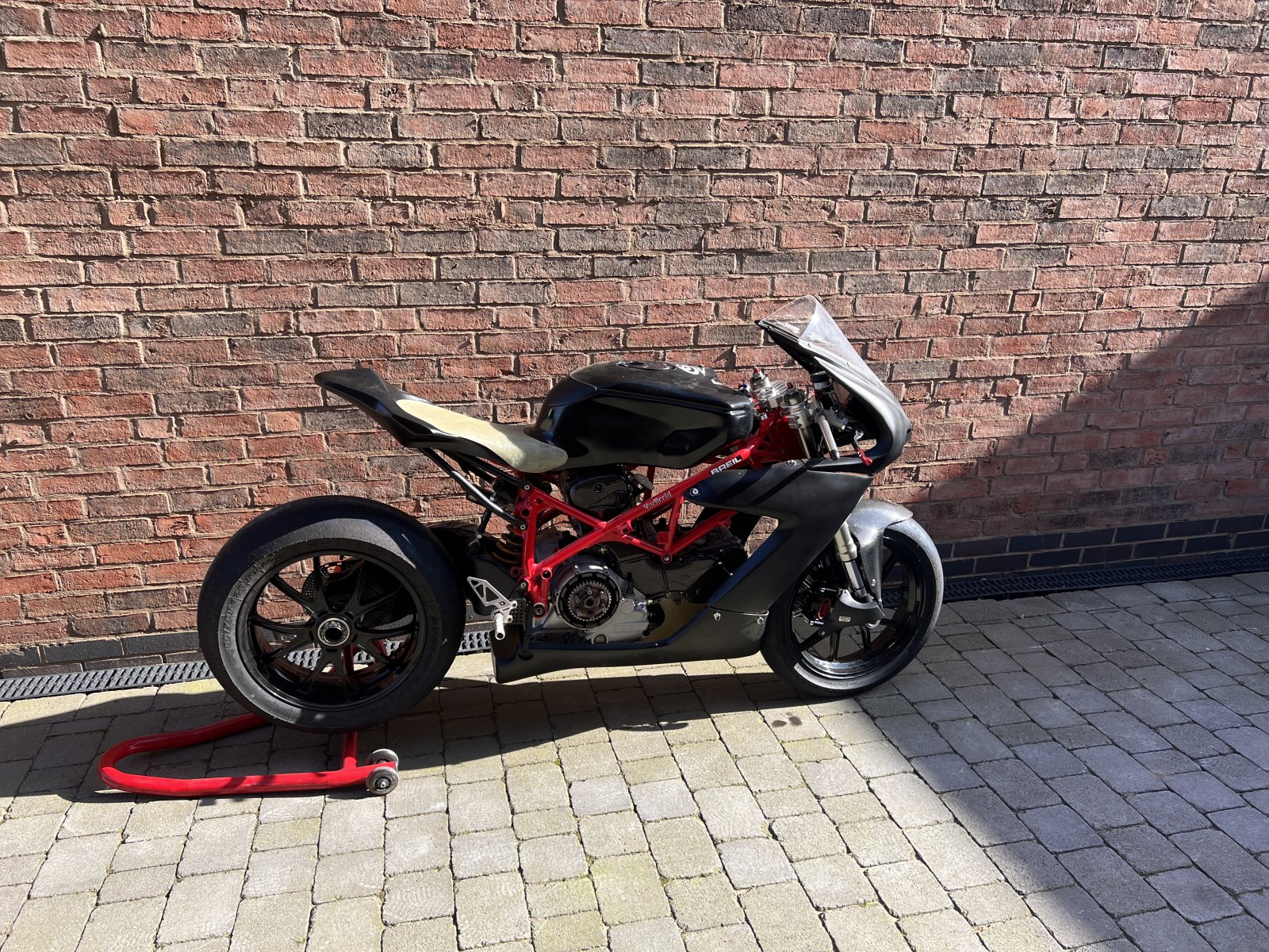

  12. Got bored and painted the Fairings’s with some satin black I had lying around. Also managed to snag a jhp fuel cap for the 749r tank.
    On a separate note, I will not be running the radical tank on the bike, as it’s fibreglass I’m a tad worried about running it on the road( apparently they are not road legal). So the bike will either run the 749r tank or a standard tank, will try both on and see which looks better.
    aiming to get the horizontal cylinder header on this weekend so I can mock up the belly pan rear mounting points.
