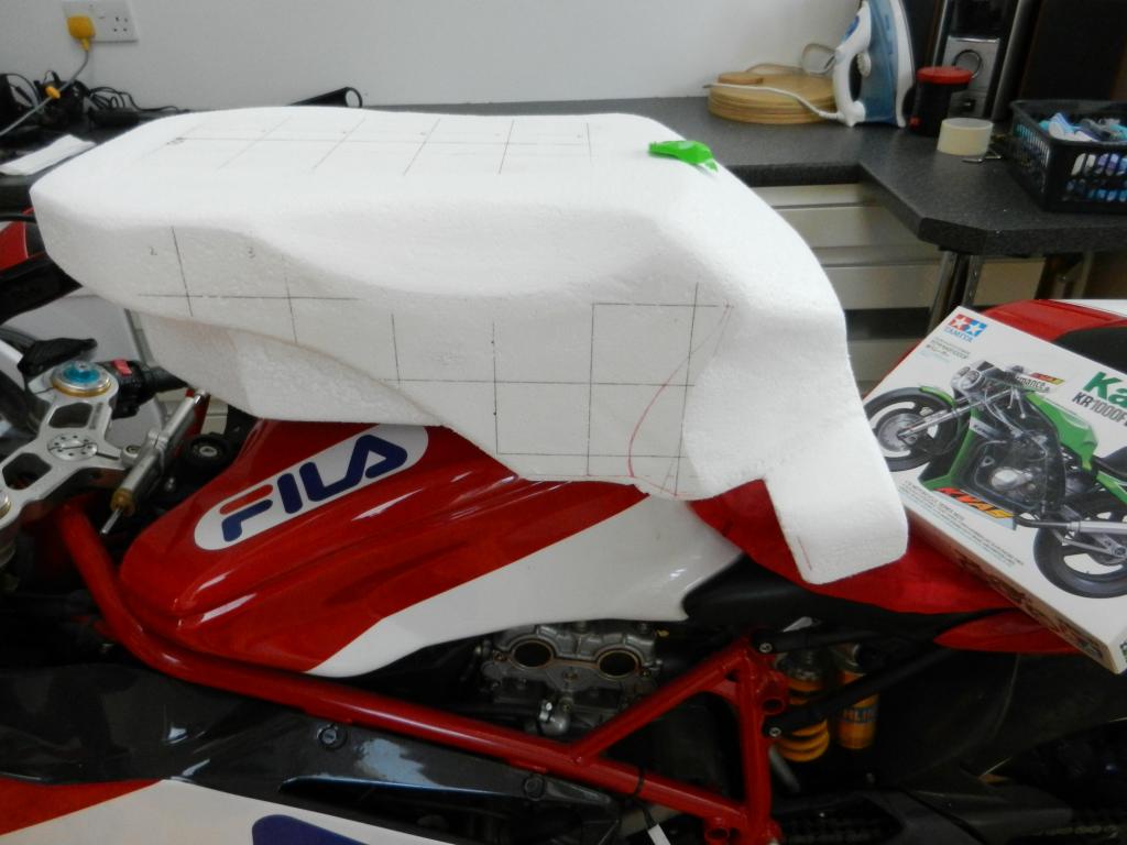

  1. thinking of building one of these, not sure how difficult it will be though so any tips welcome!

  2. Where do I find him, here are the beginnings of the 'former' to shape the tank out of alloy :wink:
    I will have to make most of the parts myself including the frame, mechanical ant-dive etc...

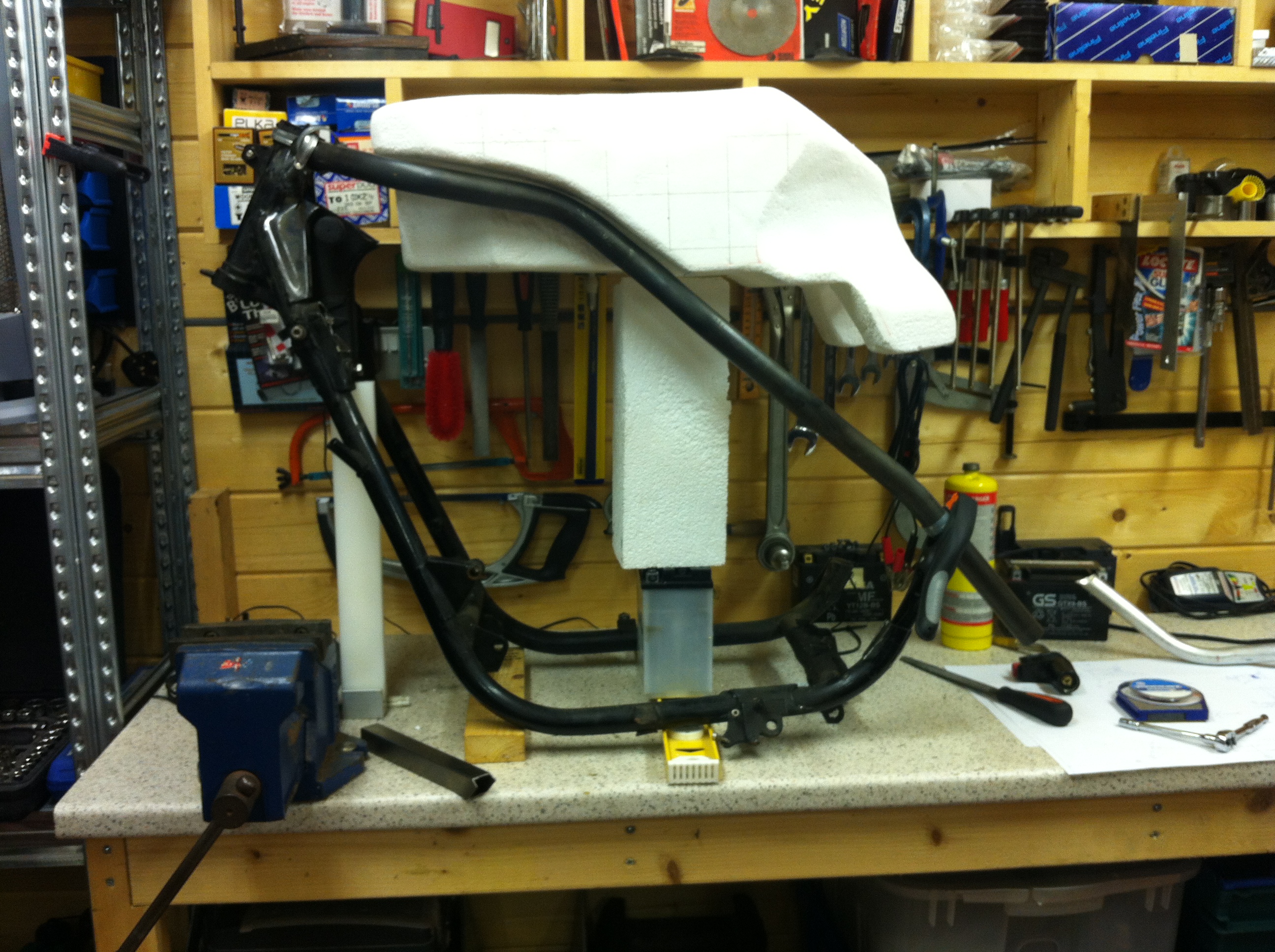

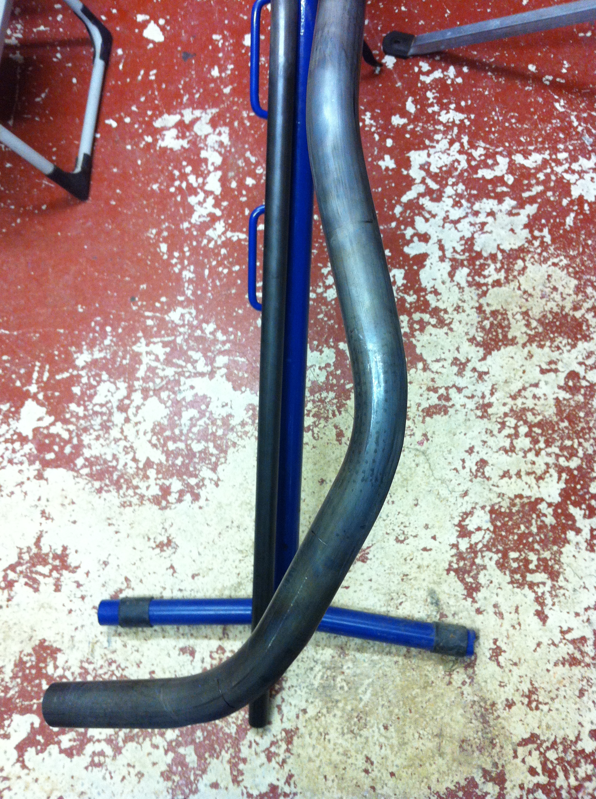

    Having completed some test bends over the weekend I now have an accurate method of bending the T45 seamless tube with minimal tube distortion. Starting on bending the left hand frame tube today but no spare tube now - so it will have to go well :Wideyed:

  9. Some bends - delayed now, need a 48mm HSS Hole Saw before I can do the next bend...

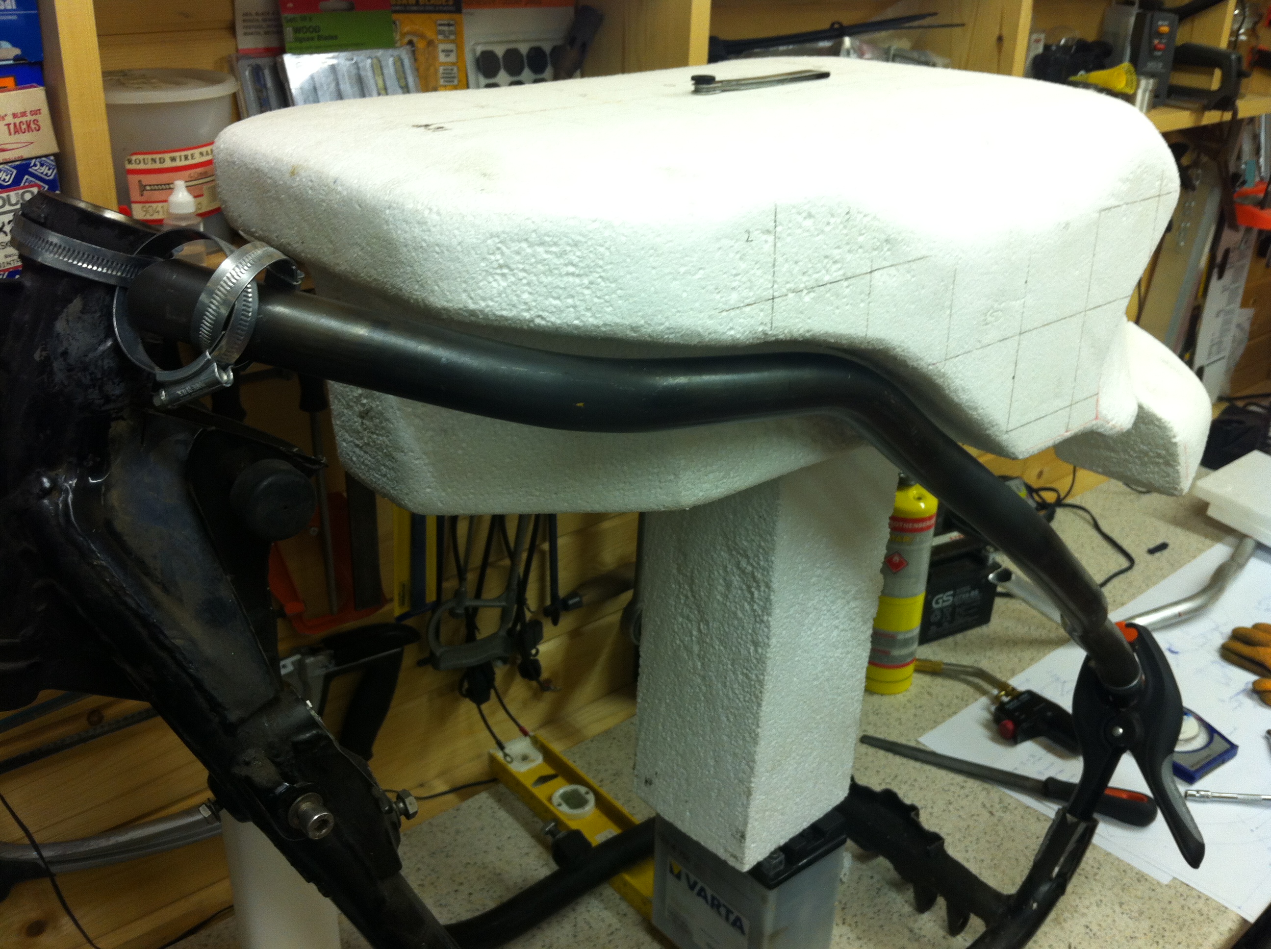

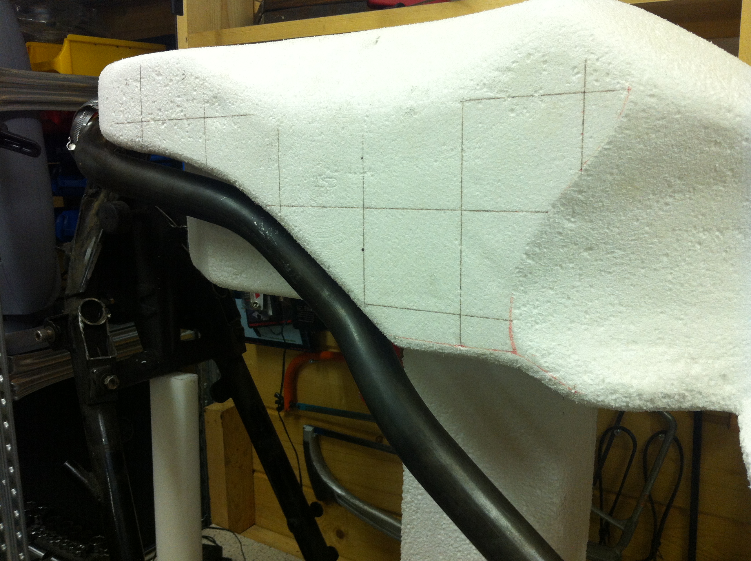

  14. First mock up with the left hand frame tube roughly in position. 8 bends in the one tube took a bit of head scratching to get the geometry correct. Scaling up from the Tamiya Kit with the aid of some good side view pictures from a Japanese magazine. When I get the RH tube done I will need to make a frame jig and do final adjustment to bends and the tank profile to get it visually as close as possible. Biggest job will be grinding of all the brackets on the original frame - not looking forward to that bit!

  19. observations
    1) the foam will get in the way of the engine.
    2) the battery will foul the sump.
    3) forget steroid injections - drink a beer, speed, crystal meth and charlie cocktail and you'll get this finished by the end of the week.
    simples.
    Is the frame all your own work?
    Will you be fabricating the tank?
  20. I will address your comments as I go, thanks!
    The steroid injection will be additional to the alcohol intake...
    Yes, all my own work and I will be fabricating the tank - not done either to this extent before. I will be getting it welded professionally though on the count that I can't weld. I couldn't bend tube until 2 weeks ago but wouldn't trust myself learning to weld properly :Happy:
