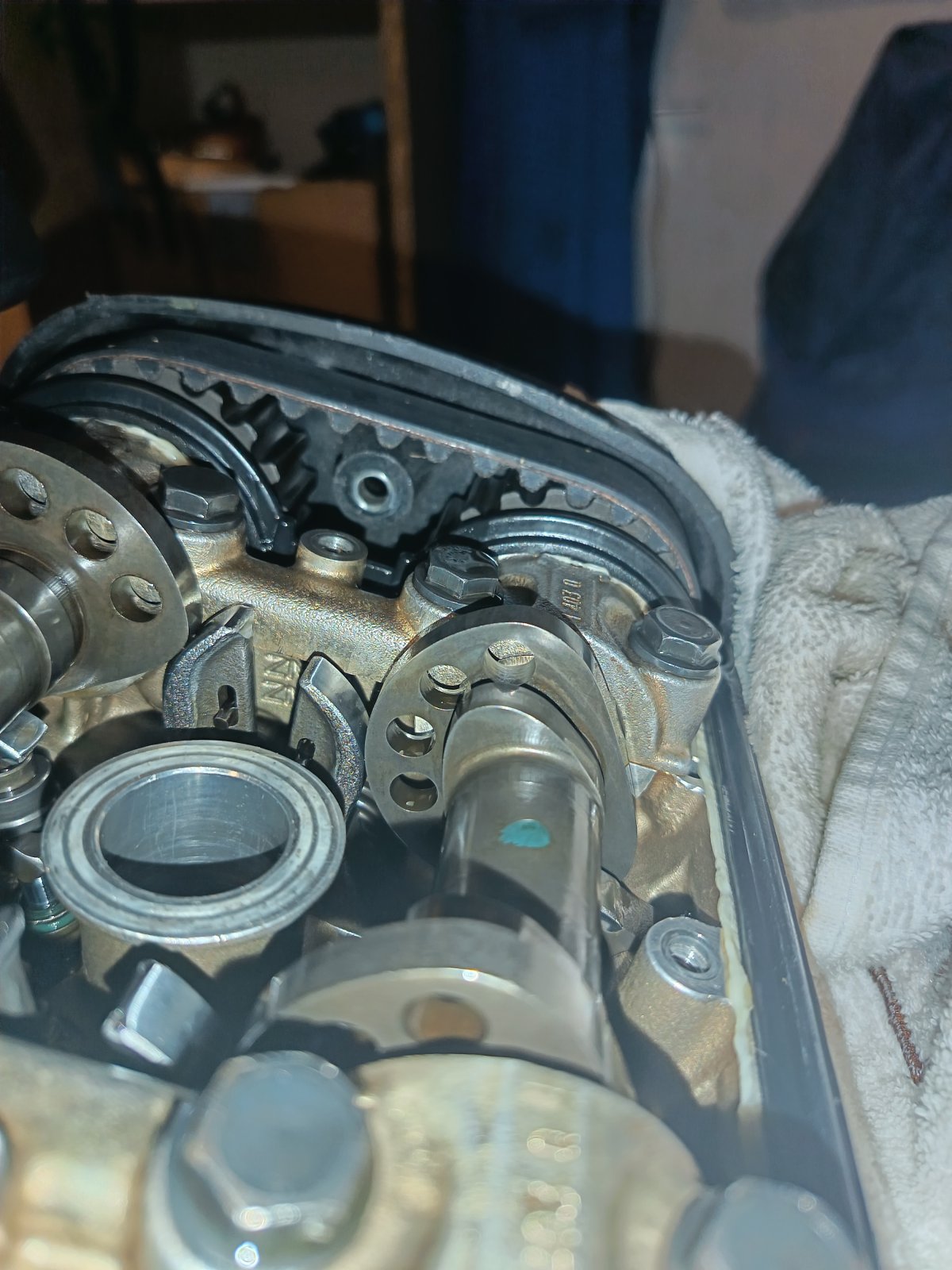

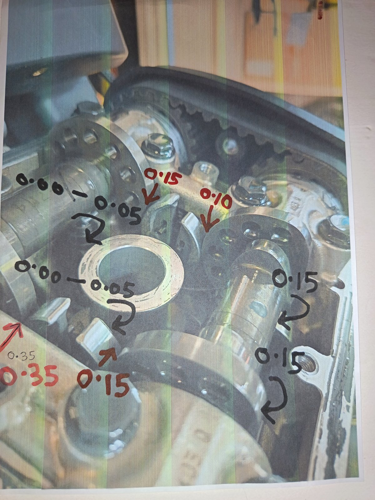

  9. IMG_20260311_184307.jpg IMG_20260129_171144.jpg just removed the cover plate and checked the gaps on the rear cylinderhead. first time i have done this but i am pretty sure that the TDC has been marked correctly according to my service manual, photo attached. rather than try to explain the gaps at the 8 locations i have taken a photo and written the gaps sizes. please note i did move the green dot into the TDC position. so it looks like 3 locations are out of spec. cannot get enough purchase with a 0.05 feeler gauge on the lower ones so i am presuming that they are steel tight and this is the problem when the engine is hot.
  10. Sounds like the valves are tight, but I don’t think it’s the problem you’re looking for. As it’s not engaging the starter. Sounds like a bad earth to me. Is the starter solenoid clicking?
