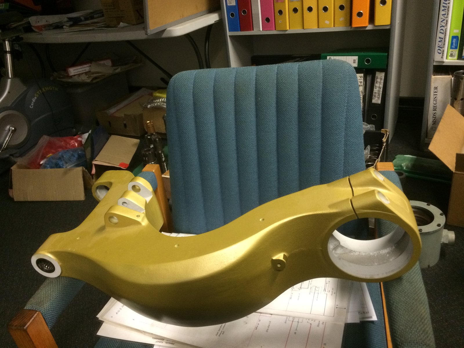

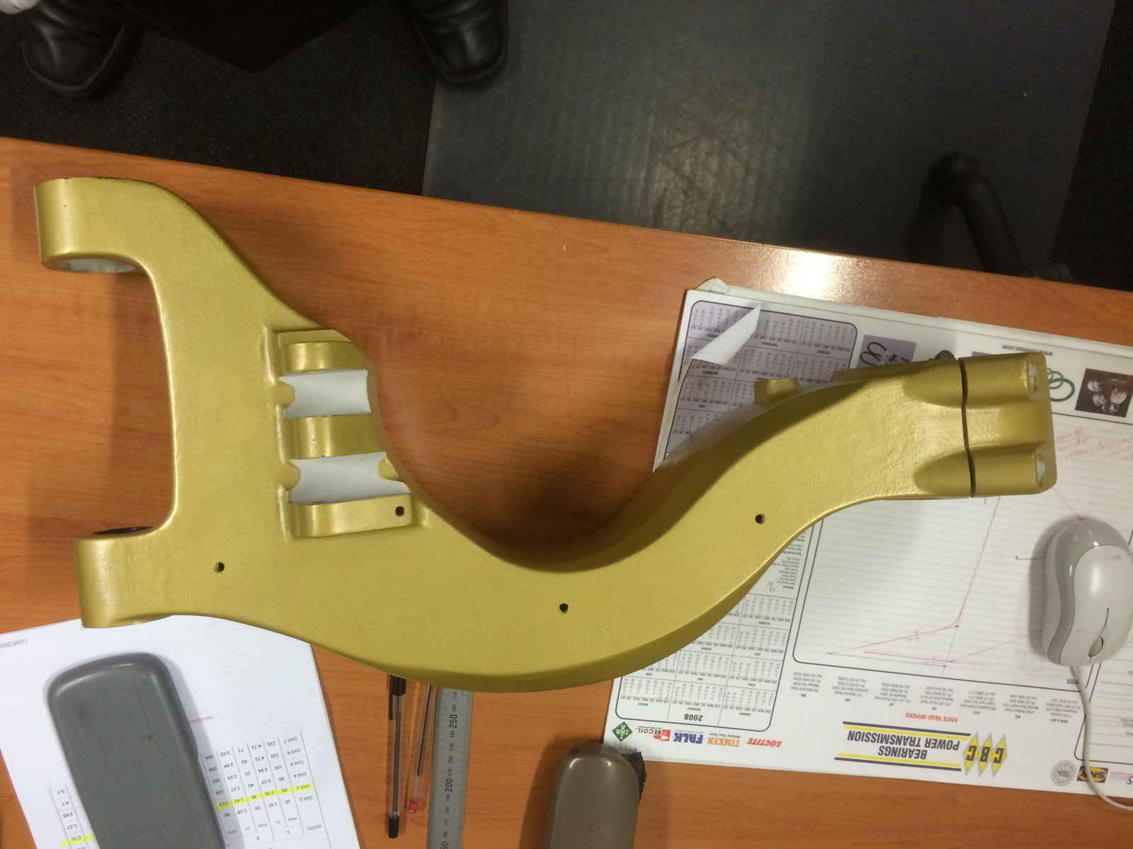

  8. I have some RS/AMA swing-arms MAGNESIUM, New, Painted, better made
    longer, made in USA, better made and sealed, (important) for road use, also have a Imola Aluminium factory arm from a F02, use the corse magnesium eccentric and RS axle, I think can be done
    but not a hundred percent sure the wheel interface/ axle, drive peg pitch circle is the same as 998RS or F02 parts and 1098 but suspect the same
    Would sell the AMA swing arm, but you need exccentric and axle to fit the large axle Corse type wheel sprocket drive flange has larger spline as well
  9. Big axle 5/10 spoke race magnesium wheels are largely 16.5" but 17" wheel made for road bikes were sold through DP, along with magnesium swing arms, big axle magnesium eccentrics and, sprocket drive flanges with bigger splines to suit the DP/Corse big axles The AMA swing arm are better cast, finished, sealed and painted than the euro made arms and seem like more corrosion resistant, (magnesium)
    The race arms are a little bit longer, and look like the dimensions of the parts fitted to single side swing-arm models after the 999 when the axle sizes increased after the 998 road bikes;
    look to be the same size as 998RS and F race parts

  17. AMA Swing-arm, notice the casting precision, and the paint, water-proof? (wont corrode like some i have seen marchensini)
    think 1098 axle might fit the 998 Corse swing arm and the 848 the 998 standard swing arm, the arm above is the same as a 998RS so got big eccentric for big axle
