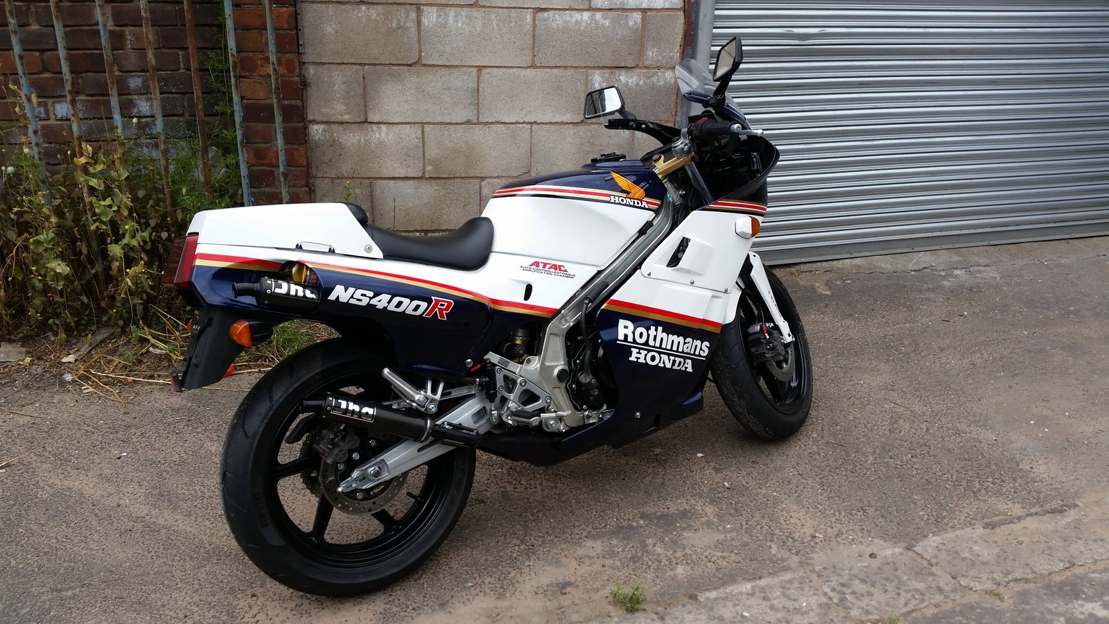

  5. Here is the one I restored. Fitted cbr600 front and cbr250rr rear wheel, ohlins remote adjust/reservoir damper, JHA exhausts. Was a lovely bike. Sold
    It and started restoring my 500gamma
