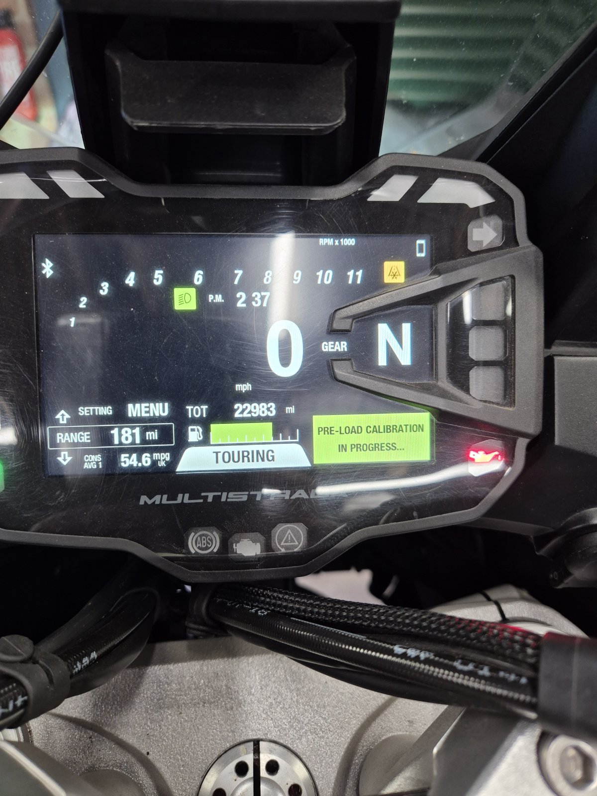

    Anyway, have ended up with a possible bigger issue.
    Connected the OBD Star up to my 1260 Enduro and reset the annual service light, which was easy.
    Then thought I'd have a look at what codes were stored as I've no idea when they were last cleared, possibly over a year ago when Snells did a Desmo service etc for the previous owner.
    There were loads, mainly about the ABS, and steering head sensor, but of course with no history the best thing to do is clear them down and see what pops up when read after a ride.
    And that's where I'm now stuck.
    I turned the ignition off, disconnected the OBDStar then turned the ignition back on to start the bike up.
    A pump started to run loudly and this appeared on the screen which I've not seen before:
    It disappeared and the after a few seconds the pump turned off too.
    But now the bike won't start, it fires and cuts out again.
    I plugged the OBDStar back in and all the ABS and steering head sensor codes etc are back, but nothing else by the look of it.
    As it's freezing cold I've plugged the battery charger back in and will try again when it's fully charged as it did appear to labour a little to turn over.
    Could I have done anything clearing the codes to cause the issue?

  19. From a quick google it probably is the battery rather than anything I've done.
    It is significantly colder than it has been.
    A new yusa is only £40 with my Halfords discount card so I'll pick one up in the morning.
