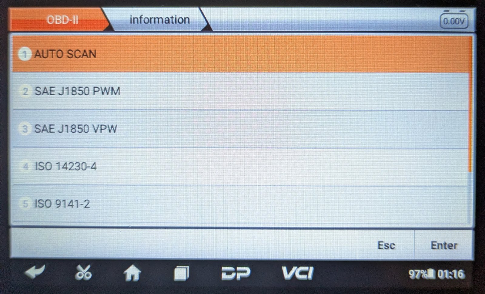

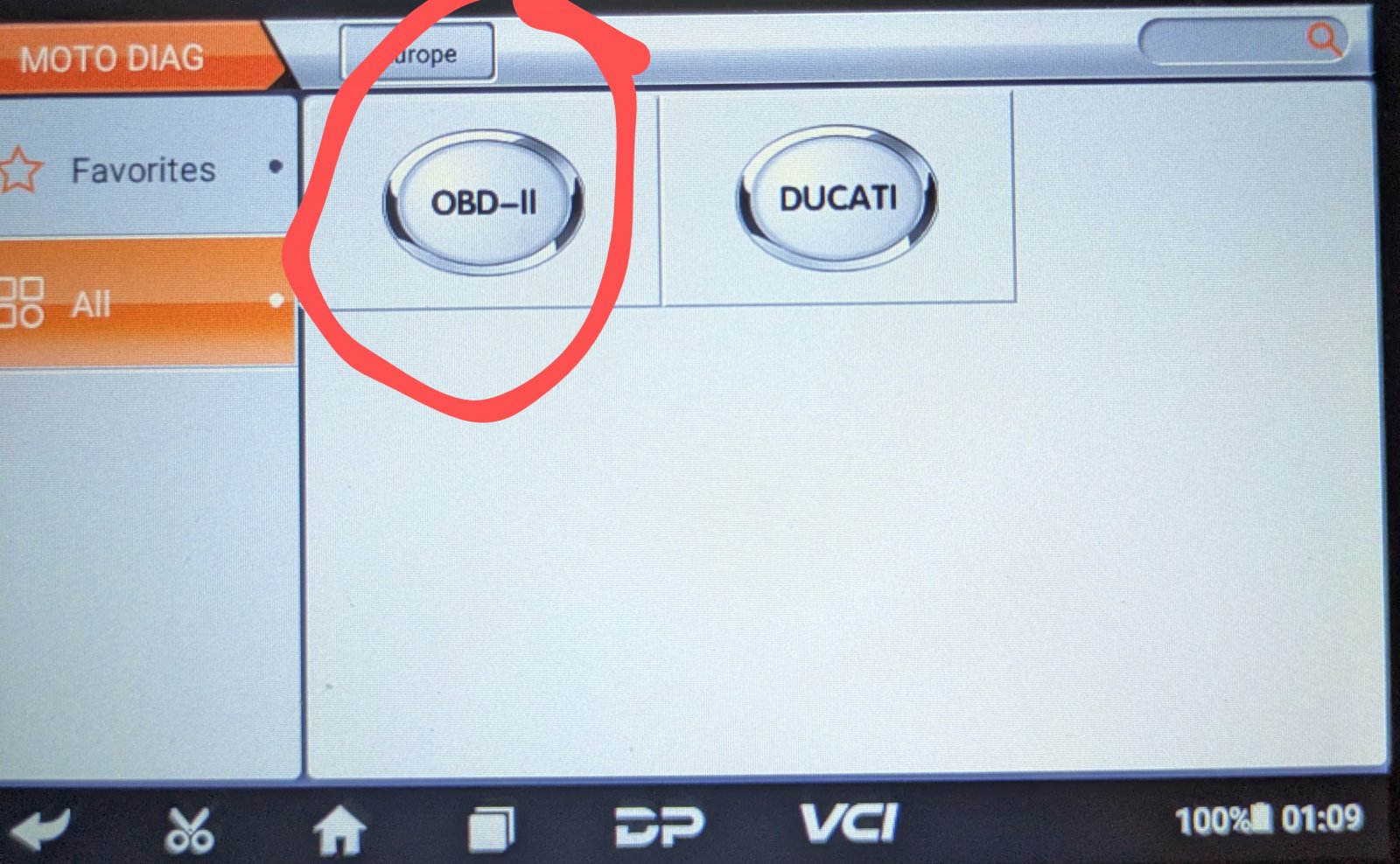

  1. Thanks @Keith_P I do get the generic OBD-II option but from what I've read it will only give very basic generic code reading functions, nothing brand specific or give me the ability to turn off a service notification or EML warning.
    My generic reader is pretty good and will at least turn the EML warning off on most vehicles, but not the service notification.
  2. I've cleared codes on both vehicles. On the Prius I got 100% access and just basic EML on the VW. Better than nothing tho :)
  3. I'm certainly going to give it a go and see what access I do have.:upyeah:

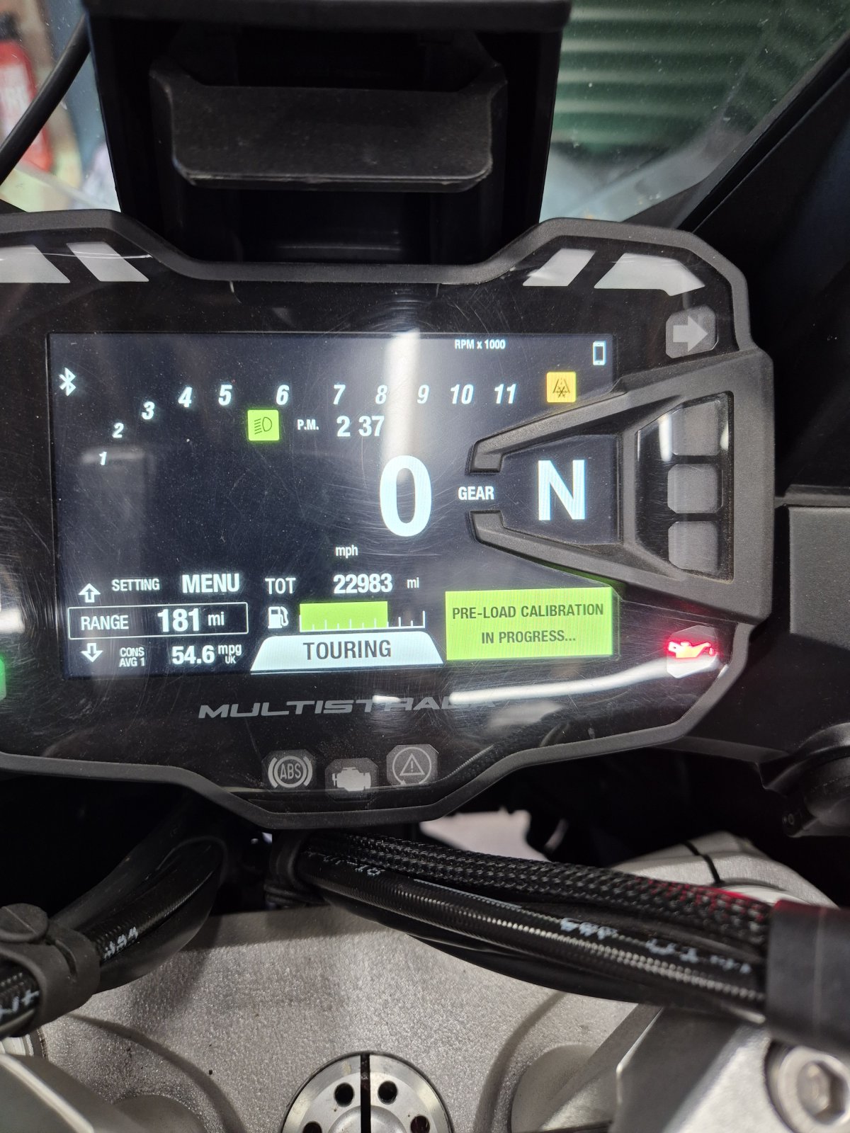

  4. Caused by low/no voltage from the battery.
    The ‘pump’ you heard was, most likely, the rear shock running running through its range of movement to establish its equilibrium. It happens every time the battery is disconnected/reconnected or if the voltage drops too low it interprets it as a disconnection of the battery.
    With a bit of luck you may find the other error codes are also due to a low battery voltage as the various systems connected via the canbus, of which the ABS is one, don’t like it when the voltage drops too low.

  7. Brought a new battery this morning and charged it until my charger said it was ready to go.
    Swapped it for the old battery and when I turned the ignition on the bike went through it's Pre-Load calibration again.
    Pressed the starter and despite turning over quicker than it's ever done in my ownership it still won't start.
